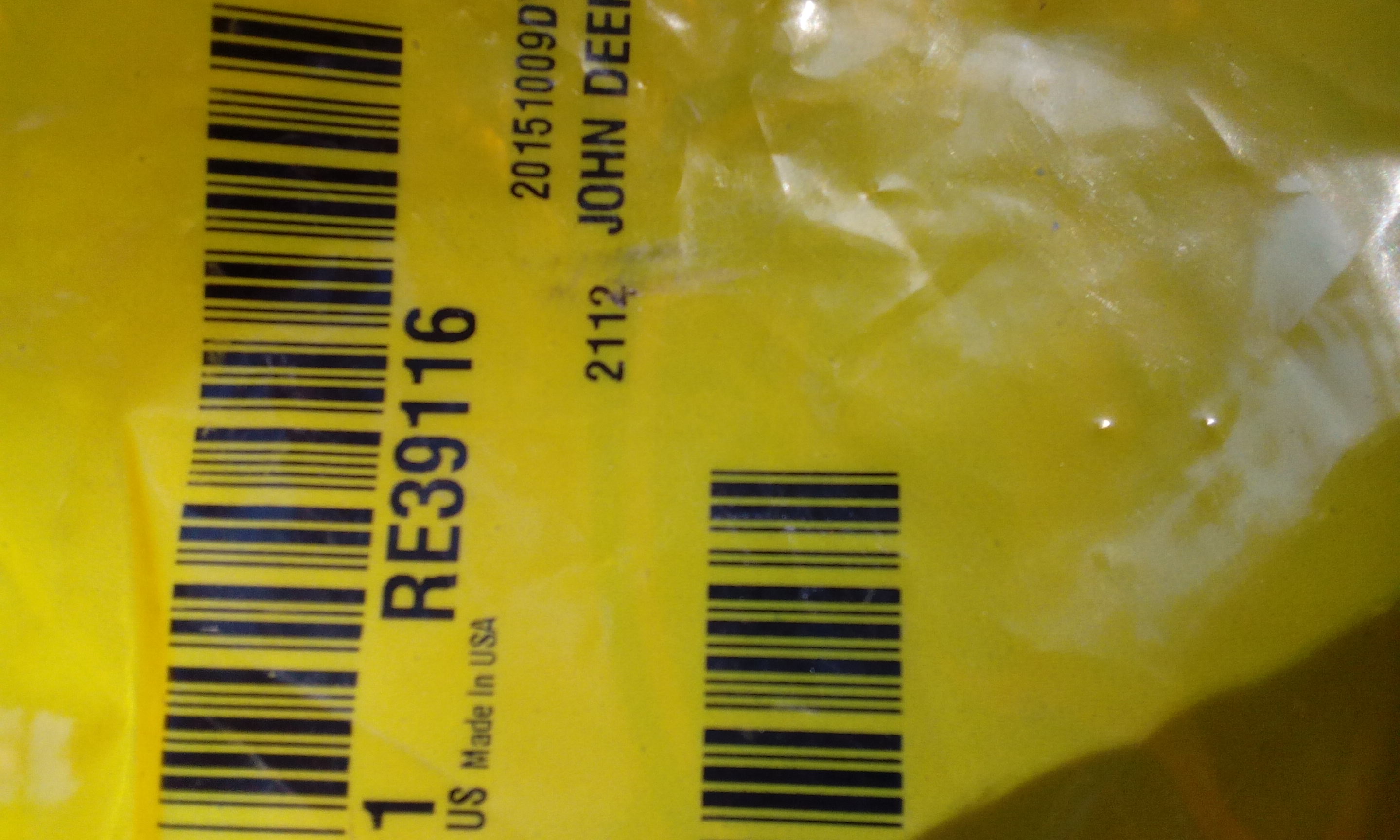

Not starting and blows a fuse when in neutral
Found the problem at the neutralswitch.
I had to get a new switch , but that switch was to long. Had to cut the plastic off the new switch and solder the old switch s wires to the new switch. 1477663582846.jpg1477663597144.jpg
/ JD 5425N
#2
This switch is under the seat on the inside of the gearselectorhousing that needs to be removed to do the replacement
/ JD 5425N #3
Sounds like they sold you the wrong switch, but you made it work, so all is well.
