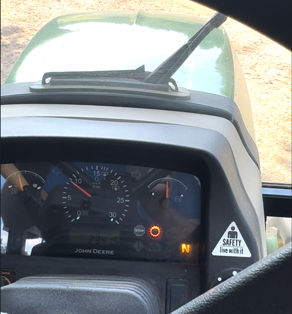

We have a 2011 John Deere 5065M 5 cyl. turbo cab model and it randomly stops moving. The red ring gear illuminates on the dash and it will not move until you put it in Park and neutralize the Power Reverser, turn off the engine and restart. It's very random and it has been in the local JD dealership shop twice. It's only been back a few weeks and it's doing it again. The Clutch Position Sensor, basically a potentiometer, has been changed twice and this last time they also changed the Neutral Switch on top of the transmission. Dealer says it's not throwing error codes and they can't get it to duplicate it of course. It’s a 16F/16R transmission. Tractor has about 2400 hours on it. It's already done it 6 times since coming back from the shop this last time. Son was backing up to hook up to a drag harrow this afternoon and it red ringed on him twice.

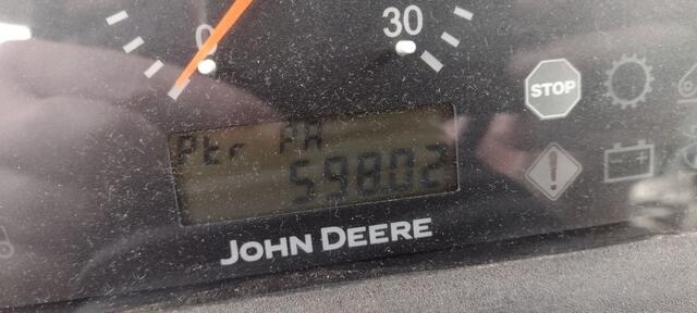

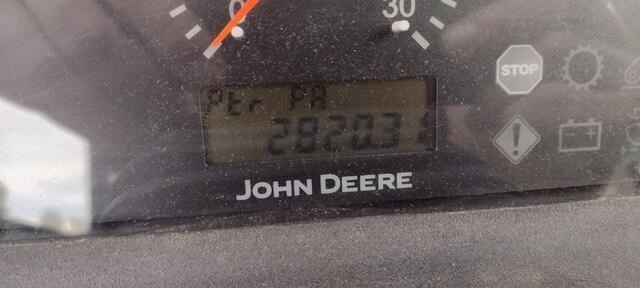

A mobile independent equipment tech was here last week on a overheating Kubota issue so while he was here we had him take a look at it. He actually pulled up two codes on the little display but could not replicate the issue at hand. I believe he said he thinks it's either another bad clutch position sensor or the forward/reverse solenoid. Amazing that he was able to pull those codes yet JD has been telling us all along that it was not throwing codes. Pictures below.

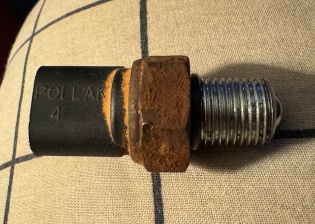

"As a dealer tech with many years experience, I can say the intermittent issues are the worst to diagnose, especially when it doesn't leave a clue behind with a code. When that happens, it is absolute guesswork if nothing is visually obvious. There is a bulletin/solution that talks about the neutral switch on top of the transmission that can cause this issue. Some 5M's had 2 different switches on top".
"Do you know which one they changed?"
I don't. I'm holding it in my hand but there's no numbers on it at all. Just the brand name Pollak 4. Picture below.

Here's the two codes he pulled up:
