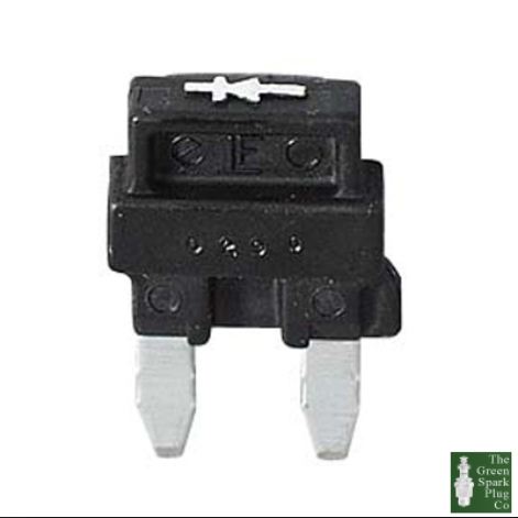

Some machines have a Blocking Diode on the charging circuit in the fuse box , Positrac have them to name one . It looks a bit like a fuse and it can only go in one way . If you are unaware , it is easy to pull it out thinking it is a fuse , look at it and then put it back in the wrong way around . If it is in backwards the battery WILL NOT charge and as it is in there to stop a reverse flow of current , the battery will run down via the alternator winding's .
It may look like this .
