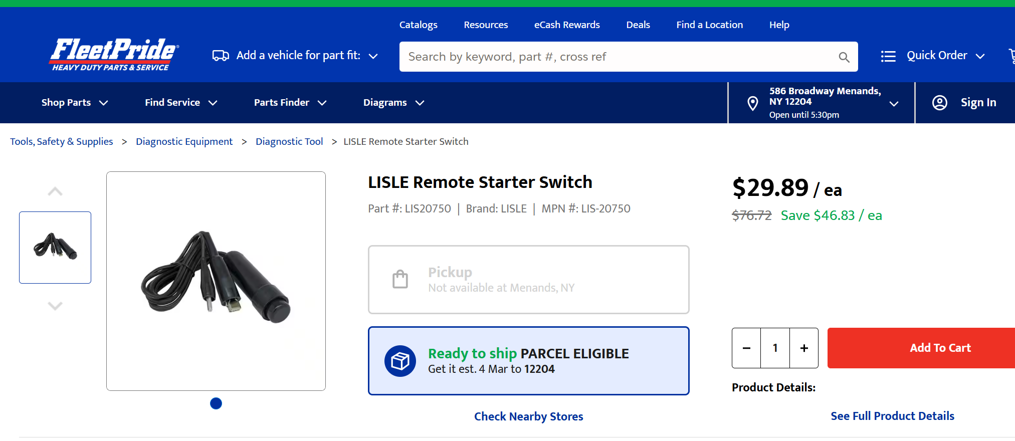

You would need two people, one to watch the voltmeter attached to the battery, while the other turns the key, or a device that can engage the starter with push button similar as below:
