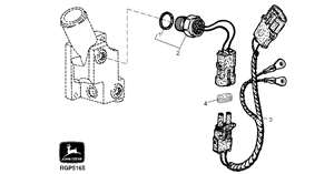

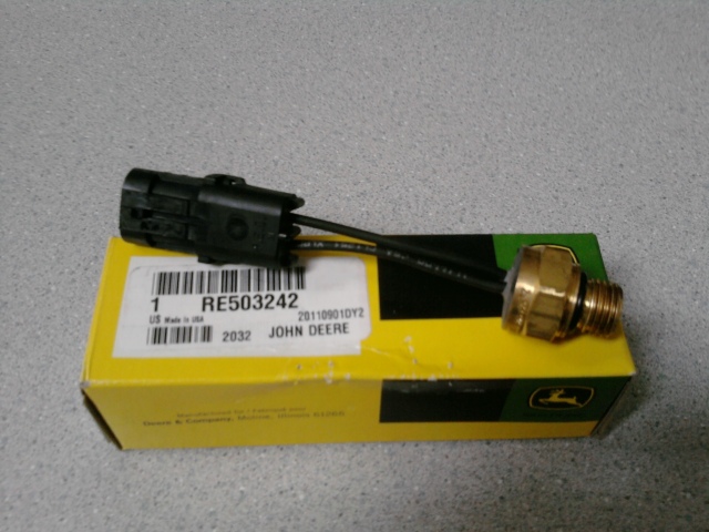

First suggestion: the problem is the thermistor sensor (thermistors are temperature variable resistors used as sensors.). On the thermostat housing there is a sensor that is connected to a two wire harness that goes to the injection pump; this is the "cold start advance" portion of the system so it starts easier when cold by advancing the timing.
When the sensor on the thermostat housing fails it shorts out and blows the fuse. Try unplugging it, replace fuse and see if it starts and runs. Check all the fuses. The part # is RE503242, if you are quick changing it, you don't have to drain the coolant, just make sure it's not hot at the time. You will want a pan under the tractor to catch the coolant, so as not too have to clean it up.

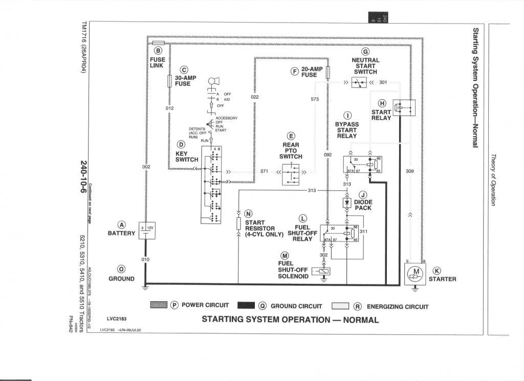

Second suggestion: the problem maybe in the starting system. I have attached what that looks like. To start here put the tractor in gear and see if it blows the fuse. If yes the problem maybe in the pto or neutral switch. If no, post back as will need to look at some of relays.

Gave this some more thought, the fact that your tractor just stop, leads me to believe that the fuel solenoid lost power. The thermistor sensor is plugged into the fuel solenoid and when it shorts out it kills power to the fuel solenoid. Must admit I would have thought the 20 amp fuel solenoid would have blown before the 30 amp switch fuse, but I would start by unplugging the sensor and replacing the fuse and checking the other fuses.

Well, I unplugged the sensor and the tractor fired right up. Ordered a new sensor online as my dealer did not have one in stock. Thanks for the help JD5210. Saved me a bunch of $$ compared to what the dealer would have charged @ $65 per labor hour.
