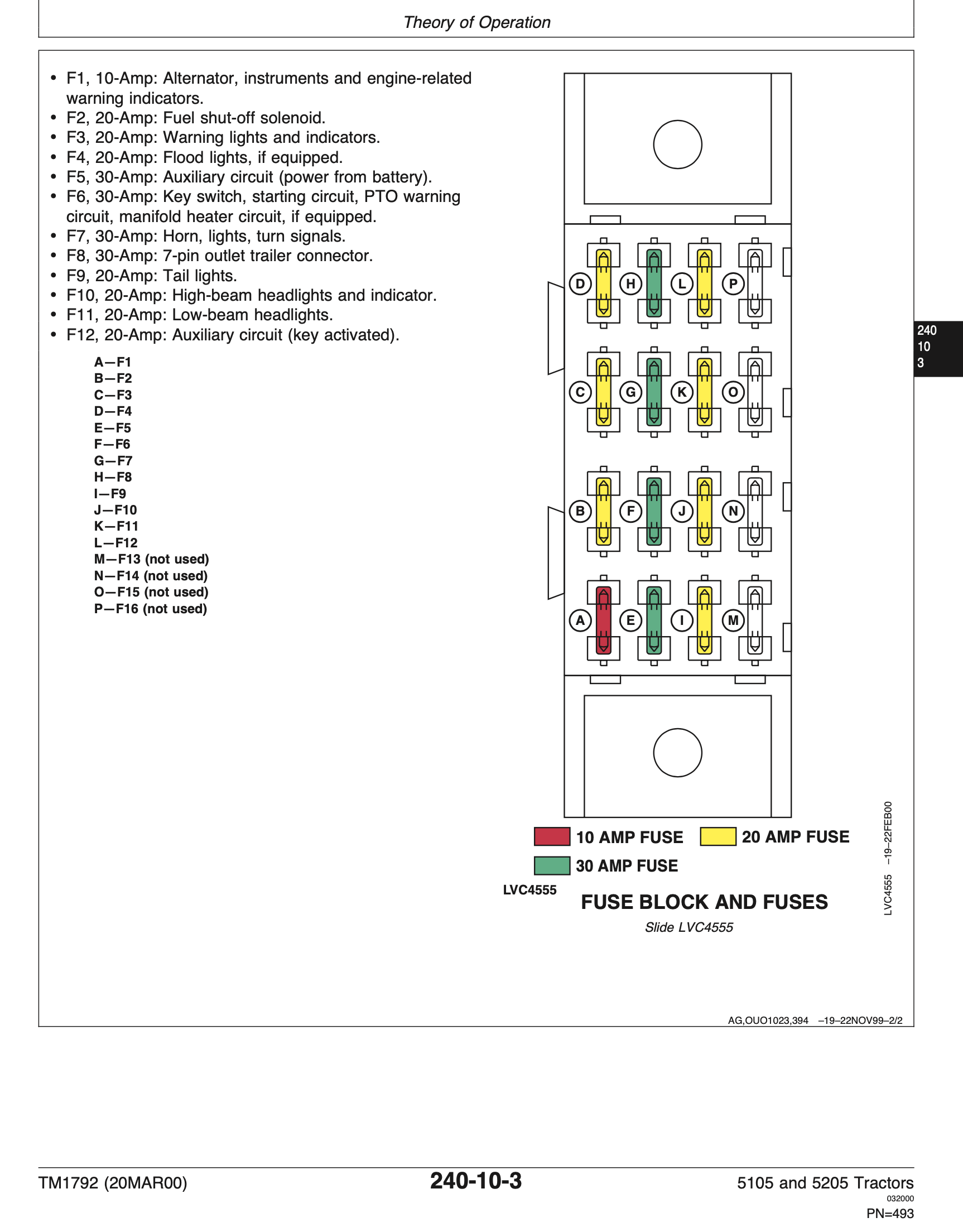

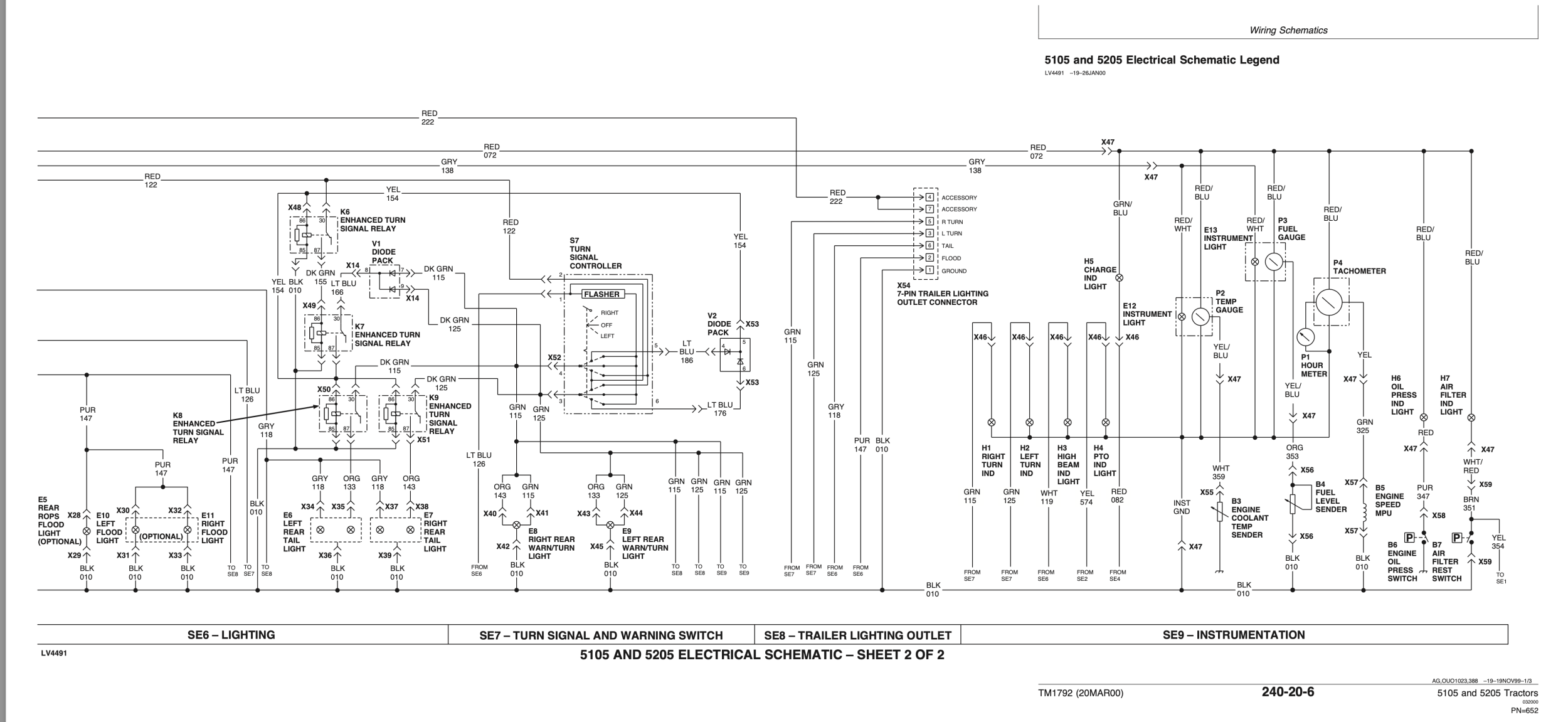

/ JD 5105 no lights #7
see if this helps -

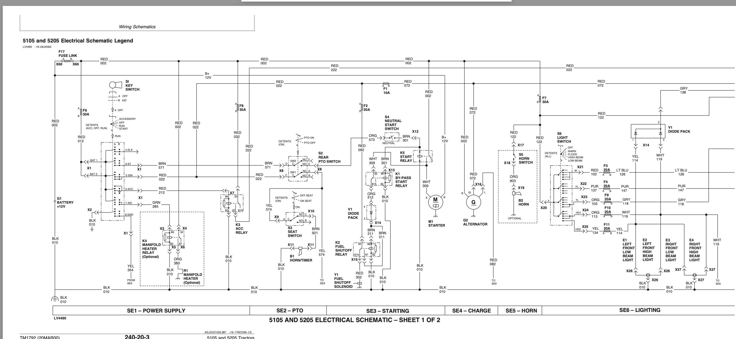

I think you need to get out the test light or meter and be sure you are getting power on both sides of the fuses, you're talking about 6 circuits not working? all the power coming to the switch and to the fuse panel is on a fusible link in the red wire coming from the starter to the fuse box
