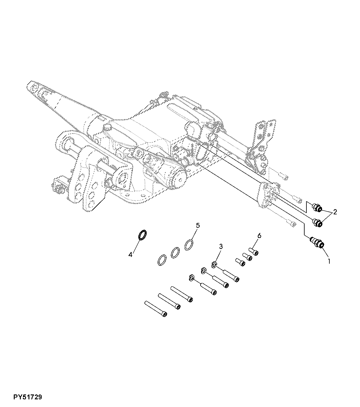

Any ideas what the PB kit looks like and where it would attach? I'm assuming prior to the loader valve and additional valves I add? I've searched for images but can't seem to find any.
/ JD 5103 rear scv kit #12
The picture below is from JDParts.com. Looks like fittings go into the block that feeds the loader valve. You would extend hoses from these fittings up to a new valve mounted on the fender or ROPS. That's why I said it would be a "cleaner" install because you won't need hoses running all the way to the loader valve.
From the JD site it looks like your pump is rated for 18.2 GPM, so the new valve and hoses you add must be rated for that-you don't want to put a valve on that only rated for say 10 GPM as overheating could result.
Edit: Forgot to add picture!
