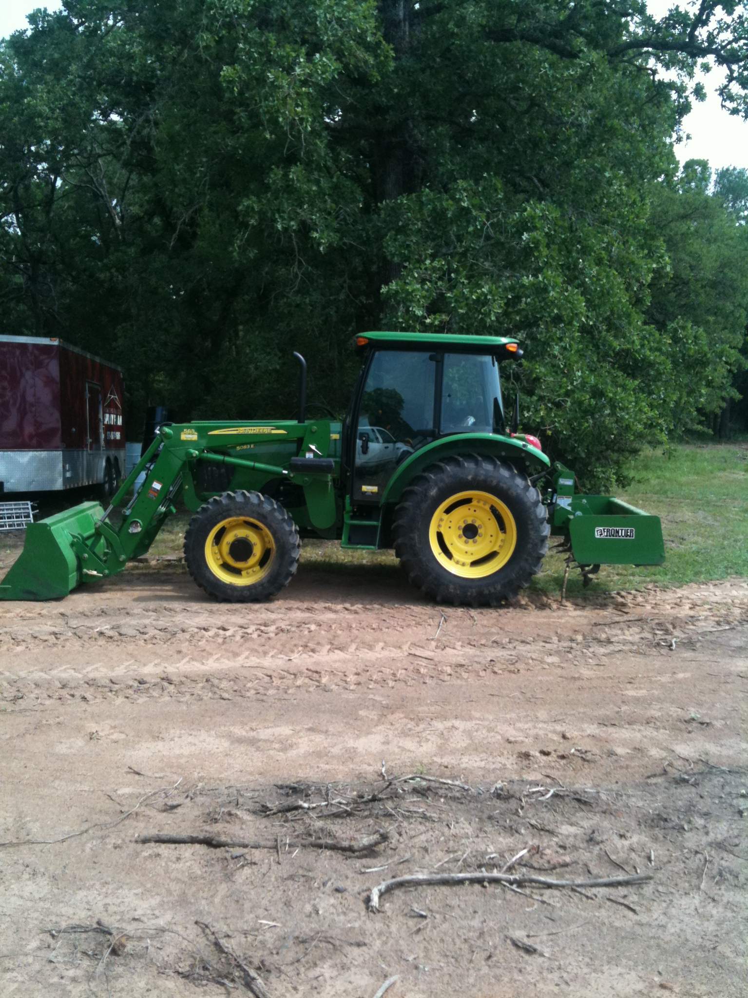

When I bought this tractor I couldn't justify the price increase for the 93 and 101 to have identical tractors with the same engine. I had the idea that I could just turn up the pump and have the same power you get from the 101. Besides warranty issues where am I going wrong on this. Tires will be replaced from normal wear one day anyway and then I can put some larger rubber on it to match the 101.

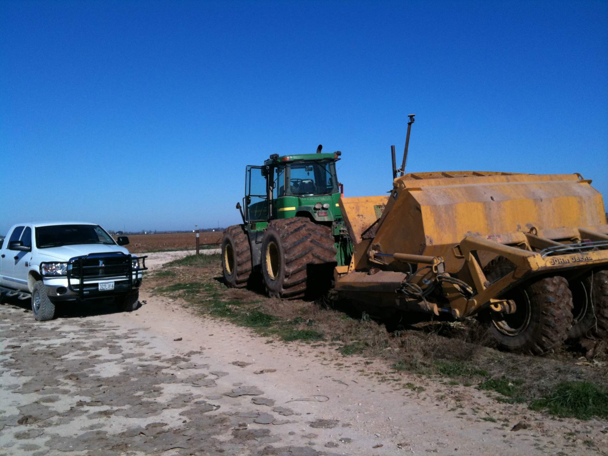

This tractor is a toy, just an expensive one. Fuel consumption is irrelevant for the jobs that it does. My concern is that I don't break my toy. The working tractors are 9520s.
