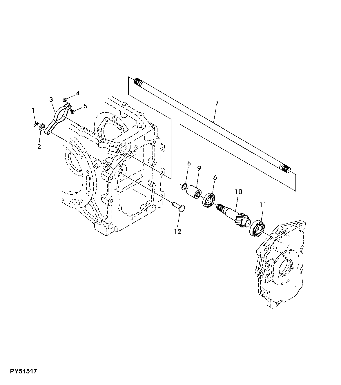

The dealer assures me there is an internal brake that locks the PTO and he hears many complaints about the attachment difficulties from other owners.
I'm hoping he is incorrect, but will try every way I can to resolve the issue or somehow adapt.
If I'm not mistaken this is the pto brake(parts key 3) but I be danged if I can determine how it would be controlled.

   / JD 5045d Problem #33
I think most of the newer Deere tractors have a brake on the pto, I know mine does. The ones with epto can be shifted into neutral to turn freely. That is what I do to hitch up.

   / JD 5045d Problem #35
My guess is it applies just enough tension/load on the bushing to prevent rotation when not engaged, so not a true brake.

#36
Hmmm..Then maybe it is worth making a spline type of socket wrench to tease a few degrees rotation out of the PTO drive shaft.
Turning the PTO shaft on the mower results in the blades building momentum and continuing rotation past the small angle intended position, so the chances of it stopping at a right point is akin to the roulette wheel in Vegas.
I hope your guess is right.

   / JD 5045d Problem
#38
I ran the tractor with PTO engaged, disengaged the PTO, shut the engine down, placed every gearshift lever in neutral.
I made sure the brake wasn't locked after parking the tractor on level ground.
The PTO drive shaft still remains locked against rotation by hand.
Then I go the ops manual to read the following;
"TURN SHAFT SLIGHTLY BY HAND IF NECESSARY TO LINE UP SPLINES"
All I can do is continue trying or adapt to a frustrating limitation.
   / JD 5045d Problem #39
try a pair of channei lock pliers and see if you can turn it ( a little more grip than just bare hands )
