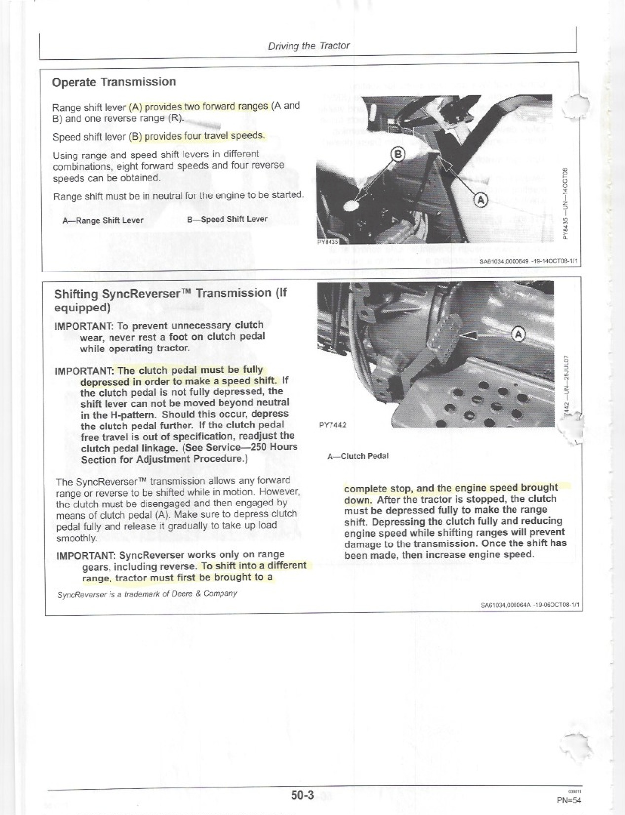

My first post here or anywhere.
I needed to replace my old JD 1070 but didn't want the new JD tractors with all the EPA baggage.
Found a low hour 2013 5045D in Tennessee at a good price.
Everything the seller said was accurate but what he didn't mention was the feature that requires the tractor to come to a complete stop before shifting gears.
It has been quite a headache.
The local dealer says the feature can't be disabled to allow shifting on-the-go like I had with my older tractor.
Can someone enlighten me on why JD thought this was a useful idea?
I've never had to use the brake because as soon as the clutch is depressed, the tractor stops dead in it's tracks.
There are times I need to creep into position, like for attaching implements, but this "sudden stop" mechanism prevents that.
The lock also affects the PTO drive spline which remains in locked position when trying to engage a PTO shaft and requires rotating the drive shaft instead of the stubby output shaft.
The seller, 700 miles away, says I should have asked the question, but how am I supposed to ask about something I've never heard of.
Even in the operating manual, the stop to shift feature merits only a single line in 180 pages.
Can someone explain the reason for it or even better, a way to disable it?

What transmission do you have? If 9 speed (3x3) you should only have to stop when shifting range (A,B,C) (Unless you've mastered driving an unsynchronized transmission); not gears 1,2 or 3.
Or are you saying the problem is the tractor comes to a stop whenever the clutch is pushed in? Sounds like your brakes are rubbing and stopping you.
What year is your tractor? Does the axle where it meets differential (where the brakes are) feel hot after driving? There's a lot of threads here about 50 series brakes (too little/too much).

The left lever is the range lever which choses A, B or R. The right lever is the gear lever which selects 1,2,3 and R.
I have tried every gear in every range and the tractor comes to an abrupt stop as if I slammed on the brakes.
I would think if the brakes were still engaging (dragging) I would sense it or at least pick up a burning odor.
The John Deere rep was sure that this model was operating exactly as intended.
I'm attaching a copy of relevant page from the ops manual so you can read it directly.
No matter, I'll try again with the Local JD Dealer to make absolutely sure that nothing can be done.

Sounds like you have the 2 range 4 speed collar shift transmission, This trans is and unsychronised trans. You have to stop to shift between gears.
/ JD 5045d Problem #10
Couple of issues getting combined and confused here.
Yes you do have to stop to shift ranges.
No, the tractor shouldn't stop just because you pushed clutch in. This is symptomatic of sticking brakes.

I think once you get the brakes repaired you will find you can shift gears without stopping. The abrupt stops are due to the brakes as other posters have said.
My 41 year old 2030 requires complete stop to shift gears and ranges. Why would JD produce? Lower cost and pretty bullet proof design.
As for your PTO I assume there is a PTO brake that prevents turning it to line up for attachment hookup. My old 2030 has a separate lever to mechanically engage the PTO shaft ( a sliding collar) AND another lever to engage the PTO clutch. Sometimes older is better.
The D is the economy level tractor, so it has less costly features. Do not blame the seller for not telling about standard features of the tractor.
At some point you may want to upgrade. My other tractor has power quad and power reverser. No need to clutch to change gears or direction. I do have to clutch (but not stop) to change ranges.
