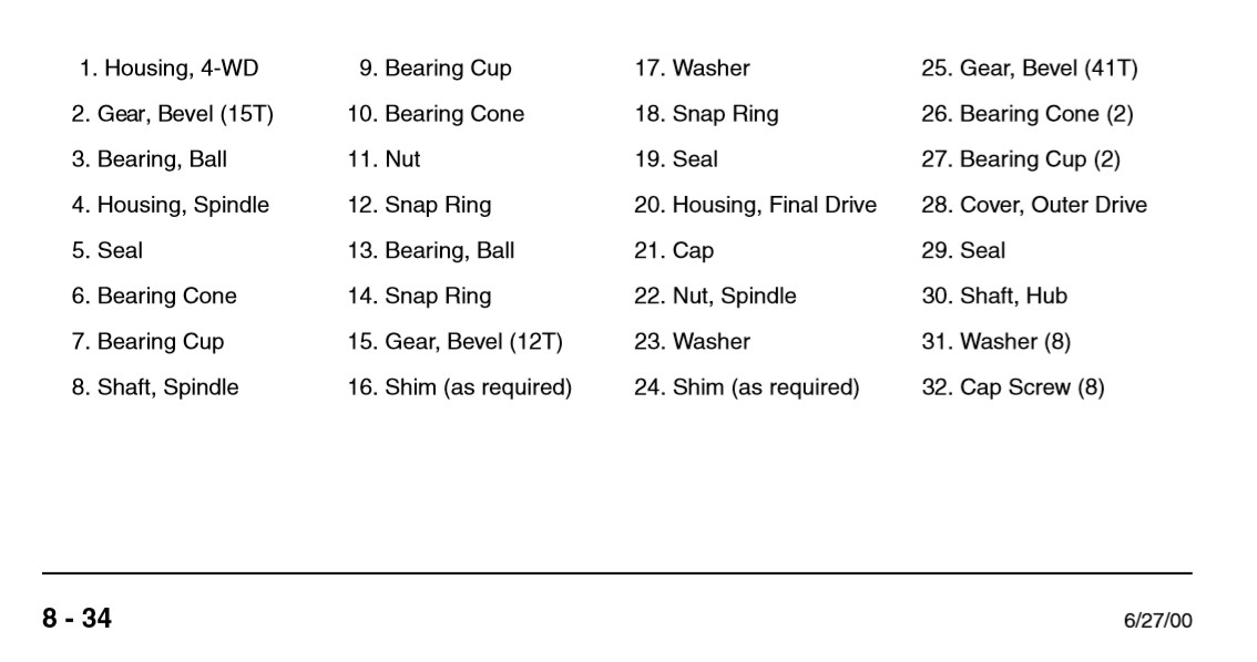

I am seeing a puddle under the 4WD axle steering pivots with my 4600 tractor. Anybody here have any experience with changing the seals in there? What is involved with this? Is it best to just pull the axle and have a shop do this?

I found the service manual buried on my hard drive. Here's the front hub exploded diagram. Doesn't look like it would be too bad. Seems like the whole hub assembly should be easily removed by taking off the 4 bolts and then the hub yoke can be brought in and worked with on the bench. If anybody here has done this, please share your experience.

I just finished doing this on a 4410. 3 hours first time sounds reasonable. I looked the whole situation over and I choose not to remove the knuckle. I laid a piece of carpet down on the floor of my shop and I did the whole job on the tractor.
To remove the steering parts isn't hard. Just loosen the nuts enough to protect the treads and then push up with a small hydraulic jack. Several sharp raps on the casting by the ball joints and they were apart. Be careful removing part # 21 and you can reuse it. It gets glued back in with a special glue so make sure you have some of that on hand. I did not use a special tool to install the seal. Just careful tapping with a hammer.
I needed a special socket to remove the spindle nut but could get it off with a punch. After it was off I made a socket. I don't see that nut on your parts diagram so there must be some differences between the front ends. I would definatly have a service manual on hand as it just makes the job that much easier.
Have fun!
I should also mention that the new seals came in Dana/Spicer boxes with John Deere part numbers stickered over the Dana part numbers. They also weren't cheap. $230 CAD or so both seals so if you can find the Dana/Spicer part #'s and order from Spicer you might be able to save a few $.

Could you tell which of the 3 (?) seals was leaking?
Am wondering if the #29 seal is leaking if just the #28 part can be removed and replace just the single seal. Admit that probably would not be that easy, and smart to replace all seals.

On my tractor #29 was leaking and also #19/#5. On my tractor those two pieces came as a set. #5 is a steel wear ring.
At first they would only leak as the differential warmed up. Towards the end they were both leaking constantly. The rim/tire was coated in oil.
I don't know of a third seal.
#28 is easy to remove if just the wheel seal is leaking. And really the rest isn't that hard to remove either if the spindle seal is also leaking. It just takes time.
Also I spent some time brousing John Deere's parts web site. Make sure you use the right parts diagram. There are three different ones for the front drive. #14 is a heavy duty snap ring. You'll need a heavy duty set of snap ring plyers to remove it. #11 is the nut that I was able to remove with just a punch and later built the socket. My nut was held from turning with a lock washer with tabs on it that got bent into the slots in the nut
I was able to make the socket by using a 4" piece of exhaust tubing and pushed the nut into it with my hydraulic press. I then carefully sawed the pipe to fit into the slots in the nut, tapped the cut pieces into the slots and again carefully welded the cuts up. I then welded an old socket onto the other end and I had enough of a socket to handle the 14(?) ft lbs of torque called for.
