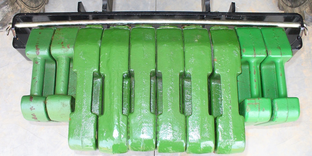

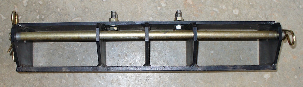

I recently added the optional front weight bracket that attaches to the frame front weight bracket on my 4520. This lets me put 10 weights on instead of just 6. I need more weight because my MX-6 mower on the iMatch upped the ballast requirements.
The 1st picture is the 6 weight bracket that fits on my JD 318 garden tractor. Note that the retention bar goes through 3 mid position plates.
The 2nd picture is the optional 10 weight front bracket for the 4520. There are no mid position plates- the bar runs the entire width of the bracket. You can see a bend to the bar, and the 3rd picture shows that a little better.

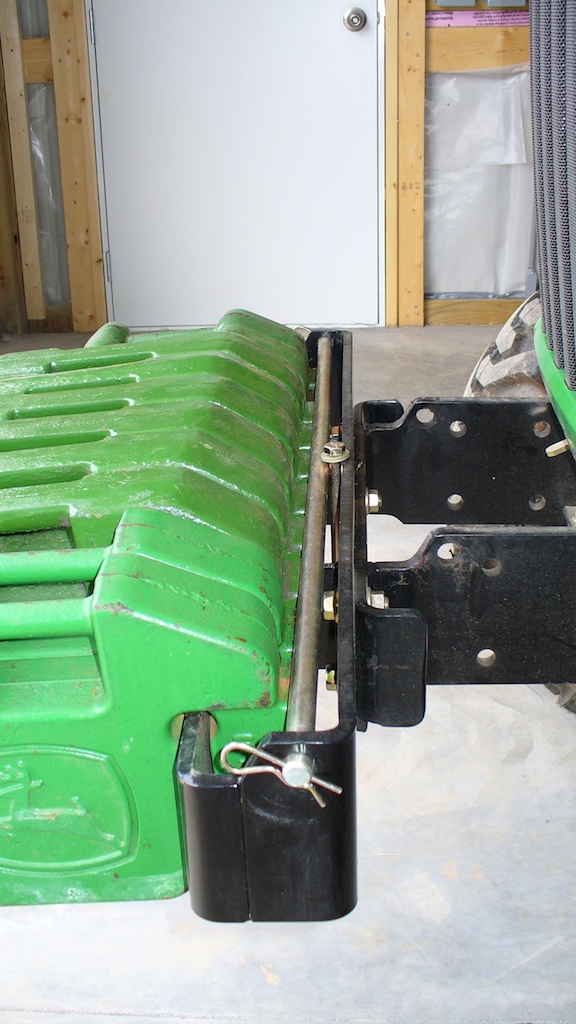

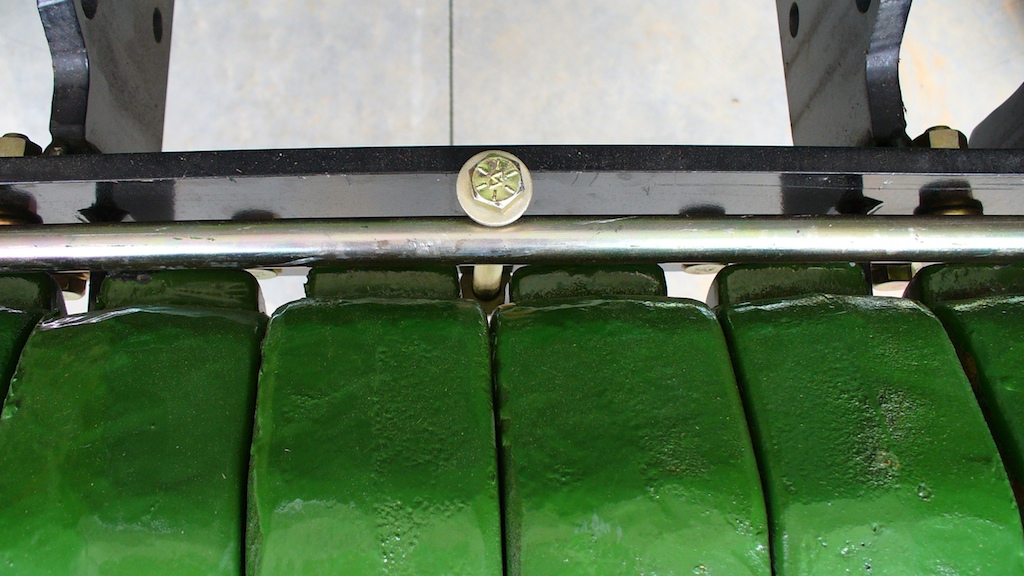

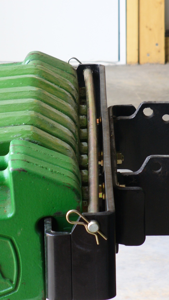

So I put in a 7/16" bolt to keep the bar from bending. Could have used a 1/2", I'll get one sometime. You can see that and the reduction in bend in the next pictures.
When the tractor came back from the dealer, the bar had bent in enough that the inner weights were not secured by it. This part must be for multiple tractors because it has extra room (but not enough for more weights) at the ends.
It's sad that they got it right 15 years ago, and didn't get it right now.

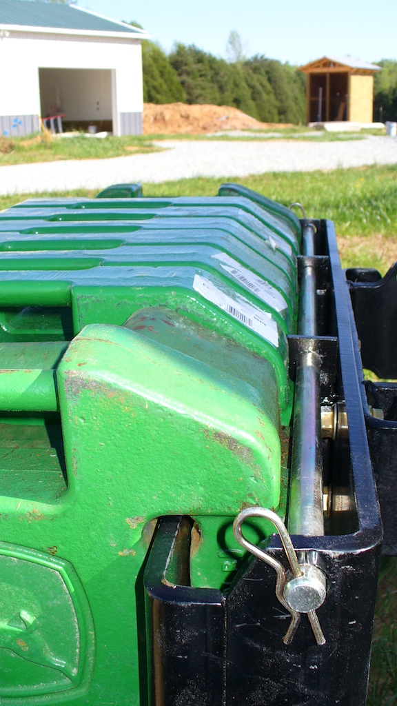

So I took the bracket to a welding/metal fab shop I used years ago when I needed a special holding jig for a chassis for my milling machine, and had them add two plates with a holes so that the bracket holder had a good chance of working. They did a great job and even painted it, 1 day turn, $40.
The Deere weights came in at the dealer, and I went to look at them. They are correctly shaped, unlike the aftermarket ones. Note that the aftermarket ones in the 42# and the big honking weights (don't know what they are for the 6000 series and up) are OK, but the 70# ones are a bad mold. So I decide I want the 6 70# Deere weights. I bring the modified bracket and show it to my salesman at the dealer.
He's feeling bad for all the grief I'm going through. He said that's only the 2nd weight bracket the've ever sold, and others have just "made do" with the aftermarkets. As his way of making up for this confusion and my time, when the paperwork clears it's an even swap :dance1:.
This is why I like my dealer and salesman, this is why I'm always civil when things happen (and things always happen). We even figure out why I didn't get the word on the aftermarket, and everyone in sales (both tractors and parts) now has the word at the dealership. I've sent him the picture of my modified bracket, he'll forward it to Deere central. Problems are solved by focusing on them, and then when the problem is solved it's easer to go back to the people and figure out what happened and fix all that people stuff.
But to heck with all that, let's look at the pix:
The 1st one is using a jack to gently lift the weights. When I did this, the bar just slide through by hand no problem. The genuine Deere weights were the trick. Thanks to Steve for this little trick.
The 2nd pix is a top view of the entire assembly. There is some distortion in the picture, but you can see the bar is not bent, and you can see the mid position brackets that the bar goes through. I've added four 40# weights, and if things get squirrelly I can get more 70# weights if need be. Note also the bracket puts the weights more forward by about as much as the iMatch puts the MX6 mower more backwards. Someday I'll get a pix of the hill with pond at the bottom that's causing all this concern....
The 3rd pix is a shot straight down the line. You can clearly see the added flat bar with hole that the round weight holder goes through, and the bar is not bent.
