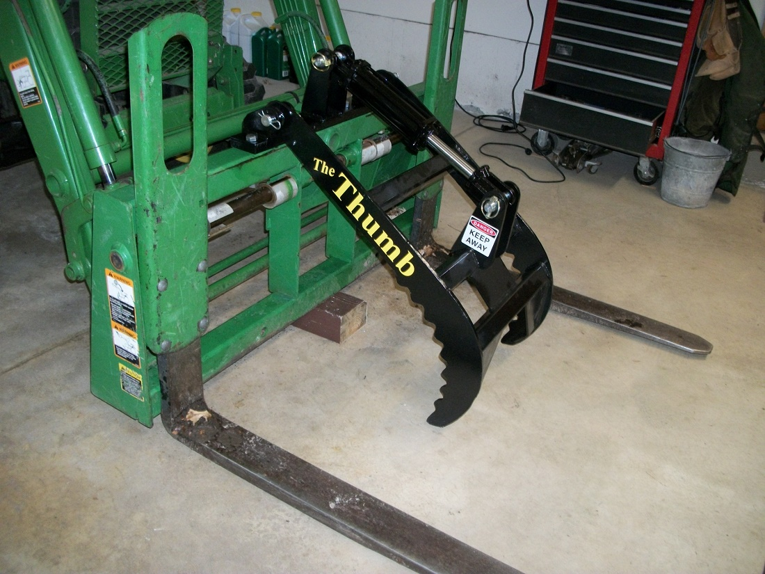

The Thumb I added to my forks was bolt-on, also could for a bucket. Price was reasonable, IMO.
Don't know what your limits or possibilities are with your backhoe bucket.. a pic would help with dimensions. Or let you take it the next step and contact greens-machine.

Beenthere: What the heck? Now I won't be able to sleep until I put one of these on my loader. Fantastic addition!
