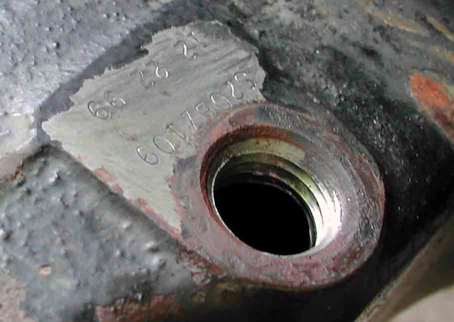

The outer front axle seals are shown in the repair manual. There are two types in
2001, as they must have changed the design about then. It goes by serial number.
The model # of the front axle is hidden under paint next to the fill hole. All versions of the front axle
(4 total, I think) are shown in the manual. Tho 2001 is the last year of this tractor series, the actual
tractor may have the earlier type.
