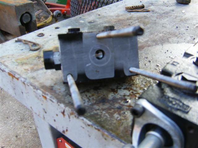

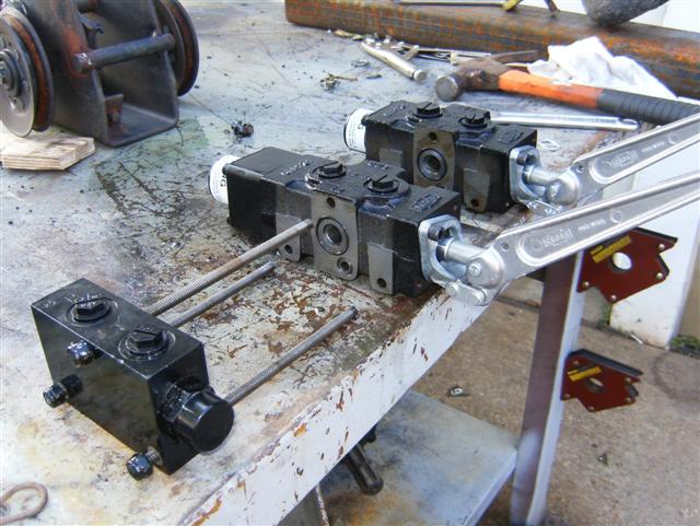

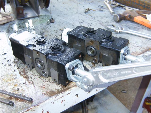

KennyD-More info! I think I'm 'Golden', but need your reassurance. The valves and PB block are all ganged together with three all-thread rods. The port on each valve ( both valves are the same body) have a large O-ring that allows them to be 'stacked', but, the ports are also threaded and beveled for ORB fittings. So my feeling is just remove the PB Block, and go in with pressure on the one side, and out on the other side! Pictures attached. ~"Scotty"

I think that will work...not 100% sure. Certainly worth a try for sure.

KenneyD- Well, your right, as usual, even when you think your not! I just had to know, so another visit to "Bucks-Deluxe" hydro shop, $200- later, I had 2- 3/8" by 24" hoses with QD's on one end, and 3/8" JIC, on the other! Also bought 2- 1/4" hoses for one of the rams, and a bag of fittings. Plumbed up to the 3rd SCV on the tractor, and bungeed the 3rd lever! Rear pull on the lever pressurizes the TOP QD! Good flow through the valve body, and no leaks, or hyro-growl! Plumbed the first ram, and, voila!! Good movement! I'll wait on the other lines, 'til I get a better price, but I've got operational flow in the second valve also! If you need a PB block for a Cross valve, I'll send it to ya!! Shouldn't be 'bugging ya' ('til next time) :D !! Thanks! ~Scotty
