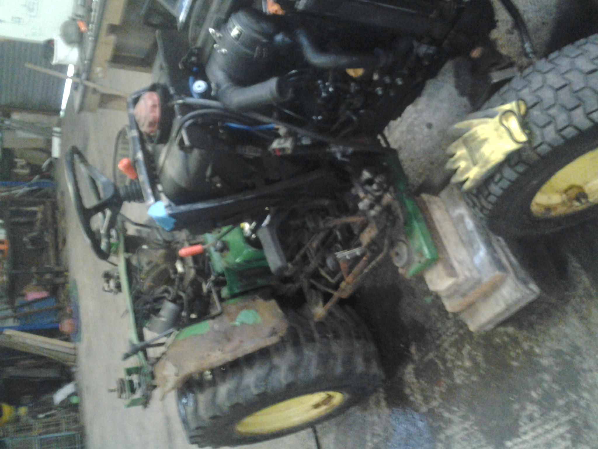

Hi can anyone help I have a 4115 that I bought as an unfinished resto project I was hoping to get some photos of the
Alternator bracket in actual situ and pump just want to make sure I put it back together properly. Many thanks in advance.

Here ya go. I just went and took these for ya. I hope they show you what you are looking for-
/ jd 4115

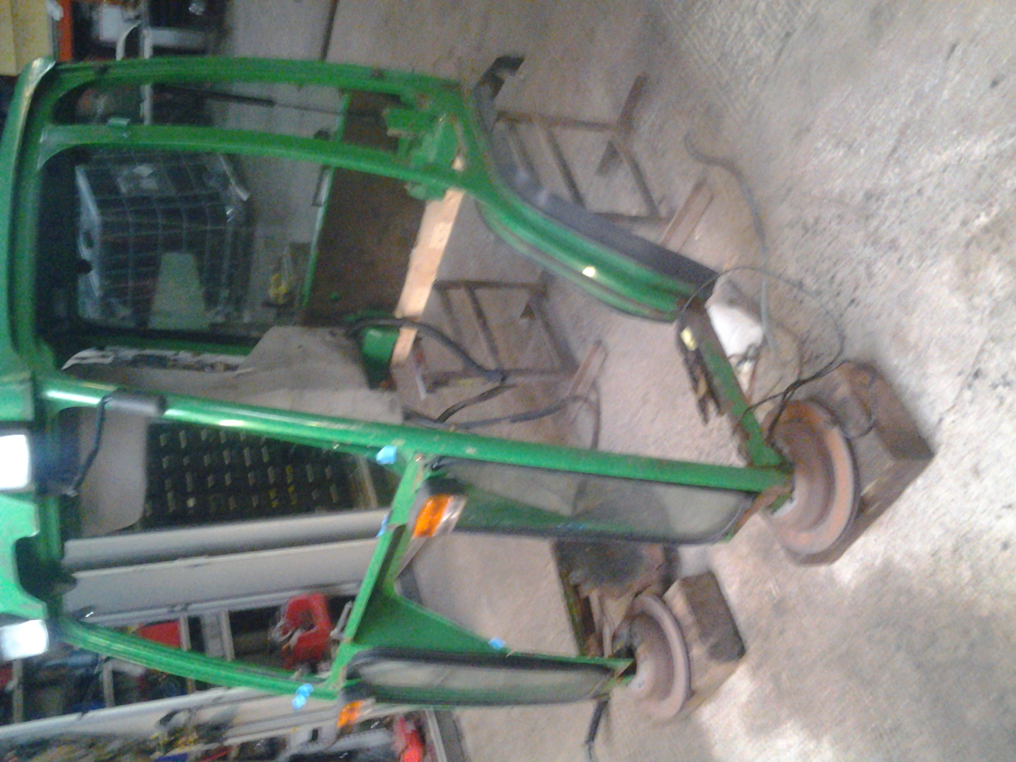

20140214_105747.jpg thats great thankyou for your help and quick reply, think im missing a bracket from underneath the manifold. Couple of pics of the project, only a couple of days into it,
/ jd 4115 #5
I'd love to have a cab like that for mine.
/ jd 4115
View attachment 361337 thats great thankyou for your help and quick reply, think im missing a bracket from underneath the manifold. Couple of pics of the project, only a couple of days into it, 20140214_105807.jpg

Hi RG1 does the belt tensioner bracket bolt to the water pump?
Sorry to be slow, but I had to run back out to my shop behind the house to check.
No. The tensioner bracket runs over to the engine where it has a double bend in it that goes down and back towards the engine. It has a hole in it that the mounting bolt passes through, where it threads into a hole in the top of the engine below the thermostat housing. If you look at my 3rd picture down from the top, you can see the bend I am talking about in that bracket. That should give you an idea of where to start looking for the mounting hole just below that.

Your alternator looks thinner than mine ill have to wait til water pump arrives to discover how it routes. I added another photo
/ jd 4115 #17
The bracket should still mount to the same point on the engine though. The mounting hole is above and to the left side of the water pump, just below the thermostat housing.
20140217_230436.jpg20140217_230615.jpg ive been back out to the workshop took these pictures, my bracket is straight, ill see if theres any way it bolts on
