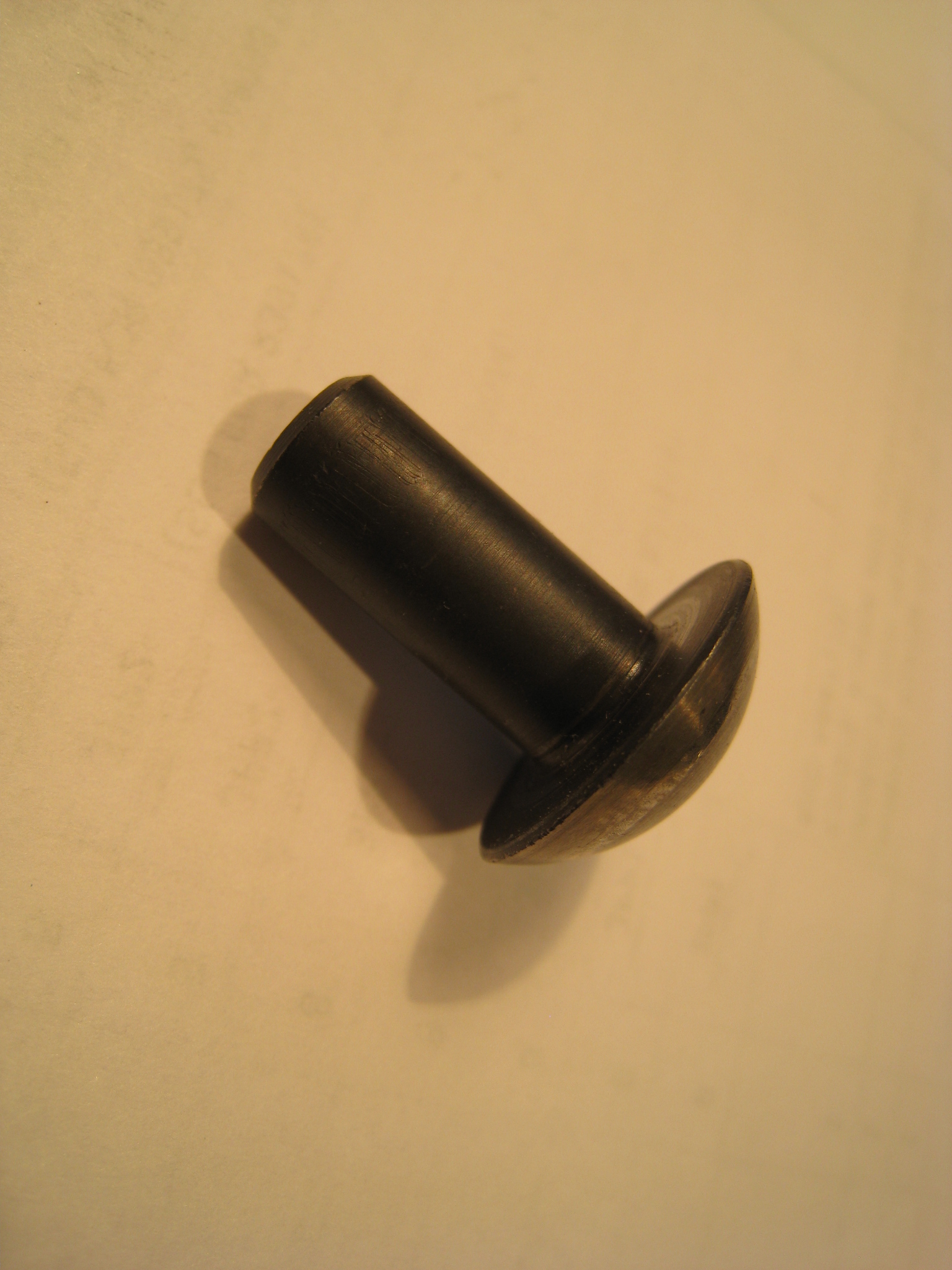

I am thinking the same thing. There is a nut above the vertical filter near the top of the transmission that I drained the fluid from one time. I bet the part goes in there.

that part looks like some sort of poppet possibly from a valve should be a spring somewhere in there also
I go long with what olde man said and I would stop doing anything and work on finding what valve it went in.

I found the location that was missing the part I found in the tub when I drained the fluid. It went in the relief valve next to the horizontal filter. This relief valve has 3 parts that are listed as valves: 2 ea. of 40976 and an R-57559.
I put the fluid back in, but kept out 3 gallons that looked like it had droplets of water in it.
The tractor, hoe, bucket and outriggers all work fast and with power. Given the fliud has not reach a hot temperature yet, when it does, I might find, other problems.
