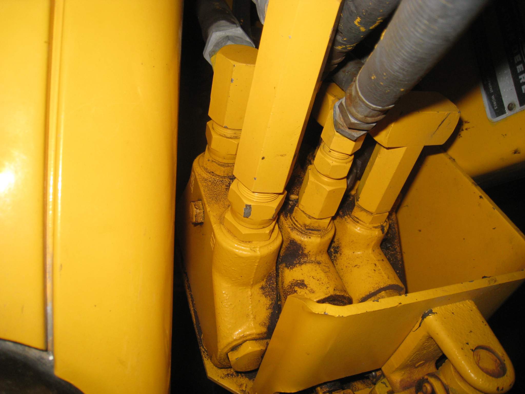

Your joystick valve probably has a relief valve close to the IN port.
Can you show a picture of the joystick valve especially the top of the valve.
/ JD 400 Backhoe pulsating weak hydraulics
J_J:
I have attached a jpeg of the view I think you asked for. If not, I have more of the hydraulic lines and parts. The hoses on the left are the in and out (?) and the other goe to the cylynders. I guess. JimmyBOD

/ JD 400 Backhoe pulsating weak hydraulics #6
Sounds like the pump. If its what I think it is its an Oil Gear pump. THey are a radial piston pump and has pugs and pistons around the outside of the pump. We had this happen at work on one of the JD scrapers. One pump had a worn piston and had good presure till that cylinder and one had an egg shaped bore. Kintec remans these pumps.

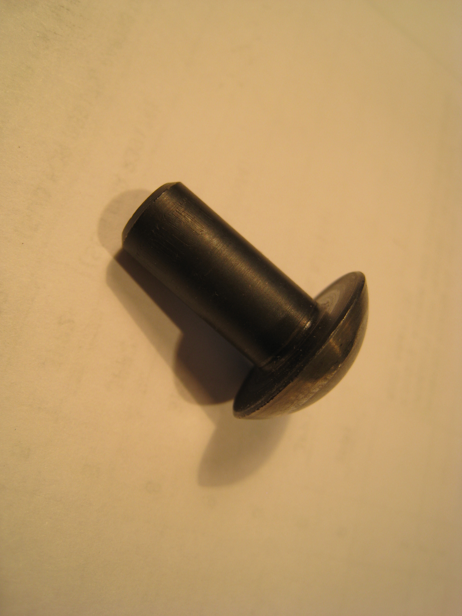

I want to thank everyone who has posted info to help me with this issue. You have given me many things to work on. Also would like to post a picture of a part that I found in the fluid when I drain the hydralic fluid from the plugs around the filter. It is a small part that might have contacted a spring of something else, don't know what. I took it to the JD dealer, head mechanic in Parke, he was too young to have worked on these tractors so he wasn't any help. Anyone know what this is and where it goes?
/ JD 400 Backhoe pulsating weak hydraulics #15

that part looks like some sort of poppet possibly from a valve should be a spring somewhere in there also
