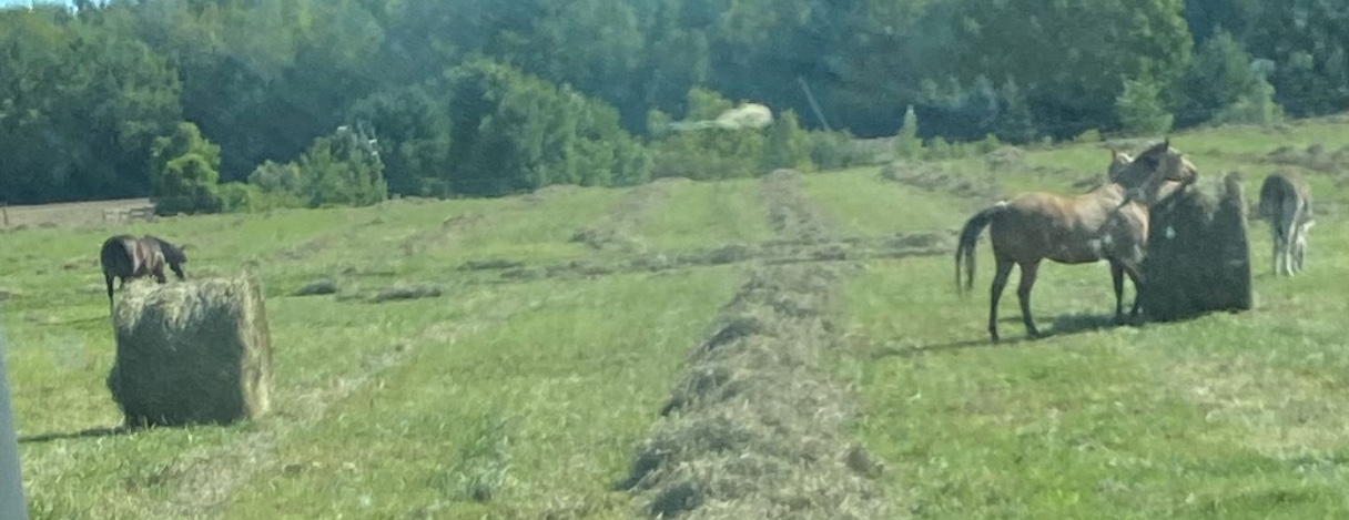

Hi all, I’m considering buying a round baler and going to look at this one tomorrow. Can anyone tell me the good or bad with this machine? The owner says he put up 200 bales with it last year and he’s going back to squares for his horses. He’s asking $4200. I think something is out of adjustment because his bales look a little bit off.
I’d be pulling it with a New Holland 545D for now. 2WD - 63HP engine and 51hp at the PTO. My property is flat as a board. Eventually I’ll pull it with a Case 831. 64hp at the PTO. I would put up about 200 bales/yr and they would be for myself and not for sale.

Round bale shape is determined by baler operator & shape/size of windrow. Rd balers of all makes have an operator ""learning curve"''. Some rd baler operators master the ""learning curve" & some operators never will master the learning process. Model 385 has no monitor box so one must look back at bale shape sensors in an attempt to form a level bale. The more time operator spends time looking back the more opportunity operator has to turn tractor steering wheel the wrong direction. The baler in photo has no converging wheels which causes operator more difficulty in making level/firm sided bales.

As TxJim said, his bales are most likely off because hes not raking properly and/or not steering his tractor properly over the windrow.
How many bales are on it? Take a look ar sprockets & chains for wear. See if theres evidence of frequent greasing (old grease & new grease). Look at the pickup bands & look for unusual wear. Look at the belts for damage or wear.
$4200 is very reasonable for a running baler. Does it have a CV joint? check for wear on it and pto shaft wear to u-joints. Plug it in and make sure monitor functions work. Monitors can be very expensive.

JD model 385 has no monitor. Bale levelness is determined by operator needing to look back at bale level indicators on baler. 385 parts catalog shows it has a CV driveshaft.
