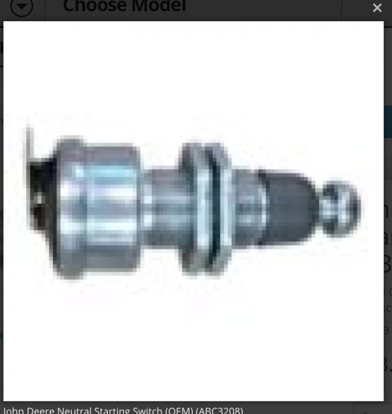

Was curious, so looked at jd parts.
Is this fwd/rev switch likely what you need, or where the neutral switch is located?
Where the neutral switch is located. The backhoe works perfectly when started. I’ve checked all over and I’ve found a button switch, about 3-4 inches long, located on top right side of the transmission/axles but want confirmation before I start ripping things apart. What I found looks like the attached pic

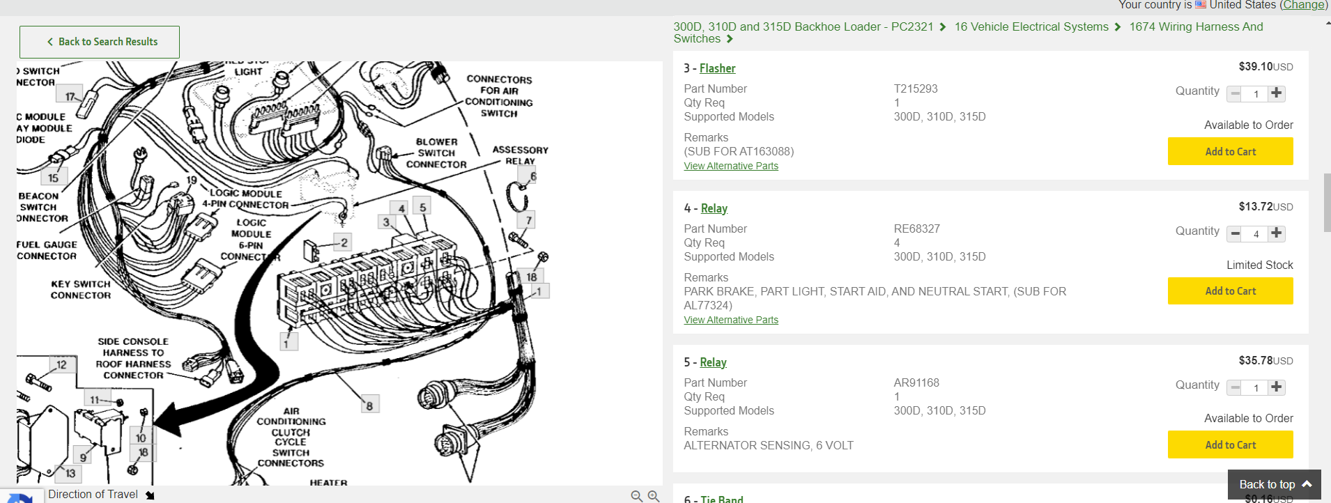

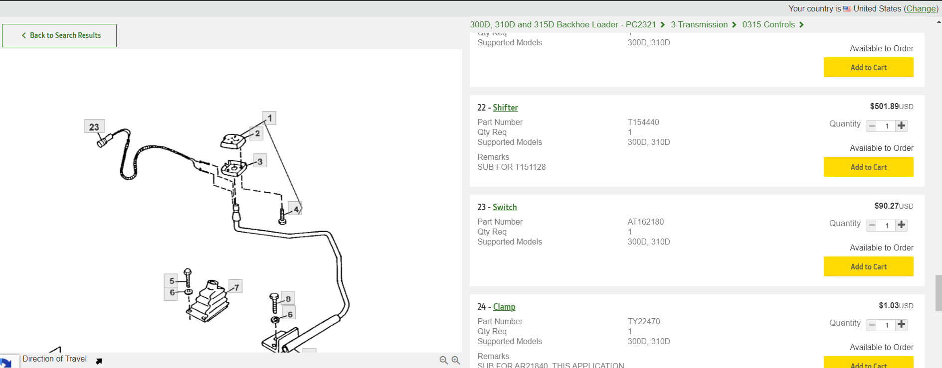

/ JD 310D neutral safety switch #4
Neutral start relay is shown as 1 location of key 4. Switch(key 23) is associated with trans control shifter BUT I'm not sure if it's a NSW.
