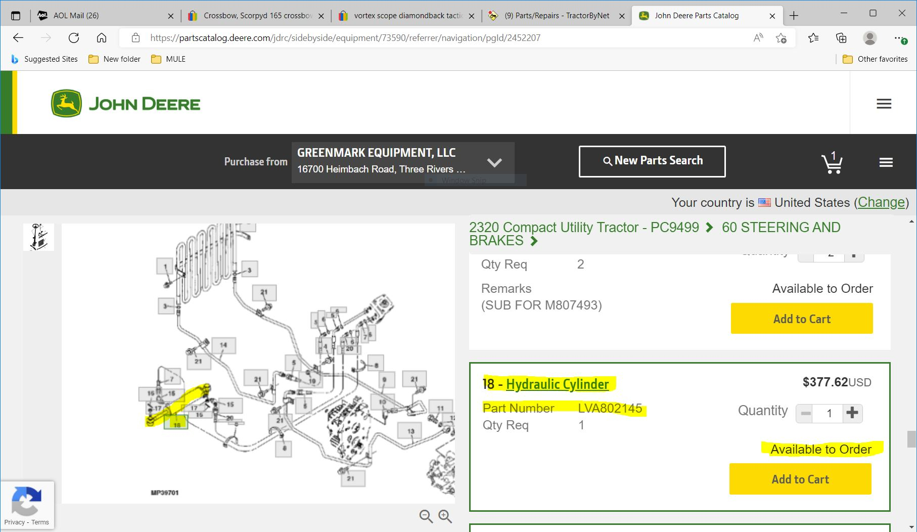

Does anyone have info on replacement for the steering cylinder on JD 2320. I can’t believe John Deere said it’s discontinued.
/ JD 2320 steering cylinder #2
JD parts shows it's available to order
/ JD 2320 steering cylinder #4
I’d be calling around to so other dealers, I can see Deere being out of them, but not obsolete, be sure they are placing the order as a “machine down” order, that should get it moved up the line in the system. Lots of dealers will always place their orders as stock orders to get themselves free freight and additional discounts on the parts
/ JD 2320 steering cylinder #5
JD dealers can also check stock of JD dealers nationwide.
I wanted some discontinued parts, my local dealer found another JD that had them in stock. I called that dealer that had the parts I wanted, paid by CC and had the parts shipped to me.
