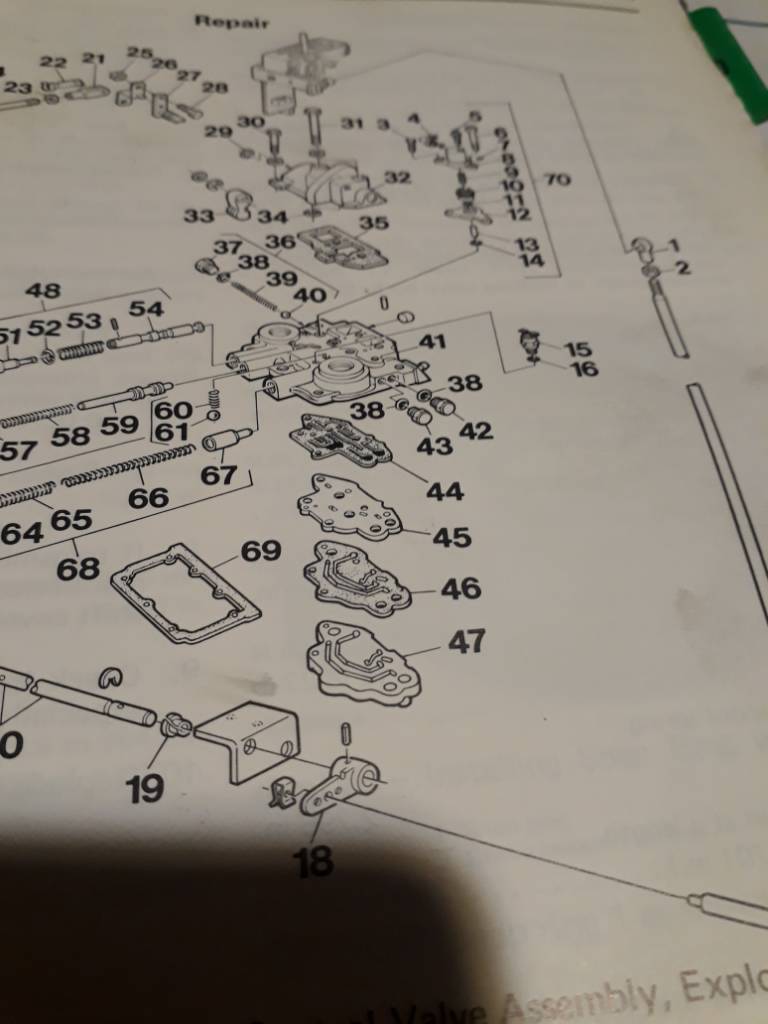

Have a John Deere 2240. Hydraulic oil shooting out of what appears to a breather hole on top of shift cover. Changed all o rings & gaskets to no avail.
Please can anyone advise?

Or it can be that that bolt is loose .....to repair it that PTO shifter AND the gearshiftcover must come off ...turn opside down and check bolts and gaskets under it .
/ JD 2240 Hydraulic Geyser
Did all that. Still shooting out.

No didn't add locktite. Don't understand, that bolt doesn't look as having anything to do with the breather hole?
/ JD 2240 Hydraulic Geyser #9
Thats not the breathing hole . Breather is at the oilfiller cap at the back with the fillercap.
If you remove the gearshifterover and look at the ack of that shiftercover you will see all the ports for the IPTO clutch/ brake and the MFWD and if equepped the hi-low. I think 4 bolts with different lenthes hold that "sandwitch" together. Check that the correct bolt is at the correct hole AND that those gaskets is not blowen ?

I wonder if it could be some sort of manufacturing hole that was once plugged but the plug popped out?
Because if that's not a breathing hole, what is it? Why is it there in the first place. It sure looks deliberate. I'll admit that it probably isn't a breathing hole - or any kind of hole that is supposed to be there simply becasue I can't imagine a breathing hole or open hole on a horizontal surface that doesn't have a way to exclude water and dirt. After all, breathing works both ways.
But whatever it is, it sure looks to be a deliberate hole, and it doesn't look to be threaded (or is it?). I suppose it could be a hole made in order to access a machine tool in order to machine some inside passage. That's not so unusual; castings often have that sort of hole made in the outer surface during the machining part of the manufacturing process. Holes in castings are later permanently sealed by either peening a ball into the hole .... or sometimes by threading the hole and installing a threaded bore plug - often a headless allen screw dipped in thread sealer.
Holes, don't just appear by magic; why is it there in the first place?

Well, replaced o rings; gaskets again even drained hydraulic, changed filter. Didn't work. Still spewing fluid through that hole. Does anyone know why it's there. All the diagrams show it but there is no reference. Any suggestions are greatly appreciated. I'm frustrated.
/ JD 2240 Hydraulic Geyser #14
It looks like a defect in the part that has opened up, that isn't supposed to be there.

wrong pic for that hole ! I say again ...remove gearlevercover and look at its bottom(the inside of the gearshiftcover) for the bolt that should be in tgat hole !
/ JD 2240 Hydraulic Geyser #16
/ JD 2240 Hydraulic Geyser #20
I toke this photo out of the JD3140 book just to show you the gaskets under the gearshiftcover. I do not have the JD 2240 book.
