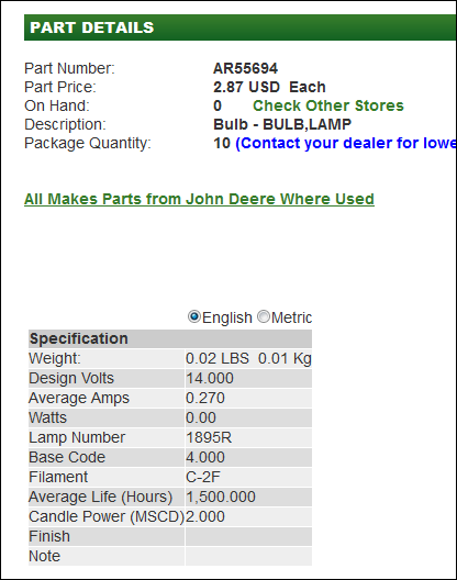

/ JD 2020 2030 Alternator Light? #4
Here's the alt indicator (idiot) light bulb spec's.

JD part #(AR55694) is shown in photo I posted. Auto parts store number(1895R) is also in photo

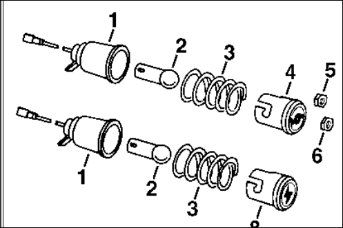

that's the bulb. i need the unit it goes in...

Are you aware you can view 2020 parts catalog for free at JDparts.com plus if you register with a JD dealer you can check price plus dealer availability of part?
Parts key 1 AT44165 Wiring Lead - LEAD, LIGHT ADD 17.76 USD

/ JD 2020 2030 Alternator Light? #16
thanks for the replies.
noticed my new battery was not recharging. (recently new wires were run from alt to solenoid and battery etc)... having the deere shop replace the pto seal and also check the alternator (which is an original john deere). gonna make sure the alt is fine first then replace that new LED alt light.
Zebra: i have the part# for the replacement jd alt light thanks to TxJim... my dealer doesn't have the light. what light would u recommend i use for the alt light that i may pick up locally or easily order online? tx
Any auto parts store should have it. Ask for 1895r the "r" on the end is for a red, but it does not have to be red to work. So if they have 1895 that is clear it will work.
For online, just "google" 1895r and you should be able to find many sellers.
If the alternator tests OK, it's either a wiring problem (including wrong bulb) or it could also be the voltage regulator.
