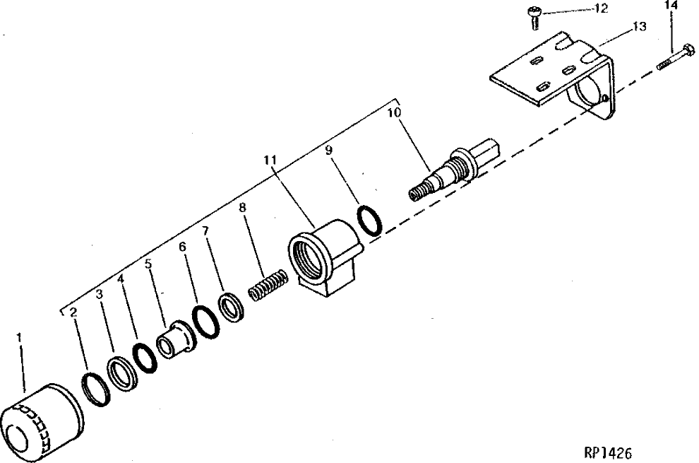

Shouldn't need to bleed anything.I wonder if they used the right filter? It is on the suction line.Could be the pump is getting weak? Mine has over 5000 hours on it,and the pump is getting a little weak,won't lift as much as it used to.
/ JD 1050 hydraulics problem
Shouldn't need to bleed anything. I wonder if they used the right filter? It is on the suction line.Could be the pump is getting weak? Mine has over 5000 hours on it,and the pump is getting a little weak,won't lift as much as it used to.
I'll try to check the filter part number tonight when I get home... unfortunately with the days so short now, I leave before daylight, and I usually don't get home until after daylight has disappeared, so working in the dark is problematic and I usually can only troubleshoot on weekends when I have more daylight. Old eyes.
Is it possible to put the circular filter screen in the wrong way? Hate to crack it open to check on it and have to replace all the fluid, to the tune of ~$150, again...
Trying to think of other possibilities....
/ JD 1050 hydraulics problem #8
Filter screen is CH13395 and hyd filter is TY9425E
