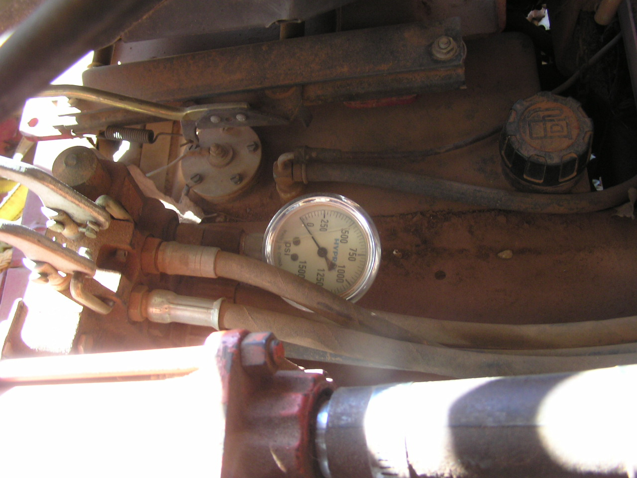

Do you have a high pressure gauge to see what it is doing?
I put one on the loader valve to see what is up. Or down ;) .
/ It's time; either get started or....
#185
I don't have one that is specifically for testing hydraulics but I'm thinking an old gauge off a cutting torch, either oxygen or acetylene side might serve. In the meantime, I have the pump off. I can turn it by hand but it feels like there is a "load" even though the ports are open and there is no fluid in it. Is that normal? The Sta Rite pump I have on the bench turns freely and I can feel there is both suction and pressure. The problem with that one is the three outputs and how to manage the two I can't use.

I would start with teeing a 3000psi or 5000psi gauge into the line from the pump to the valve to see what pressures you are getting from the pump.

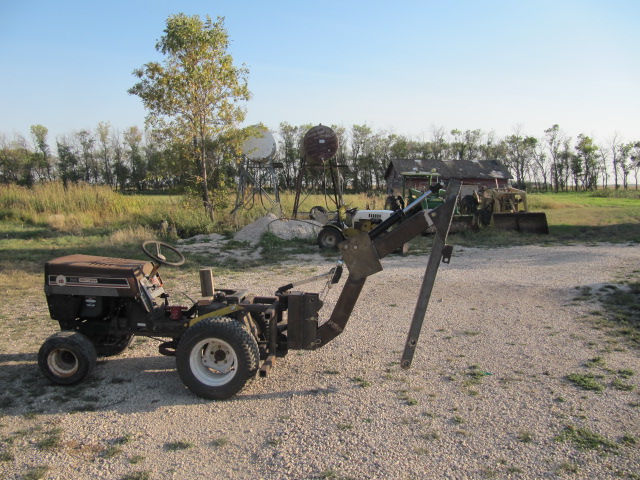

I have been asked on a number of occasions what the specs for the pump are and have not been able to give an answer to that question - till now. Turns out that answer also explains what I have going on with the wonky operation of the hydraulics. The output measures a whopping 1.4 ci per rotation and even with stepping the speed of rotation down the volume of oil it tries to circulate simply stalls the pump or the engine or both. I have pulled the pump out and am about to install a .488 ci unit in its place. I'll need to make modifications to where the pump is mounted to accommodate dimension differences. While I'm at it I hope to install a pressure gauge so I can monitor that as well.
#199
The new pump is in and after fabricating a mounting plate out of 1/4" steel plate I bolted it all together, connected the input and output hoses and was able to successfully test the operation of the cylinders. With the restrictors in place they all moved well without the previous issues so that was positive for a change. The temporarily installed pressure gauge showed good pressure in the 2000 psi range but it only registered any pressure when I moved the boom or dipper. I take that to mean the absence of backpressure in the system when no work is happening. I took the gauge out because I don't have a convenient place to mount it.
I have not tested its digging capabilities yet; that will have to wait for tomorrow. Today was taken up with switching the away and back hookups of the valves on a couple of cylinders and taking care of some seepage where NPT connections are being used. Its finally looking like I can dig with this machine. Tomorrow should reveal what its capabilities are.😰
#200
I finally took time out from gardening and yard care, etc, and tried out the "digger". It became evident quickly that I have design flaws to correct. The swing cylinder broke loose; it is supposed to remain stationary while a link does the swing. Next, the dipper does not lift high enough to allow for dumping the bucket. I'm wondering if I should have made the boom straighter. Well, it's too late for that so I'll do some changes to compensate. It's pretty obvious what kind of "engineer" I've turned out to be!:( Lastly, there still seems to be slippage in the drive to the pump so I will need to address that as well. I may have to get smaller idler pulleys and build a double set that tensions by turning rather than pushing. Our Swisher Zero Turn has that for the deck drive.
