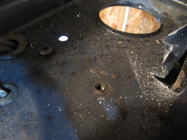

I'm gearing up to get moving again on this project. One of the issues I've had is the chuck-speed of my drill press. It has been just too fast for the hole cutting saws and a related issue has been that the motor it came with is simply "puny"!:grumpy: Sooo... as I threatened to do quite some time ago on another thread - rawinok2's mini dozer build -, I have made some modifications;). I considered posting this on his thread but decided against it in case that attracted unwelcome attention to what he has going on right now.
I have two drill presses like this so there is no need to retain the variable chuck speed capabilities on this one. First photo shows the step-down thing-a-mabob. Second photo you see the hidden components. Both the bearing and the short shaft are press-fit. Third one shows a conveniently positioned threaded hole where I'll bolt the thing-a-mabob into place. Fourth - the puny motor I swapped out for a 1/4 hp. That motor does not have a plate to identify brand nor power/rpm info. Hmm...:muttering: The last one shows the way it looks now with the changes and ready to drill. I've done a test hole with the 1.5" hole saw and although I can still stall it, I can easily control that. The chuck speed has dropped from 570 rpm - no load, to 320 rpm - no load. Load speed will be quite a bit less, of coarse, and that is just fine by me. I hope to put in some shop-time soon and get this machine a-diggin'!:thumbsup:
