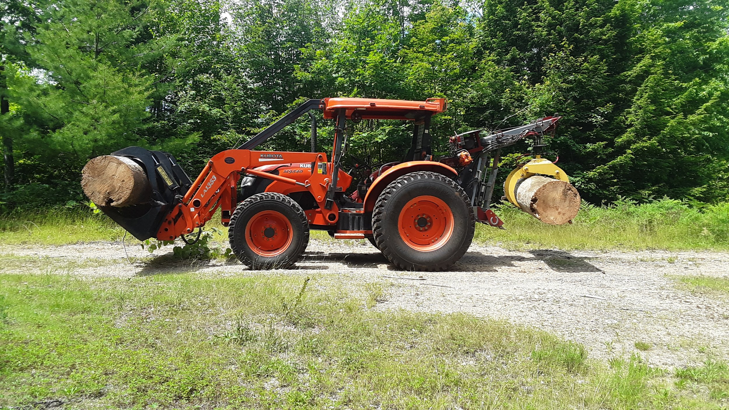

My contraption started out as basically an "arch" that would allow the butt end to be 3-4' off the ground. One thing led to another a I added a hydraulic winch and finally a grapple. I've got about the same money in it as a store bought winch but it suits me better. I'm only thinning for boiler wood, the big wood was removed years ago.
This was a big old standing dead pine that I wanted to see if there's anything left on the inside for the sawmill.

That photo is exactly what I was looking for! Thinking outside the box, looking at other peoples designs, then building/modifying for my personal use.
Please pardon my snappy response earlier. Bad Lyme morning and I get cranky when I hurt.
Thanks for the ideas RI. I'm over near Gardiner, but they still let me wander...

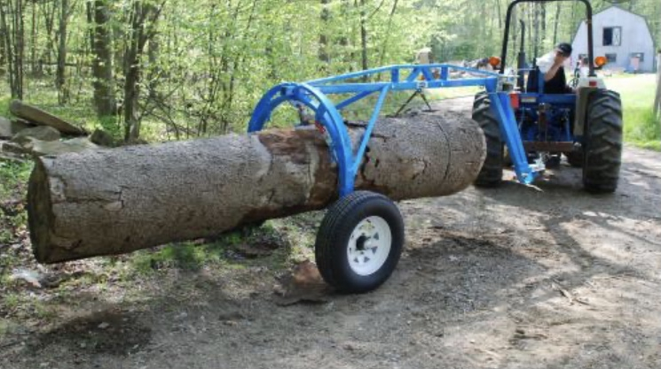

I built a log arch many years ago, and used it behind a small Case tractor to move a lot of wood. I put a hand winch on the front of it with a pulley directly over the axles in order to winch and lift the logs off the ground. It had a chain to secure the log for transit to take the load off the winch itself.
The winch was a cheap harbor freight version which broke after a fair bit of use.
I no longer use the arch. It worked well for what it was, but there are much better ways.
Since then I bought a used logging grapple for less than I could possibly build one for.
I think a good alternative to a full blown logging grapple, would be a simple 3 point frame similar to mine, with just a set of logging tongs hanging from a chain.
