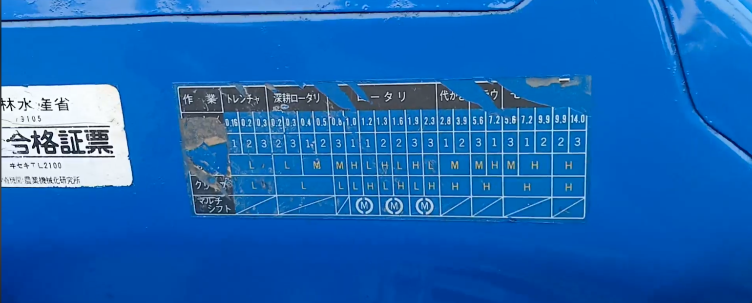

Hi, I need someone who tells me what the heck is in this pic. Thanks a lot! The translator is useless because of the missing parts. What is "L", "M", "H", "(M)" (low-high-middle?) Unfortunately the shifting sticker is in bad condition, cannot read a thing.

That is a chart with the travel speeds for your tractor given what gear and range it is. And looks like you got the 18 speed transmission by the looks of it.
1-2-3 are the main gears, L-M-H are your ranges.
L = Low range
M = Medium range
H = High range.
There could be another lever for the creeper gears, accordingly to the chart.

Edited the picture for you.
Let's say you want to go 2.3 km/h. You would put the main gear in "3", range gear in "Low" and creeper gear in "High".

I translated the last row text. The row with the (M) (M) (M) markings. This has me very curious what this does.
I did the same and noticed it as well. I didn't mentioned it to avoid confusion.
TractorData only lists two transmissions for that model but I wonder if there could be some other transmission option for it? Googling "Iseki Multi Shift" didn't bring much useful info.
Ah, you too Googled. Yep, we have not a clue. If it was a Yanmar, I would say, oh, that's just the PowerShift.
We would need someone with an Iseki-Mitsubishi setup to chime in on this one.
