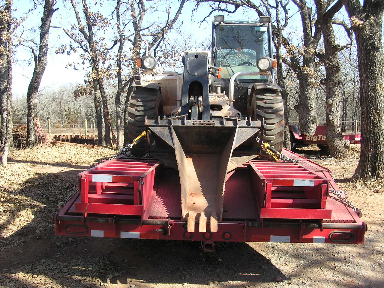

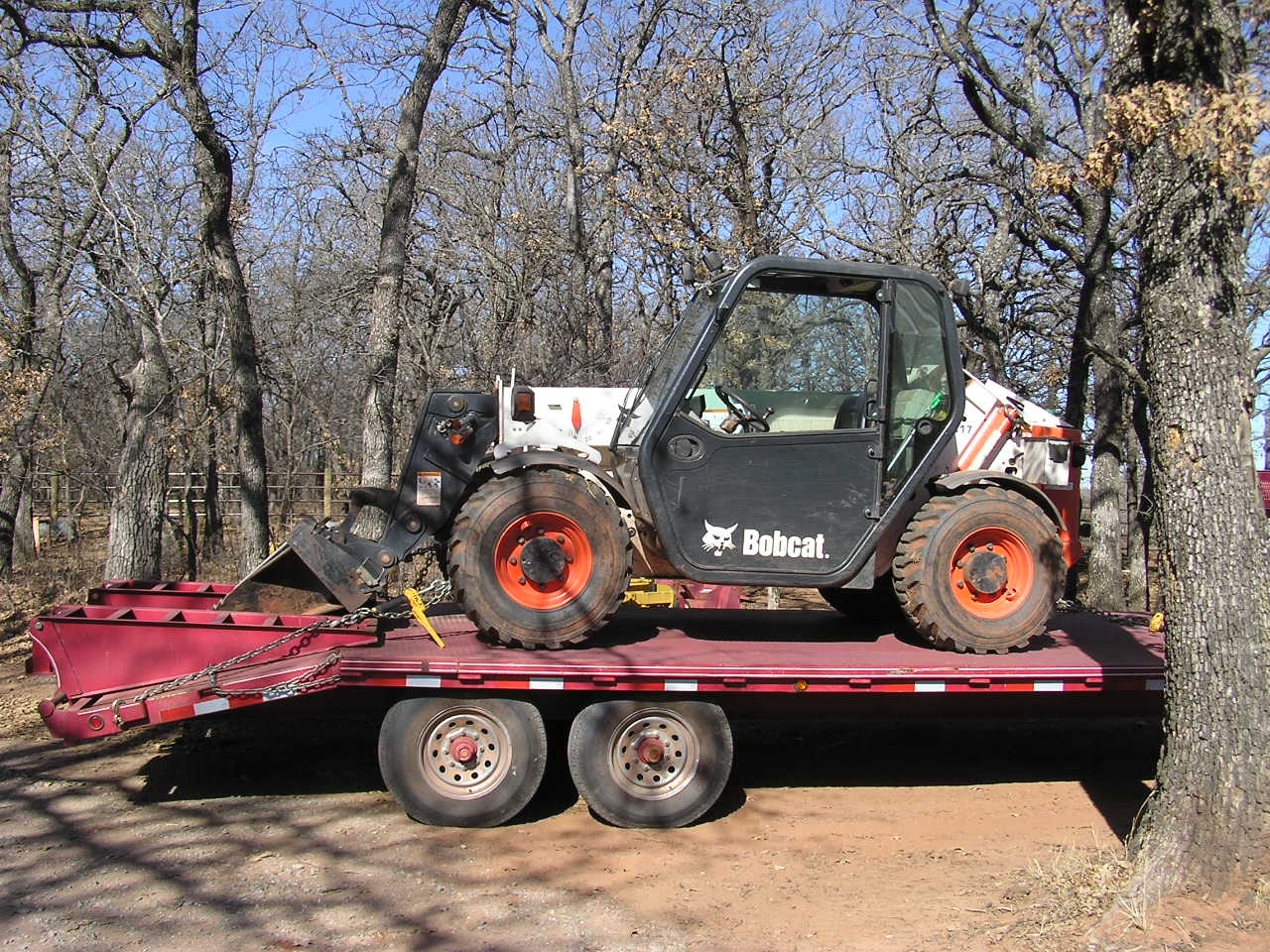

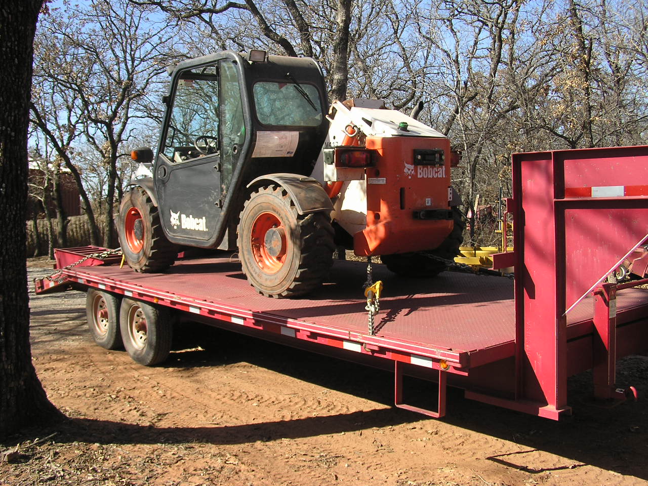

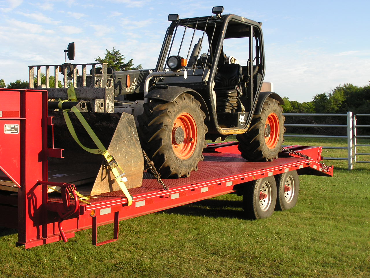

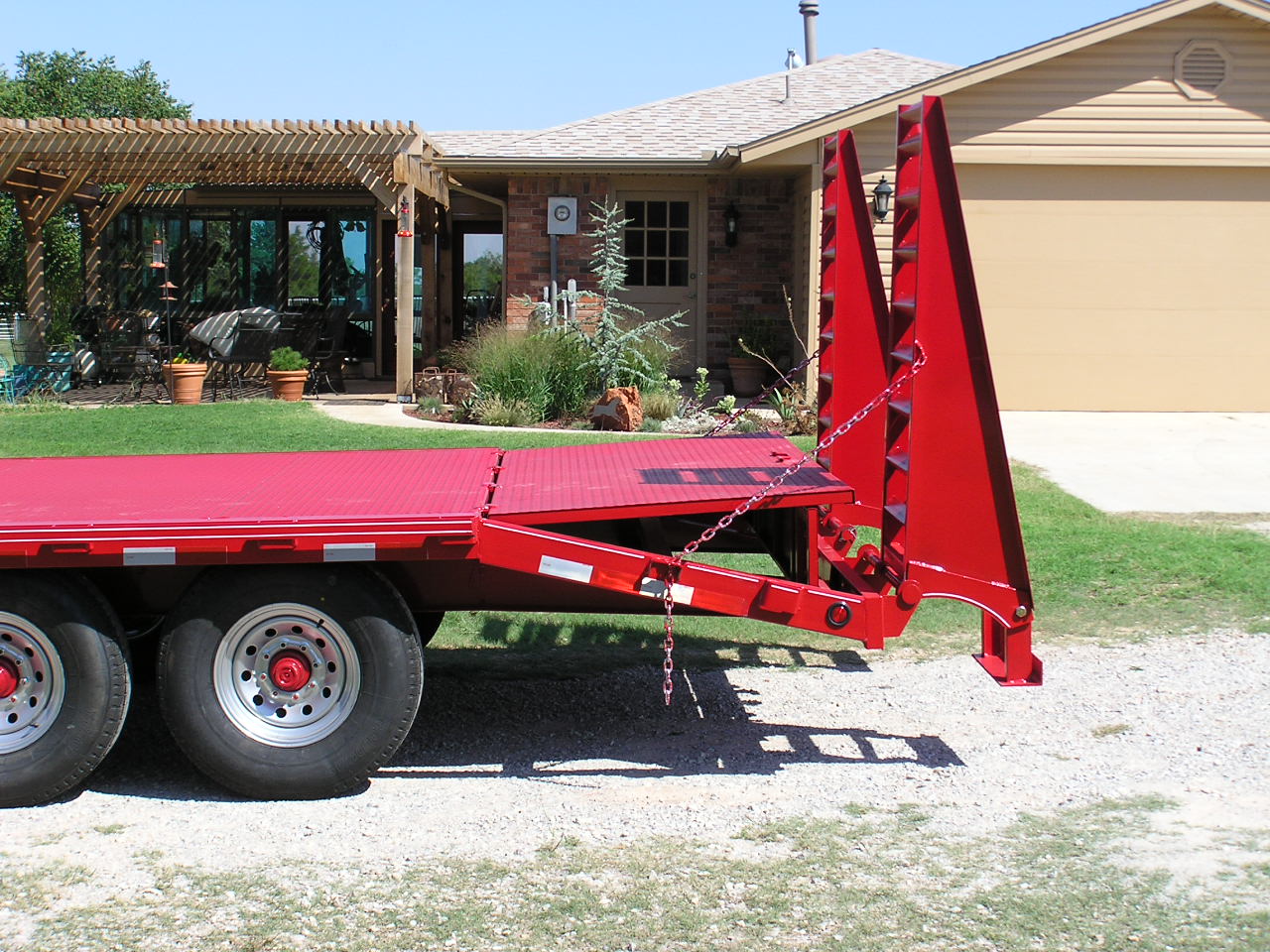

My 2006 2500HD GMC Duramax weighs 7300 pounds, front axle is 4100, rear axle is 3200. 14K trailer is 18' plus 4' pop-up dovetail and a metal deck. Empty weigh is 5000 pounds, 1000 on the ball, 4000 on the axles
This is the heaviest load that I have pulled. I would not want to pull it on a equivalent sized BP.

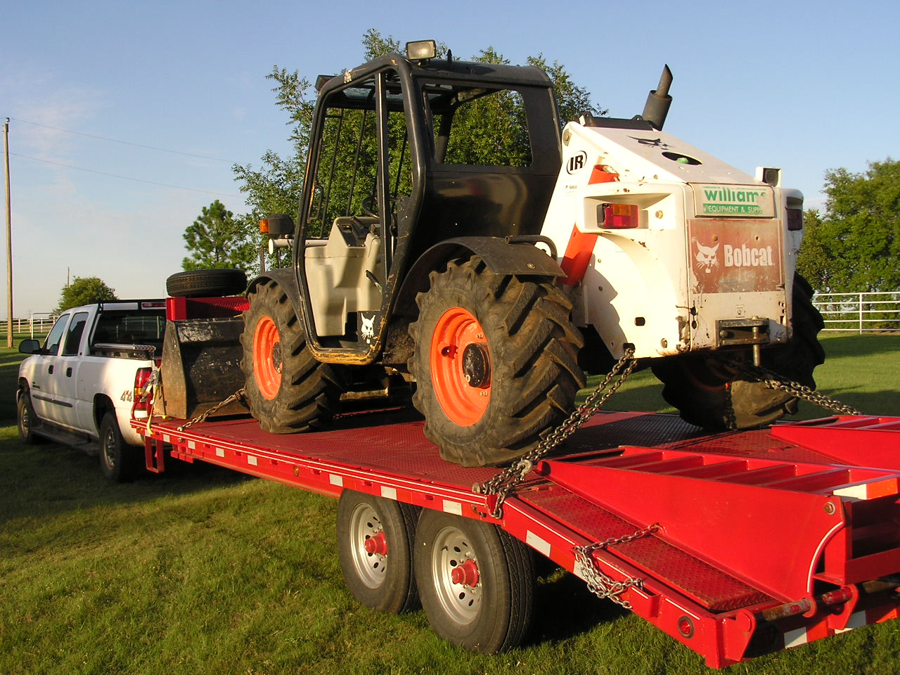

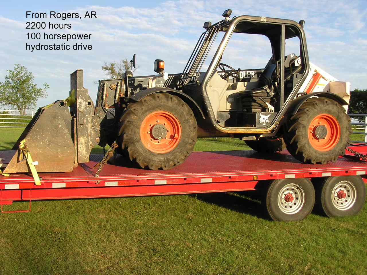

Went across the scale at 24,940 total, truck and trailer. 12,640 on the deck, 3,440 on the ball, 14,200 on the axles.
Still had 4' of usable deck space left 👍

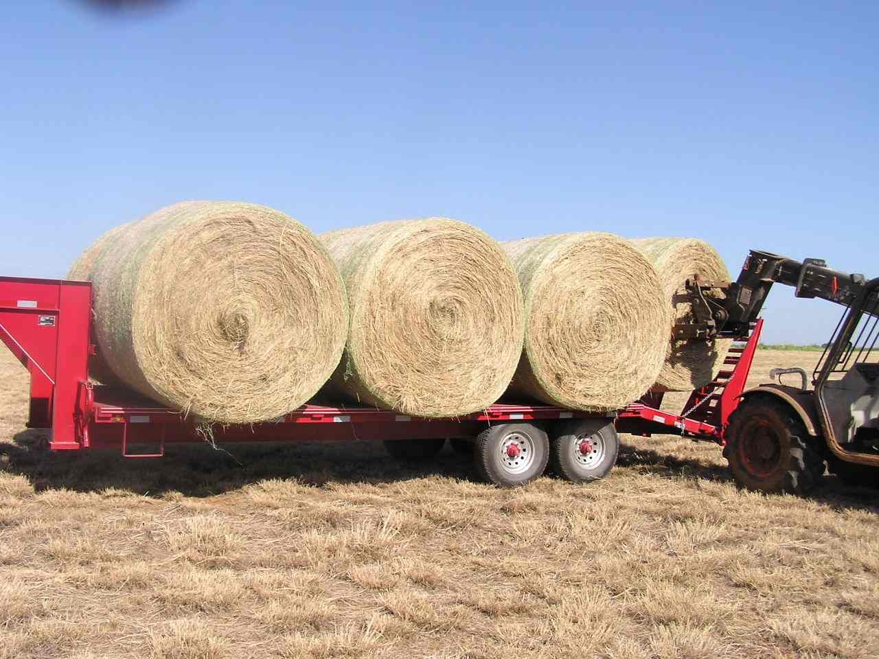

I started many years ago with BP trailers, worked up to 20', then went to a 20' low deck GN, then got this 18' plus 4' Pop-Up in 2006. See no reason for me to go back to BP.
