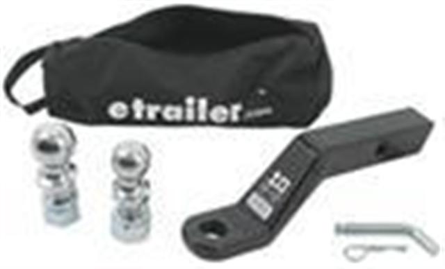

If it were me, I would start with one of these, View attachment 327641 rated at least 16K.
With your 1 ton you might not need a WD hitch.
I'm a big fan of WD systems, and the heavier the load, the more I like them. But they're not cheap, and if the hitch said it was rated to tow full load without a WD system, I might be tempted.
