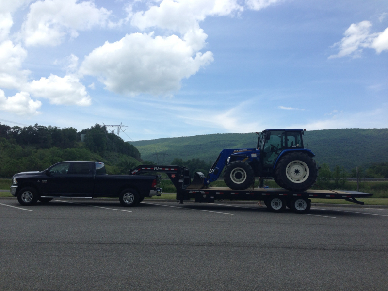

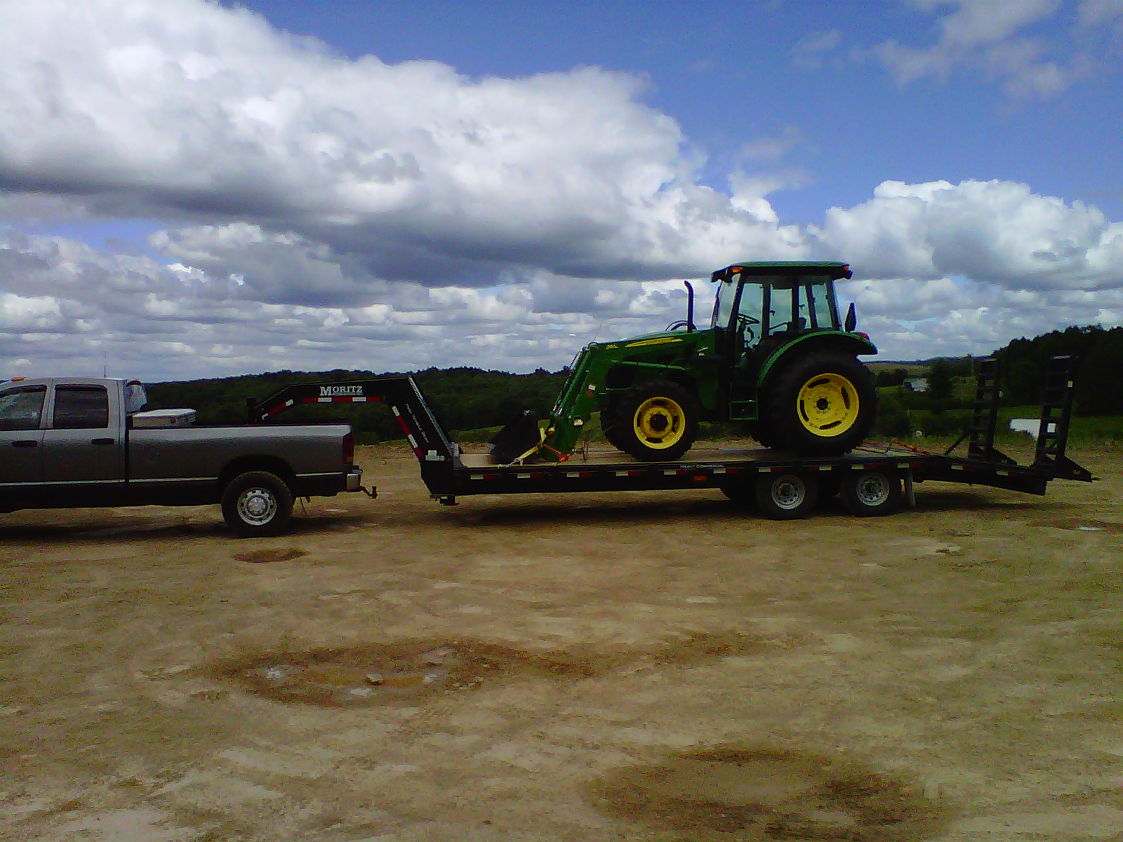

Best trailer I have ever had it is so versatile. I've hauled my mustang on it and my 1971 f350 dump truck on it.
/ Tilt Bed - bumper pull or gooseneck?
is that a PJ T9 trailer?
What axles do you have under it?
D.
/ Tilt Bed - bumper pull or gooseneck? #5
D.
Yes it is a pj T9 but I had the whole deck tilt. I didn't like any fixed floor. It has two 7,000 lb axels. It is also powder coated I am very pleased how well the finish is holding up so far.
