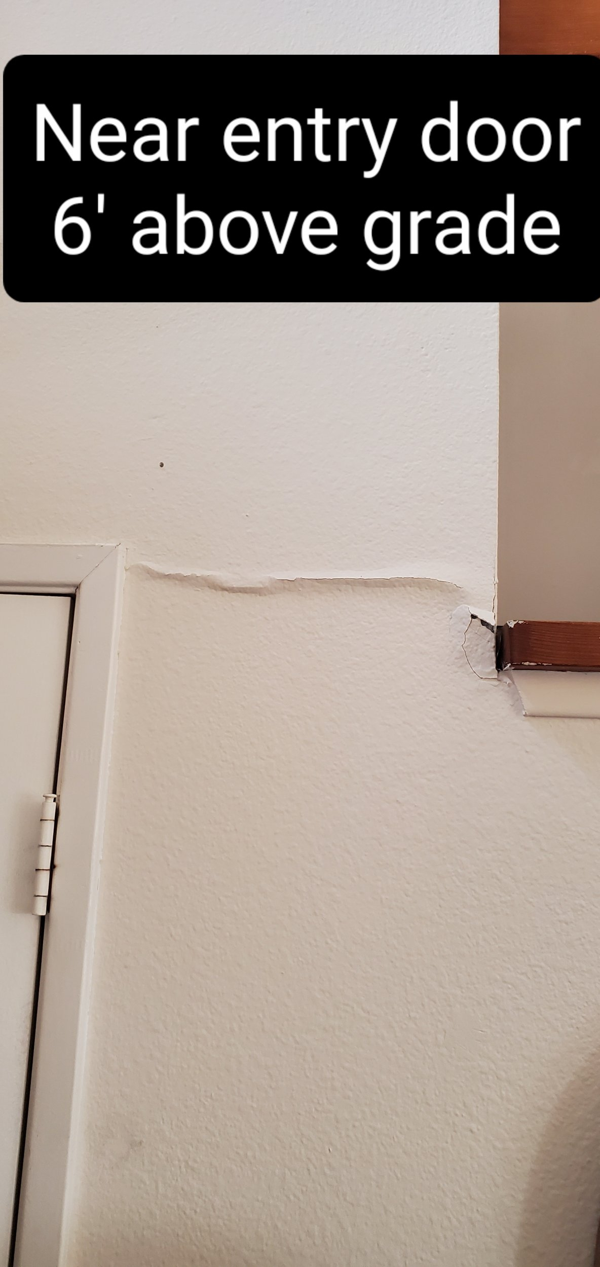

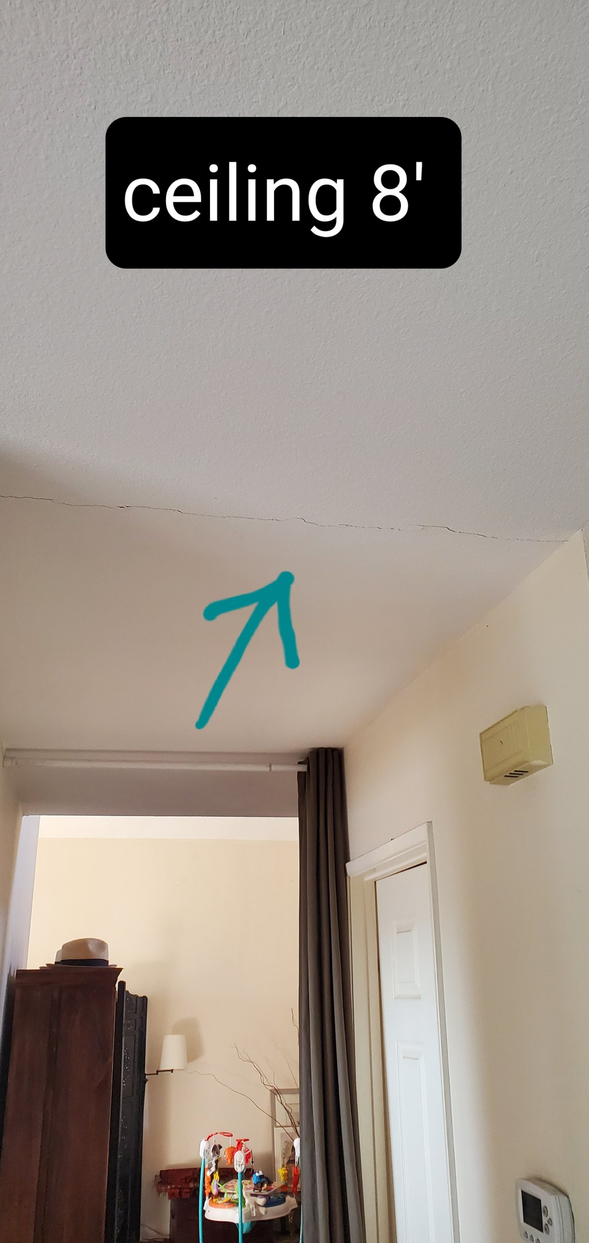

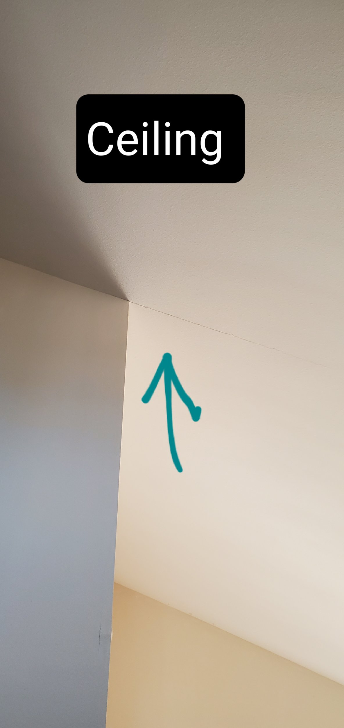

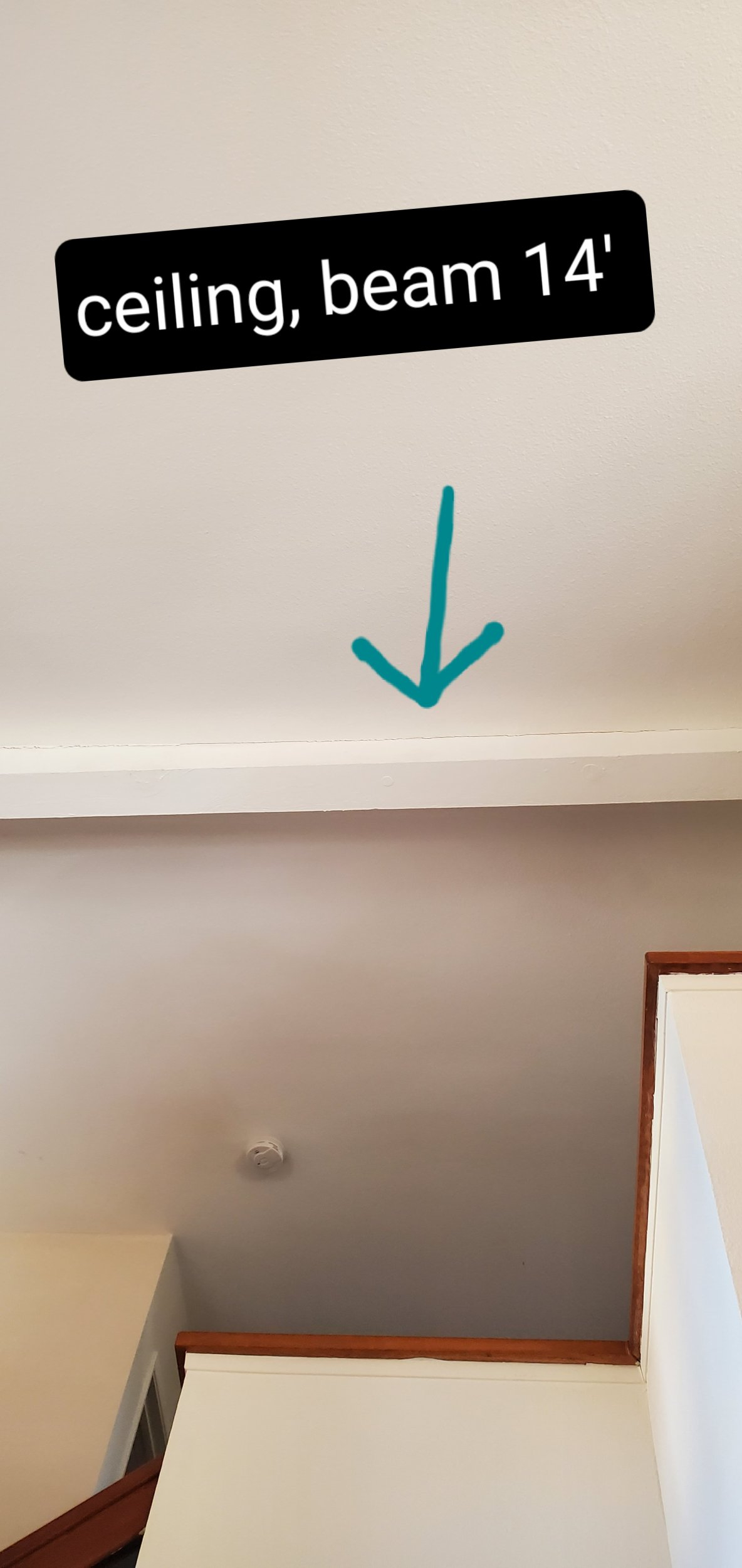

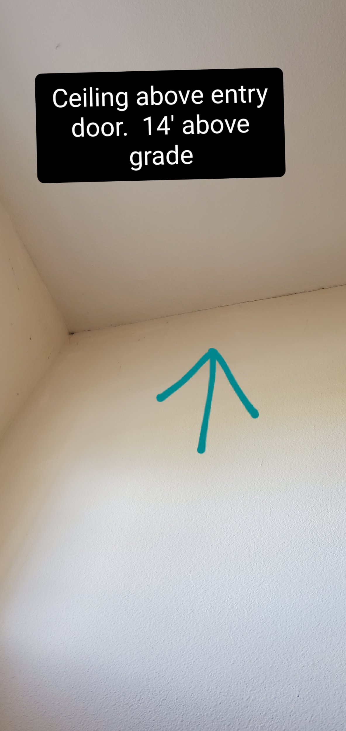

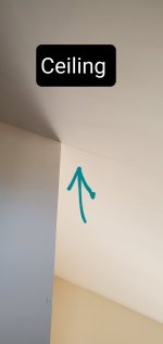

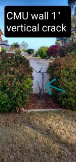

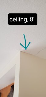

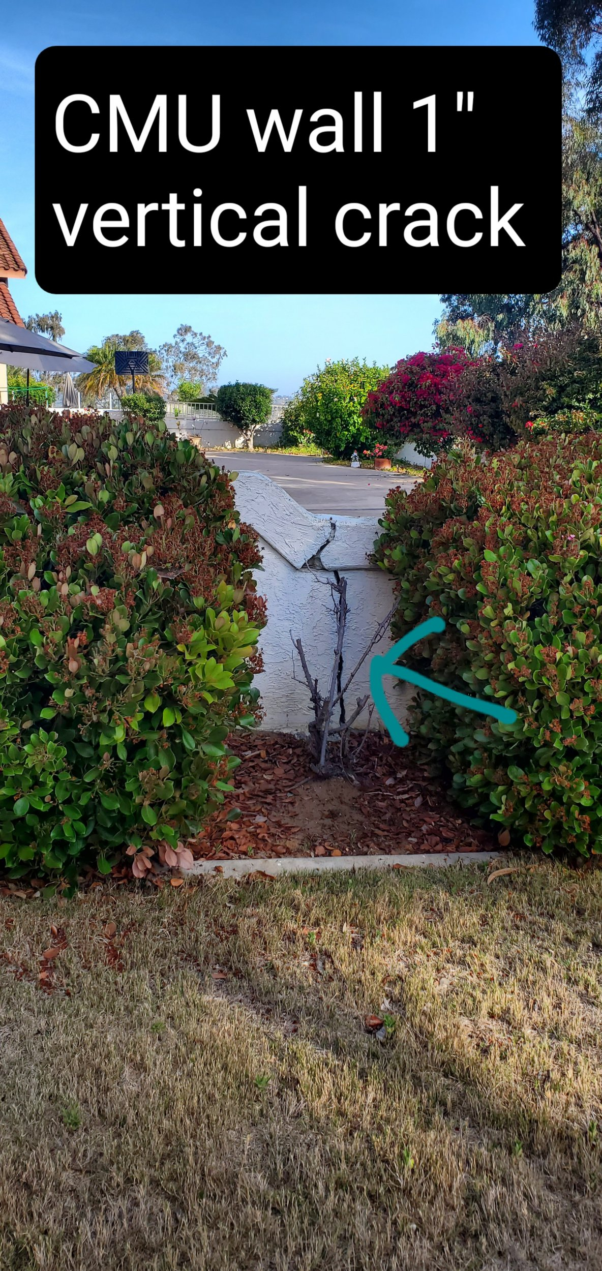

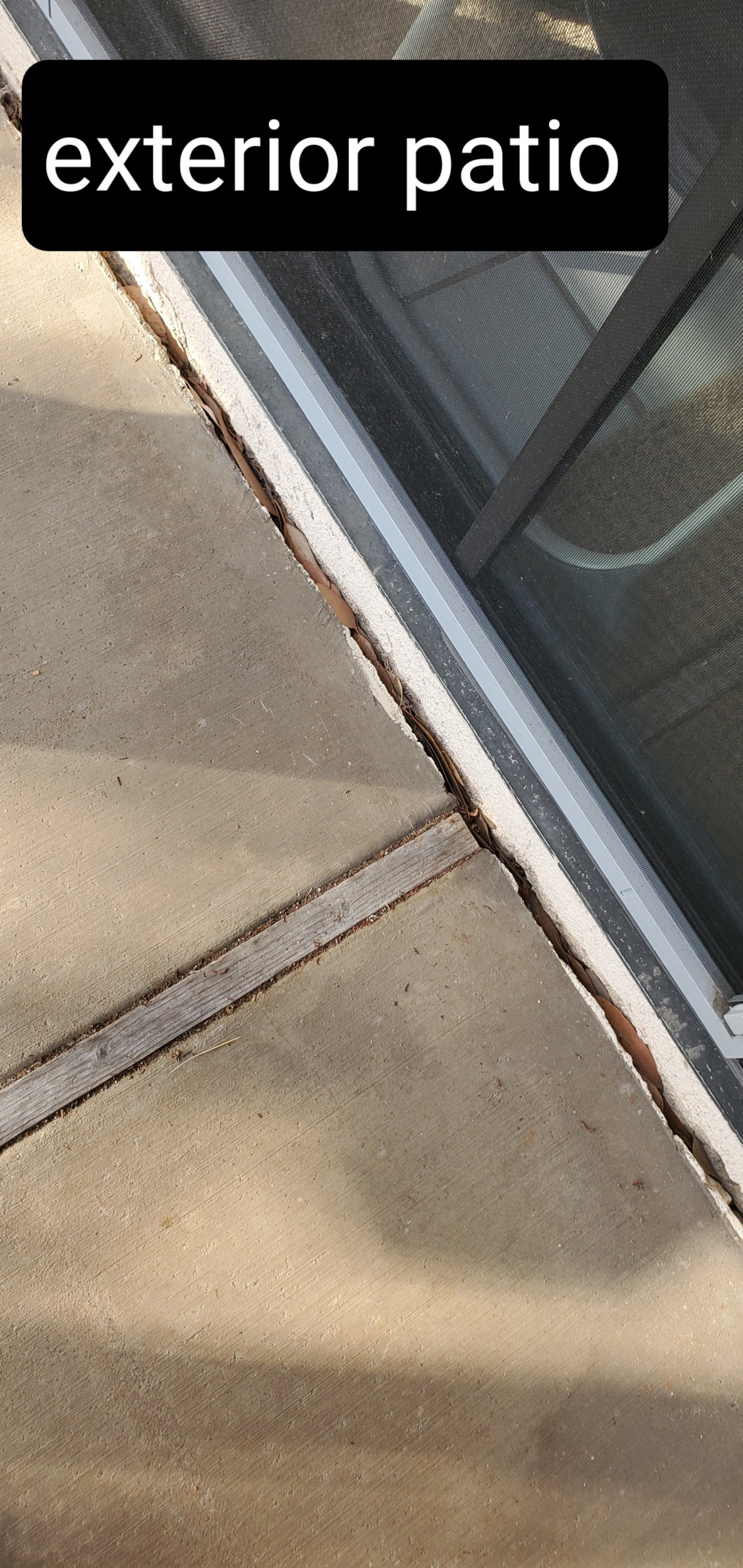

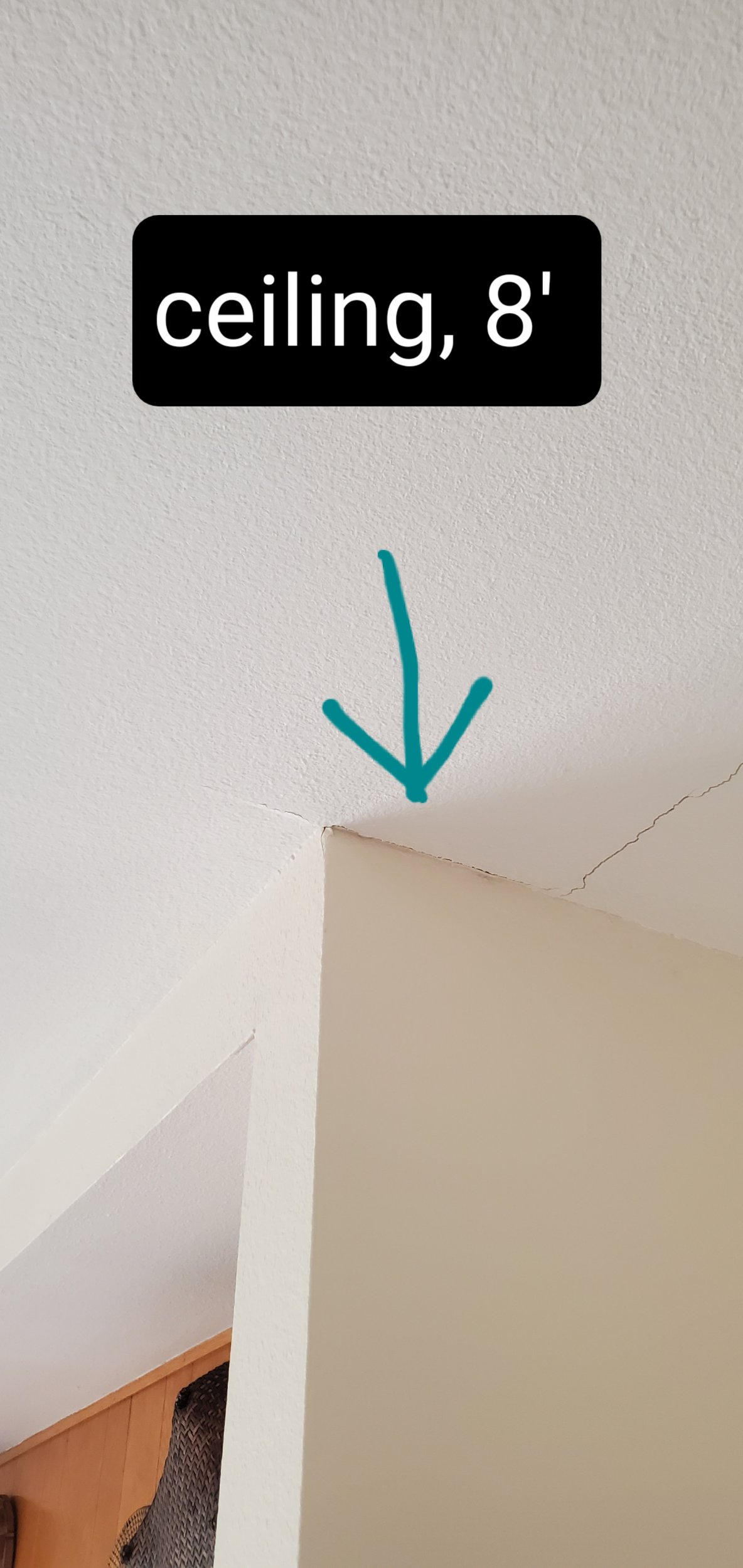

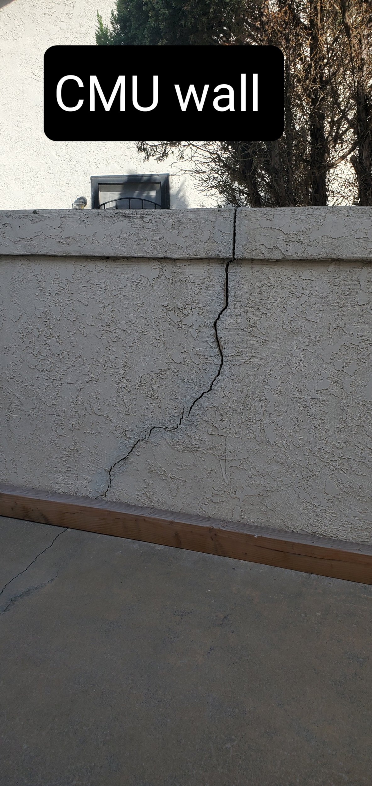

The house my parents are renting for the past three years in San Diego has developed numerous cracks in the sheetrock over the past three years. None of these interior cracks were present there years ago. The patio pulling away from the house and one of the cmu cracks were present 3 years ago.
The house sits on a flat concrete pad about 25' from a 70' embankment. It's pretty obvious that the answer to my question in the title is YES. But the follow up is... how bad is it now and what can be done? What's the end game timeline with these early warning signs?

I worked some of my career as a Structural Geologist, and much of what your showing in your photos is indeed related more to local geologic activity and instability, probably slumping, rather than a simple foundation issue.
This makes sense, as most of western California shows active tectonics, and quite often this creates local faults in the subsurface, which over time will affect homes built on the surface. In a few years, plumbing breaks will show up. I am sure, this geologic stress you are seeing affecting your rental home, is impacting the entire neighborhood. This will continue to just get worse over time, until catastrophic failure occurs at some future date.
So drive around the block visually looking at the neighborhood, and also check google earth at this location, to see if you can see affects beyond this house.

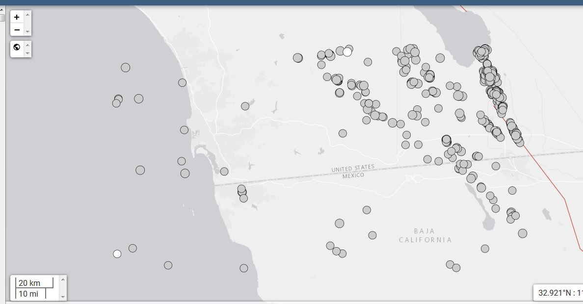

541 Earthquakes 2.5M or over since 1-1-15:
Latest Earthquakes{%22name%22:%22Search%20Results%22,%22params%22:{%22starttime%22:%222015-01-01%2000:00:00%22,%22endtime%22:%222021-05-25%2023:59:59%22,%22maxlatitude%22:33.18,%22minlatitude%22:32.135,%22maxlongitude%22:-115.4,%22minlongitude%22:-117.675,%22minmagnitude%22:2.5,%22orderby%22:%22time%22}}

More movement then most houses, but it doesn't look like panic time yet. Probably never.

The cracks all look like areas that should have been built better, and would be if the house was built today. Code, especially there, has dramatically changed, and any house built in the 80's wouldn't come close to passing Code today.

But I don't think the age of the house or the foundation is a significant issue. In fact, the stress on the home and associated damage continues on outside the home, well into property line fences and walls. Personally, I would encourage your parents to have a relocation plan over the next 2-3 years. And any plumbing failures should rapidly accelerate that relocation plan.

I guess that's my thinking as well... they've got a lease renewal coming up so I guess they can push it one more year. If the pipes are running through the slab (most from the 80s are, around here) then it's only a matter of time for a slab leak and those aren't much fun to deal with.
