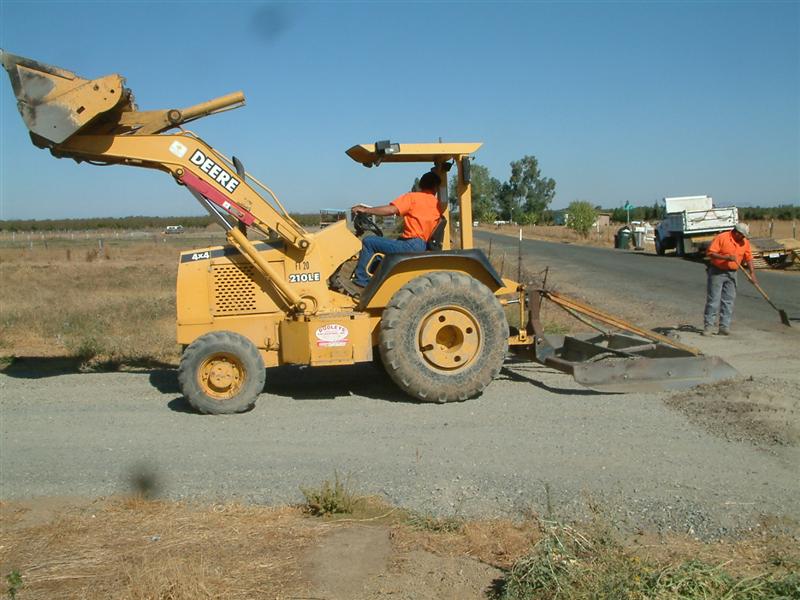

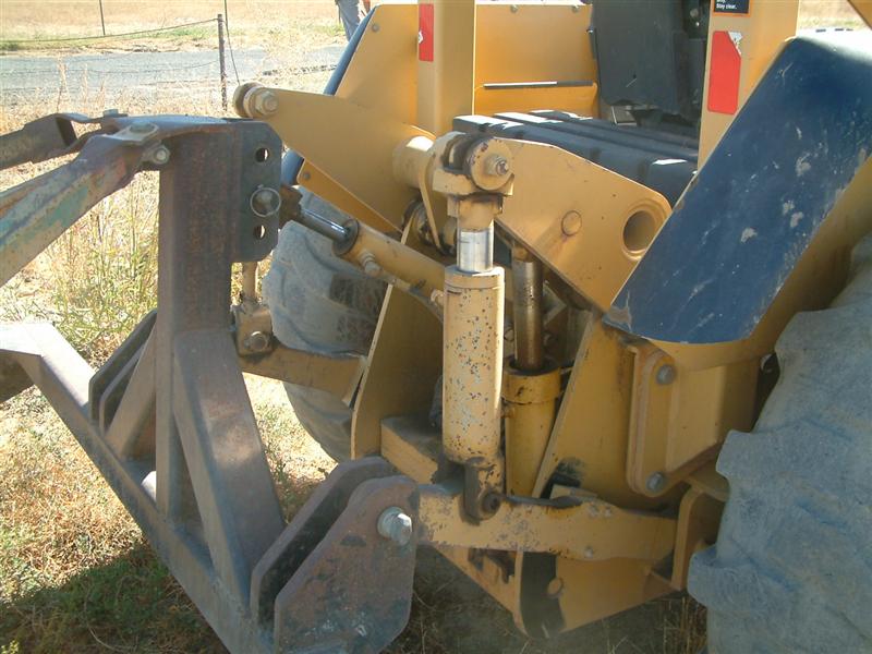

They're a few years old, but I believe still a current model. (414E) My employer has a couple Cat industrial loader tractors with hydraulic pressure hitches. I'm fairly certain Case offers the same.
/ Is there a way NOT to float the 3ph #10
Like this JD industrial tractor, I suppose.
