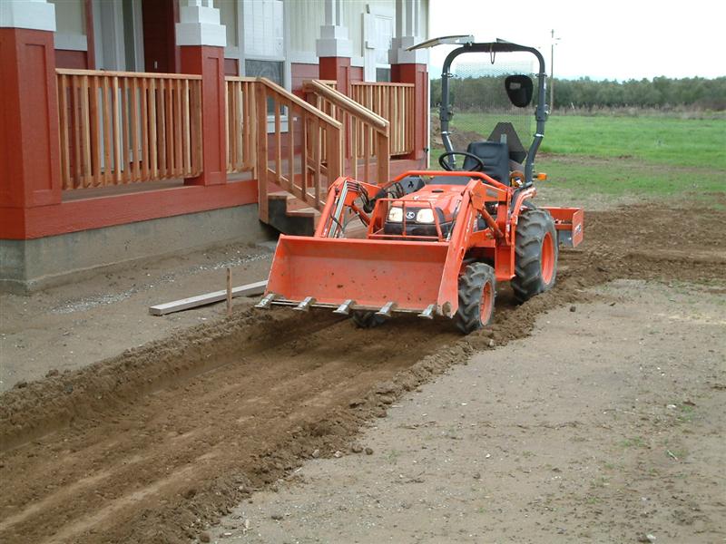

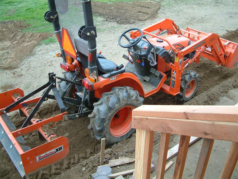

I have teeth on the 4-ft bucket on my B7510HST but rarely use them to dig in undisturbed soil. Much better to use a plow, rototiller, middle buster or box blade to loosen the soil and then use the FEL to scoop it out. Here's a few shots of the excavation for a paver block walkway in front of my house done that way.

Nice screening on your ROPS, Flusher
