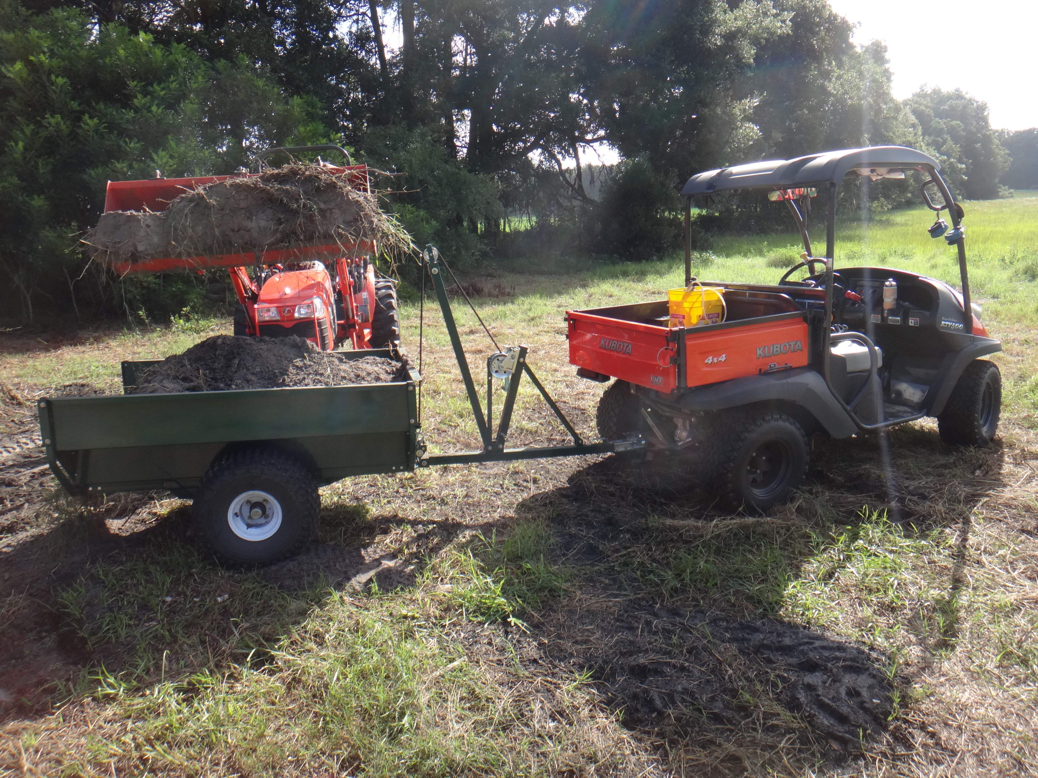

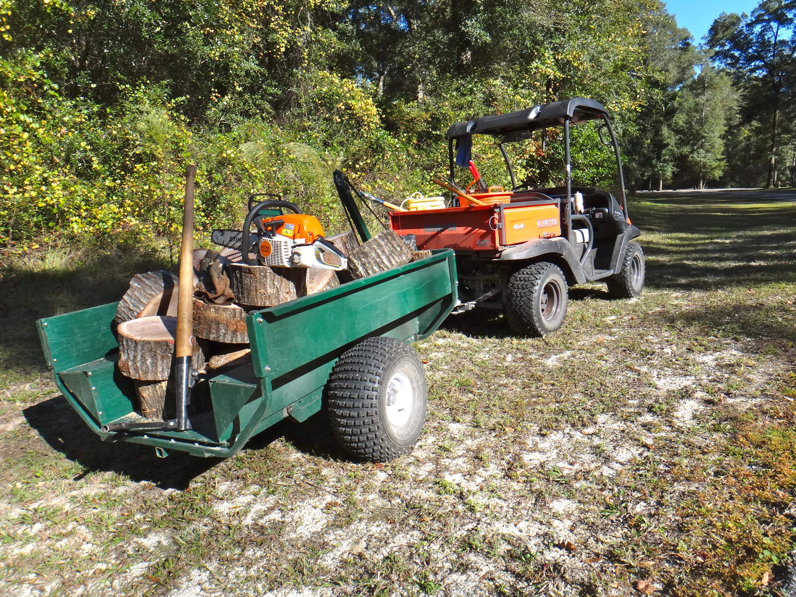

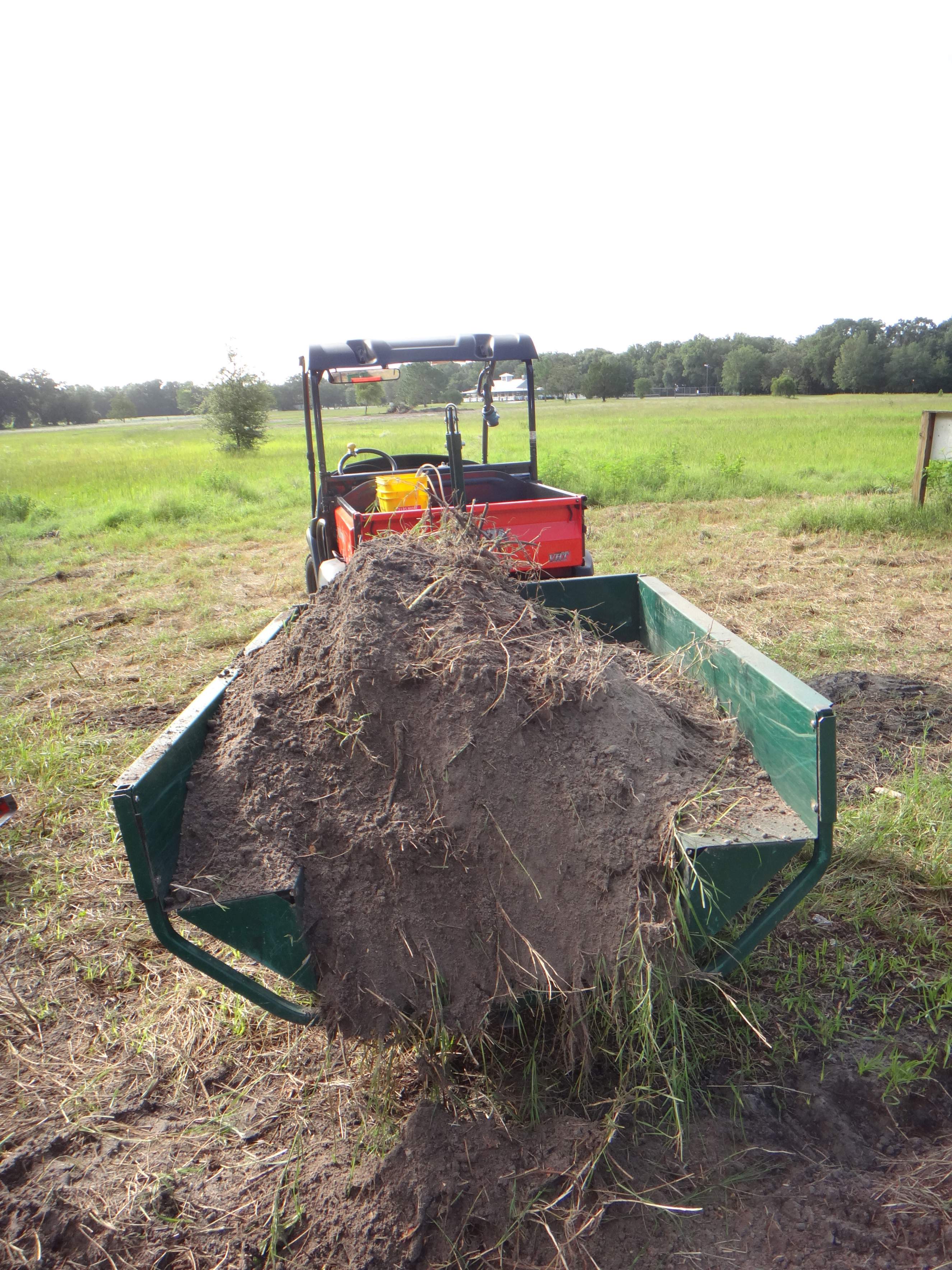

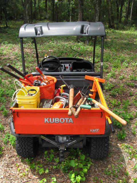

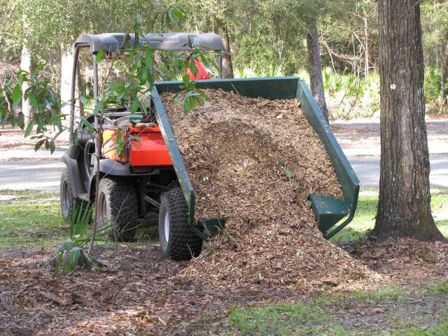

How frequently do you mount implements on the Three Point Hitch of your current tractor?
Have you considered a Utility Vehicle and all terrain dumping trailer as partners for your current tractor, rather than trading in?
TRAILER LINK: MUTS - Multi-Use Trailer System for your ATV, Quad and 4 Wheeler - Welcome
