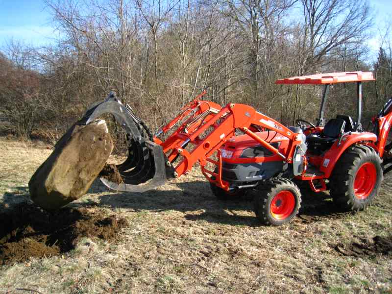

If that last 400lbs of pellets is the only real problem with the loader, why not consider putting on slightly larger hydraulic rams? It would slow down the loader a bit but should increase your lift capacity. Not a cheapo solution but cheaper than replacing the whole tractor if that last 400lbs is really the only issue.
Also, can you curl the load off the truck bed and then slide it off? The loader should easily be able to handle holding the load while you move it. If it cannot curl or "breakout" (curl plus lift) the 2000lb load to pivot then I guess I don't understand how breakout is measured. It should be able to breakout something like 3700lbs at pivot pins when flat. Could you build a ramp so the loader is "flat" on the pickup bed before lifting/curling?
The granite rock in the photos was pulled out of the ground while in the tips of my grapple by curling and lifting. It measures at 12cu/ft and that makes it just over one ton. It is about 3.5 feet (on center) from the pivot pins. I could pull it out of the ground (additional resistance) without too much trouble at all but it surely wasn't lifting very quickly after I got to this level. If your tractor was elevated on some sort of dock/ramp you might have better mechanical leverage with the loader.

I disagree, I have lifted a least 2600lbs lbs of 6x6x8 logs. The trick is to curl as soon as you can since that puts weight back towards the pins, then lift. I still think he has a over-pressure valve or pump adjustment in order.

We'll see what he says but I'm thinking it has to do with where he is starting to lift. Lifting from the back of a pickup compared to from the ground is a big mechanical disadvantage. I totally believe you can lift 2600lbs in logs and curling first is exactly what I do with heavy loads.
