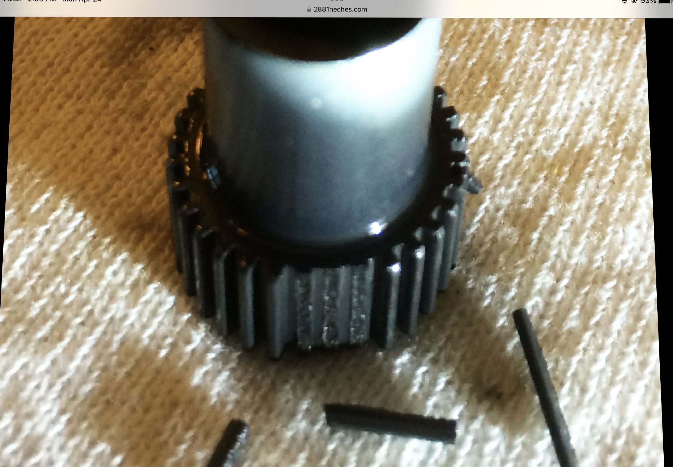

We have a 2005 CK25HST with 1,200 plus hrs. Only problem was with the IP twice sec
Second time replaced the gears in the pump, so far so good! It’s a work horse 👍🏻☮️✌🏻

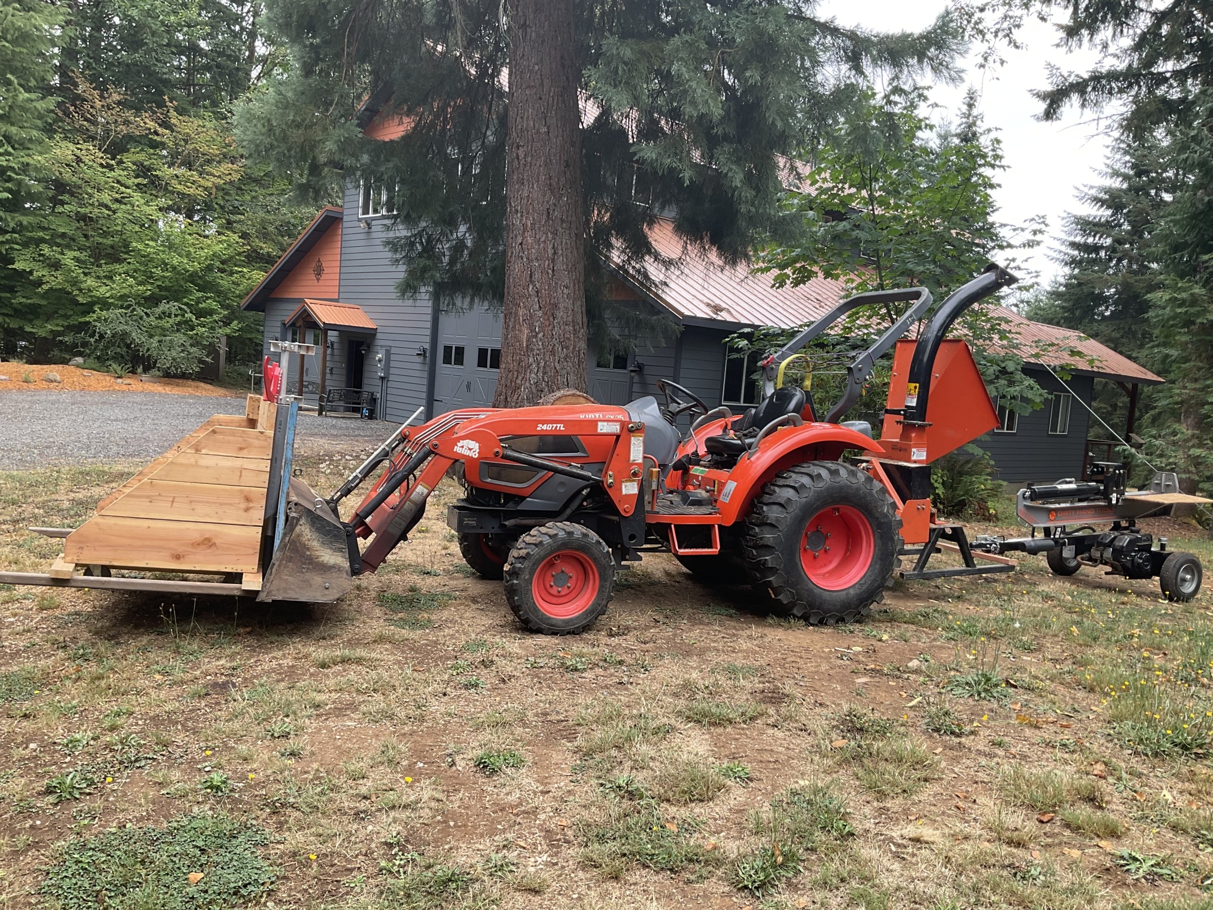

   / Add this to the list of reasons I’m going to sell my Kioti #43
I paid for the fender. The Attachment shouldn’t collide or interfere with the tractor. It was sold by the Kioti dealer. I didn’t buy it aftermarket.
The tractor is supposed to know what you have attached and limit the lift accordingly?
What if another accessory could make good use of the added lift, so Kioti provided it? Without, you would complain using that accessory of not being able to lift high enough.
Would be nice if an adjustable lift limiter was available that when one attaches something it could be lifted to the max and the limiter set accordingly. Ideally in-cab.
   / Add this to the list of reasons I’m going to sell my Kioti #44
I'm thinking my old 1999 Kubota has limiters you can set on the 3 point hitch control, both up and down. I've never used them though.
   / Add this to the list of reasons I’m going to sell my Kioti #45
There are set-screws/knobs that one can install to limit 3pt lever travel. I bought an extra one just to make sure that IF I bought a CAT2 quick hitch that I could use it to set a safe stop point. In the Kioti Operating forum there's user Eric and he documented this issue many years ago.

Installing a quick hitch with a shortened top link can mangle fenders and more on many tractors
