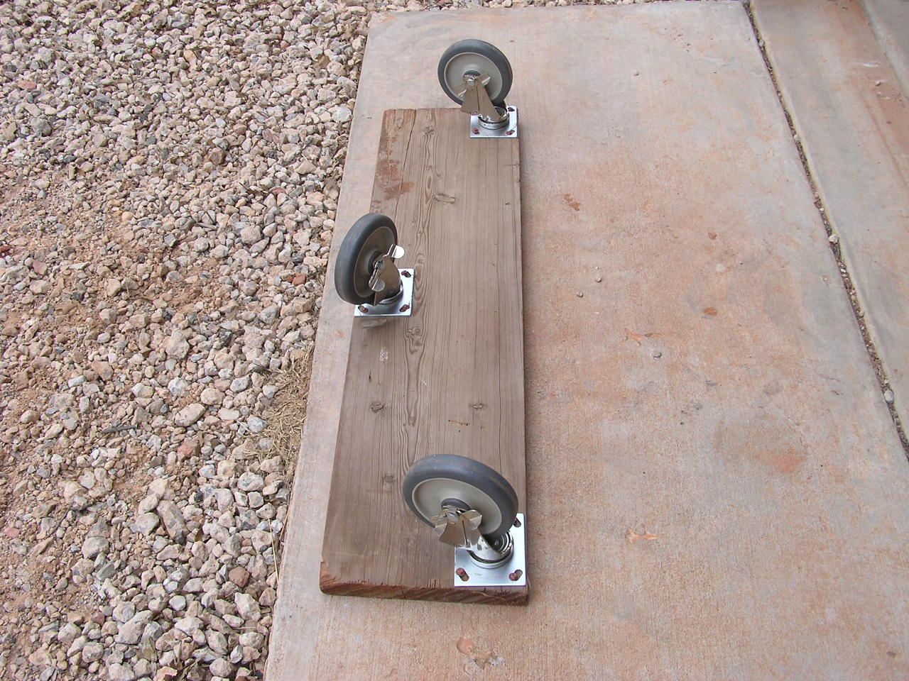

I'm 72 and need to have every implement (except the light weight rear blade) on dollies or castors. Of course, you need a concrete pad or building with concrete floors to place everything. Makes it a whole lot easier.
Ralph
The best improvement I ever did to my place was a concrete floor for the barn. Should have done that from the start. I built dollies for everything, and I tried the quick hitch and Pats. But with the dollies and smooth floor, I really don't need them.

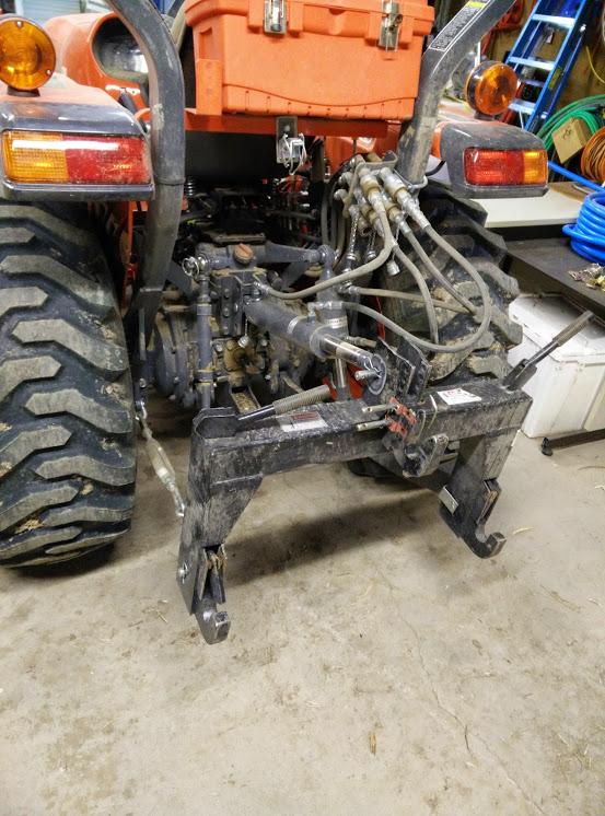

Yep I even have my SSQA attachments on dollies.
An old 2x12.
SSQA to 3 point adapter, with the Omni hitch on it.

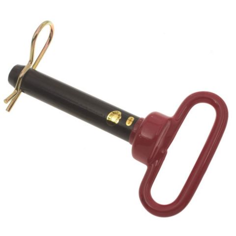

I would have replaced those headless pins immediately with a hitch pin of the right size, with a handle.
I would but look at the first pic again. These have a shoulder or step down. Where the lift arm connects is larger than the end the linch pin goes on. It is a very silly design IMO.

I would have replaced those headless pins immediately with a hitch pin of the right size, with a handle. They come in many sizes. For example: GRAINGER APPROVED VENDOR Hitch Pin,Std,Stl,Zinc,1x7 3'/'4 L - Hitch Pins - 3HLR5'|'3HLR5 - Grainger Industrial Supply Bruce
Bruce, those are CAT 1 / CAT 2 pins with two different diameters. Have the same on my Bush Hog 3008 cutter.
If you raise or lower 3 point just slightly you can get pressure off of the pin and it will rotate and can be easily removed. Repeat on other side. Takes a minute or two at most.
