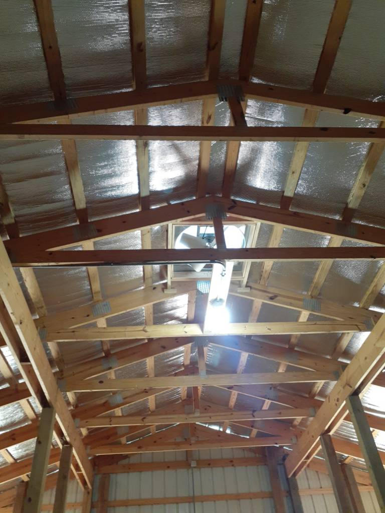

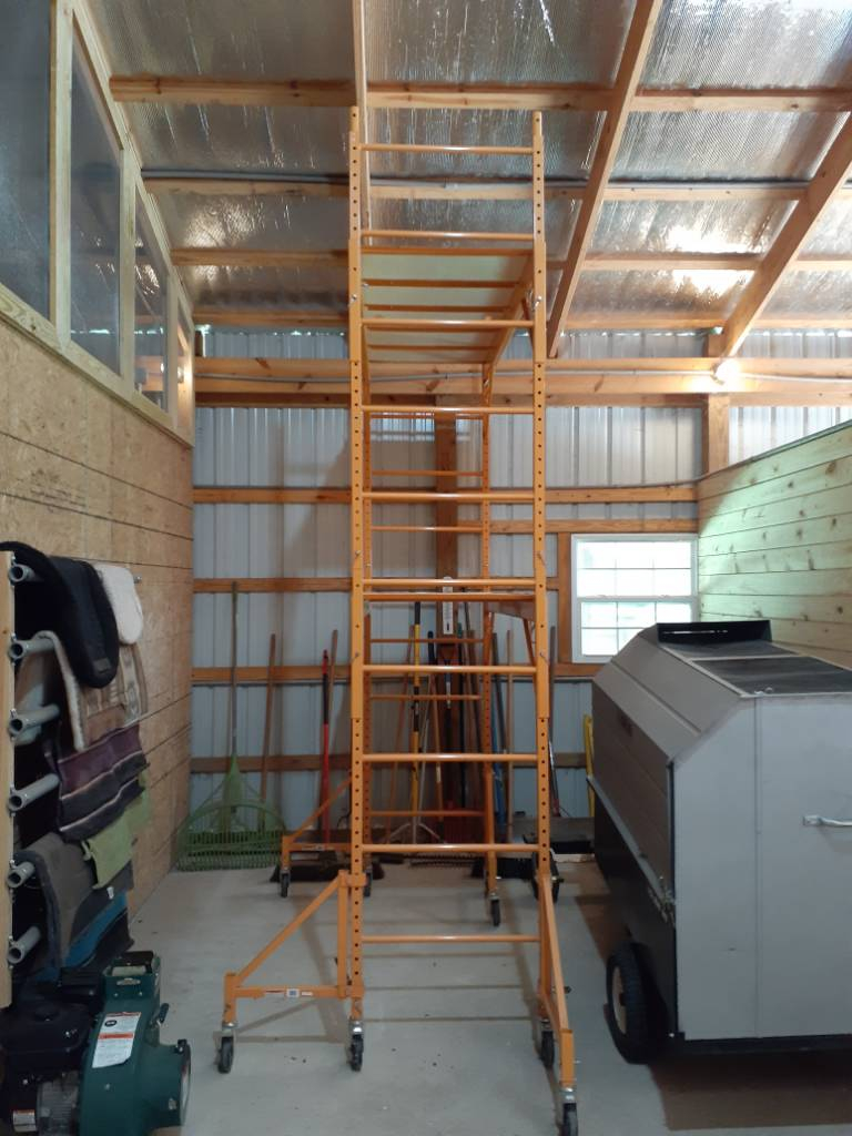

I'm late seeing this scaffolding post, but for our new horse stable I bought scaffolding because I had lots of projects, lights, fan, etc.
I also bought stabilizer outrigger wheels that can easily be adjusted (out,in,sideways). Of all places I bought mine from Walmart online.
It's 24 feet up to the fan, base of roof cupola.
Floor is level concrete, I don't know how it would work outside on grass, I don't think it would well unless it was on level, probably on plywood.
For me it's worked well even with two 220# guys working on top platform.

View attachment 758764View attachment 758765
I like those folding outriggers - something else to look for! 😁👍
