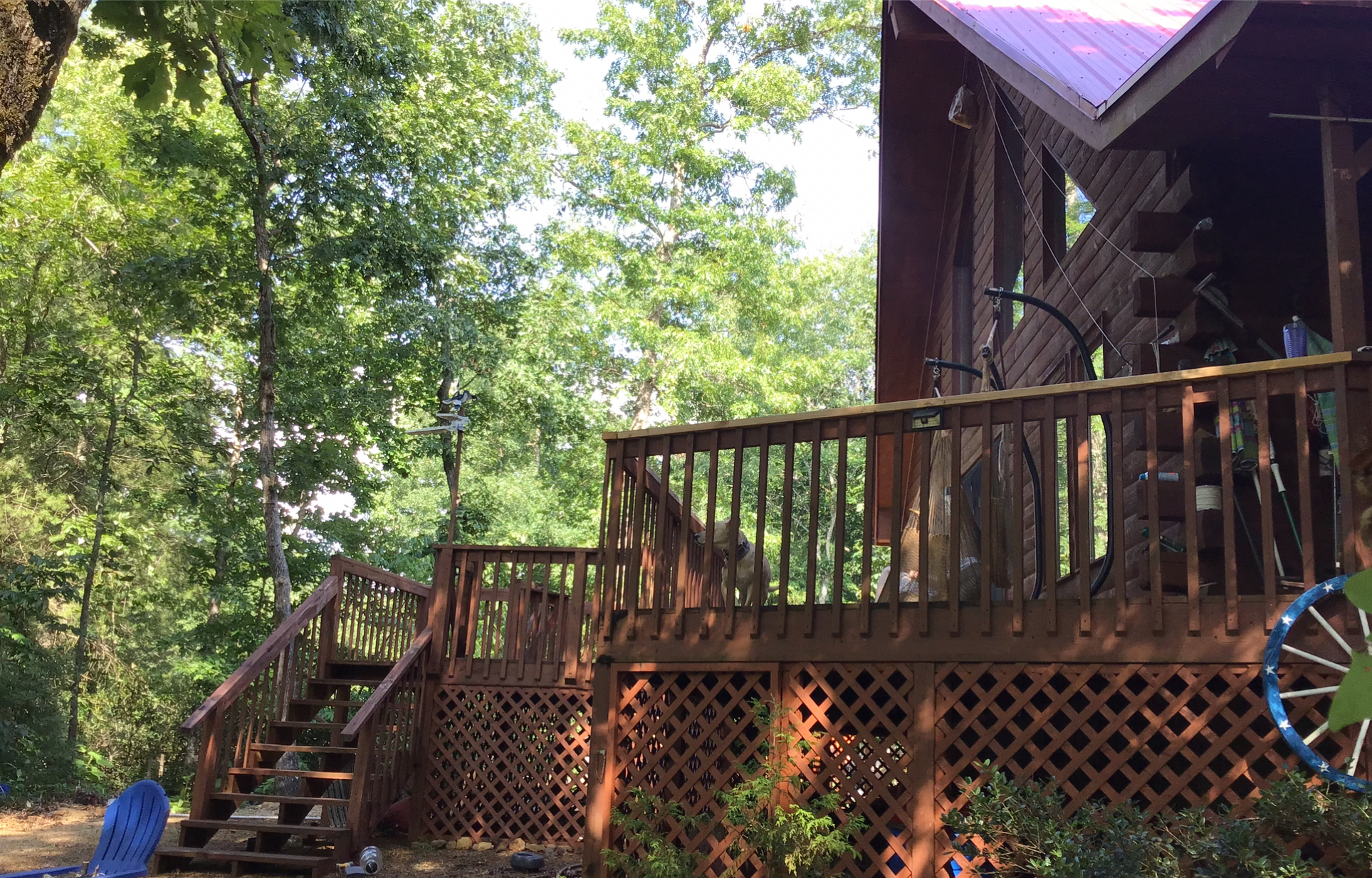

I will have to do some major home improvement projects, most notably re-staining/sealing our log home, and I don’t want to do it on a ladder. A scaffold (or two) would make for a much easier and safer job.
I have never used scaffolding before.
-EDIT/UPDATE: Terrain and deck preclude the use of a manlift or skyjack.-
My feet need to be 18’ to 20’ above grade level to be able to access all the way to the peak of the roof.
I plan on permanently attaching eyes to the sides of the house in order to rig guys to the scaffold for stability.
What do I need to know when buying scaffolding? There are so many options. I don’t want to rent, because I will have other projects in the future where it will be used, and if I own it, I won’t feel rushed to get it back to the tool rental and maybe screw up or get careless.

As with anything else, there are varying grades at varying prices.
I pickled up two of the six foot units commonly available at Harbor Freight, Tractor Supply, Northern Tool and similar places. They work fine for me, but they're a bit heavy to move around and assemble/disassemble. They can be a bit rickety and I found the need to tie them off to something solid. They are made to be able to be stacked for more height and outriggers sets and safety rails are available.
There are far larger and more stable commercial style units, but the cost is higher too. Because of their size, I'm not sure I'd want to try and set them up alone.

Go rent a portable 1 man lift. A few hundred $$ a week, (probably less than what you'd pay for 20' high scaffolding) and you can probably cover the entire side of the house without leaving the bucket/cage on the lift. Much safer, much more flexible, and no assembly required...

If you go with scaffolding, getting the first tier safely set and levelled is the key. I was always sure to have 4 of the levelling jacks and do what needed to be done to get each leg on a SOLID piece of 2x10 or 2x12 on the ground. The next flights up will go well after that. The ones I've used were 5' tall each set. I always used 2x12s for walk boards and clamped each one to the rails so they would not move. Been up to 20' like this before and never had to attach guy wires or anything - the scaffolding was pretty steady if you got that first tier levelled good.

Terrain issues on two sides, decks on the other two.
I would love to be able to do it that way! But it ain’t gonna work…
