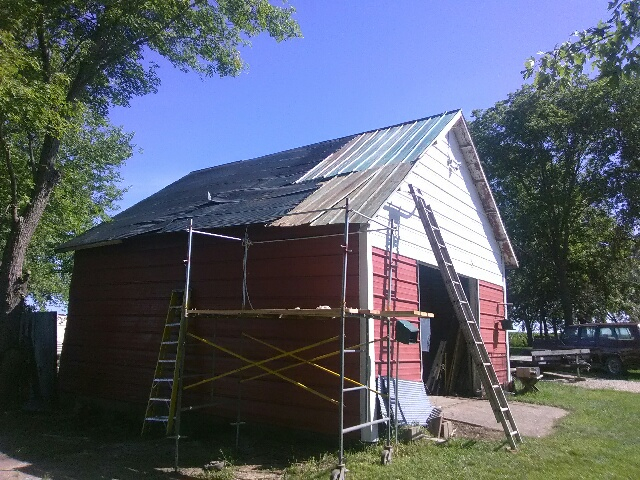

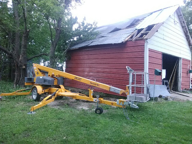

I have some scaffolds (Bil-Jak) but the upper pieces are very hard to assemble without extra help. As noted before, rent a boom/man lift. The drive to the rental place may seem far, but most also offer delivery. Kinda pricey. Self propelled are real nice, but may not be needed, depends on the terrain. You won't be sorry.
