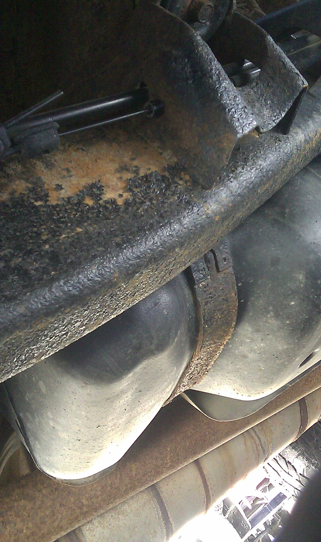

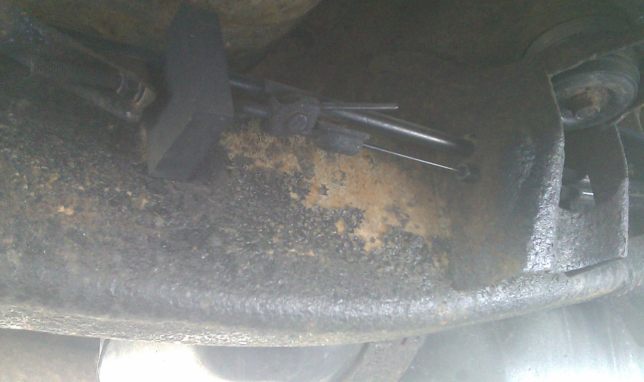

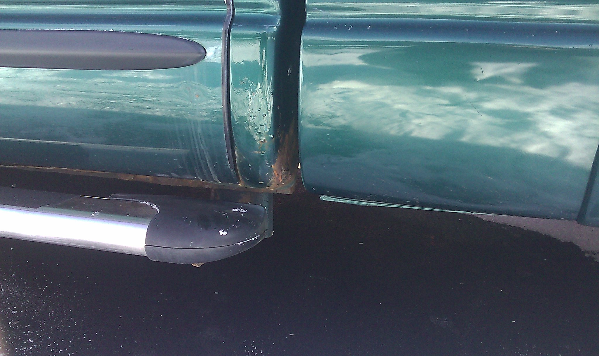

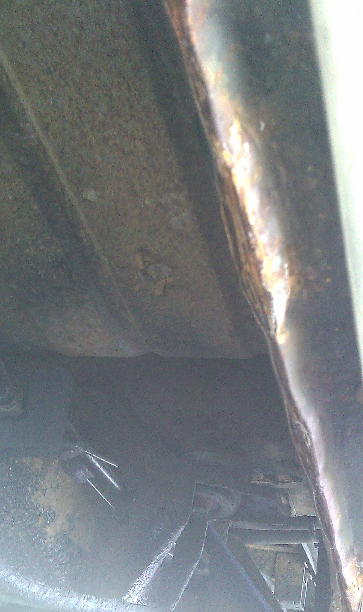

Dodge body? Have you seen how much Dodges rust? Here are the cab corners of a 2003 1500 4x4 with just over 100k miles that was last in PA (its for sale with a expired 2013 PA inspection sticker in the window):
Cab Corner rust.jpg Cab To Floor Seam.jpg Frame undercoating peeling and frame rust.jpg Frame undercoating peeling and frame rust2.jpg
View attachment 357841 View attachment 357842 View attachment 357843 View attachment 357844
Aaron Z
I can go snap pics of any make you want that's not as old as your 03 that have as bad or worse rust if you want me to. Not only Dodges rust. If you take care of them they last. I have a friend that has a 97 Dodge without one spec of rust on it.
You are also in NC, not hard to find rust free vehicles down there (its on my list of places to look for a newer truck in)...
We are looking at trucks because our '97 1500 (Reg Cab 8' bed) has lost three of the four wheel wells and the bottoms of the doors to rust. My wife's '02 Caravan has holes the size of softballs down both rocker panels.
By comparison, my '97 Volvo V90 (RWD wagon) doesn't have ANY rust on it despite living in NY or CT all of its life and the '93 940 wagon that it replaced had very little rust (less at 16 years old and 177k miles than the Caravan at 7 years old and 90k miles).

Yeah, I live in the rust belt and I haven't seen any make of truck, including the Japanese trucks that don't rust. Its just a fact of life if they salt the roads.
