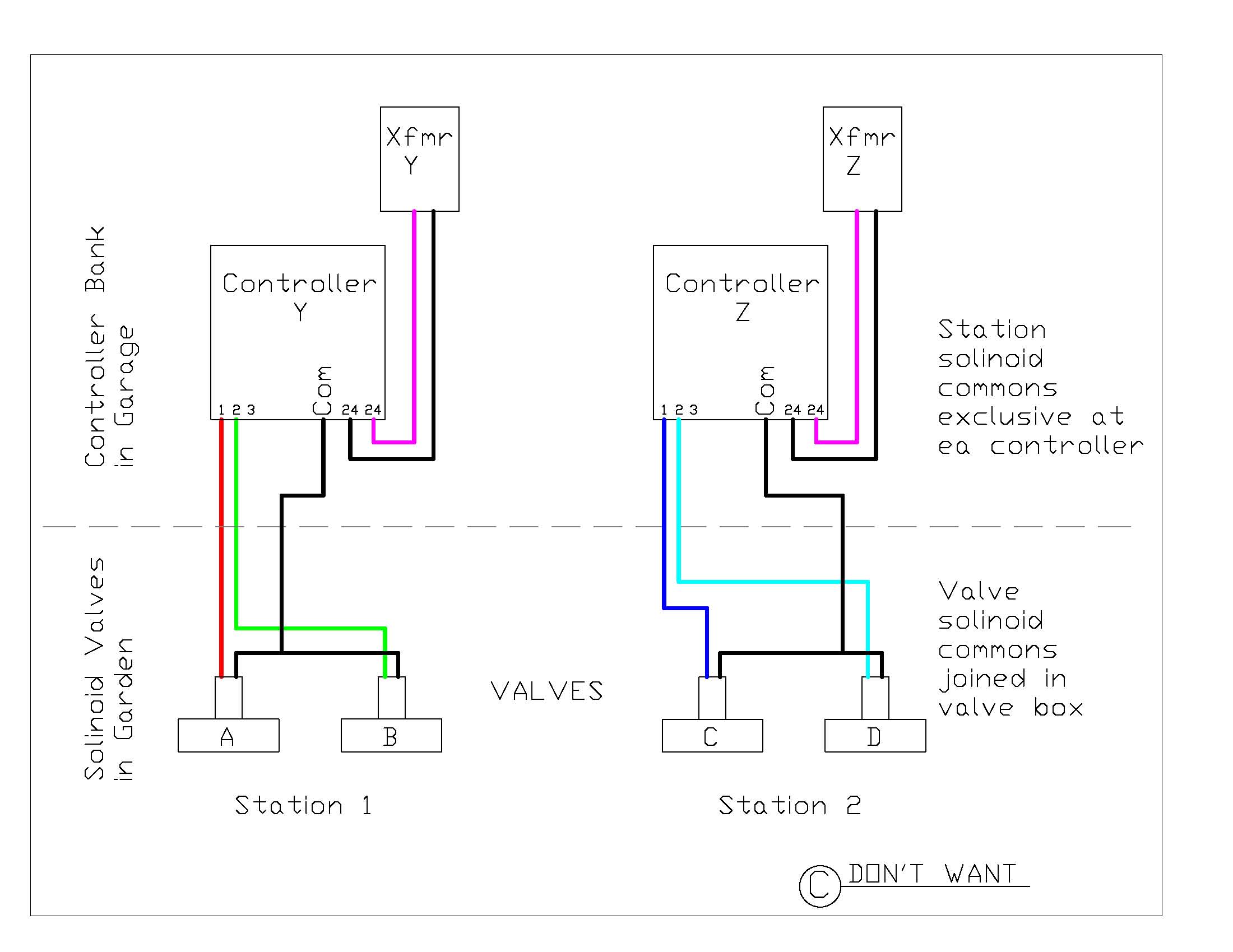

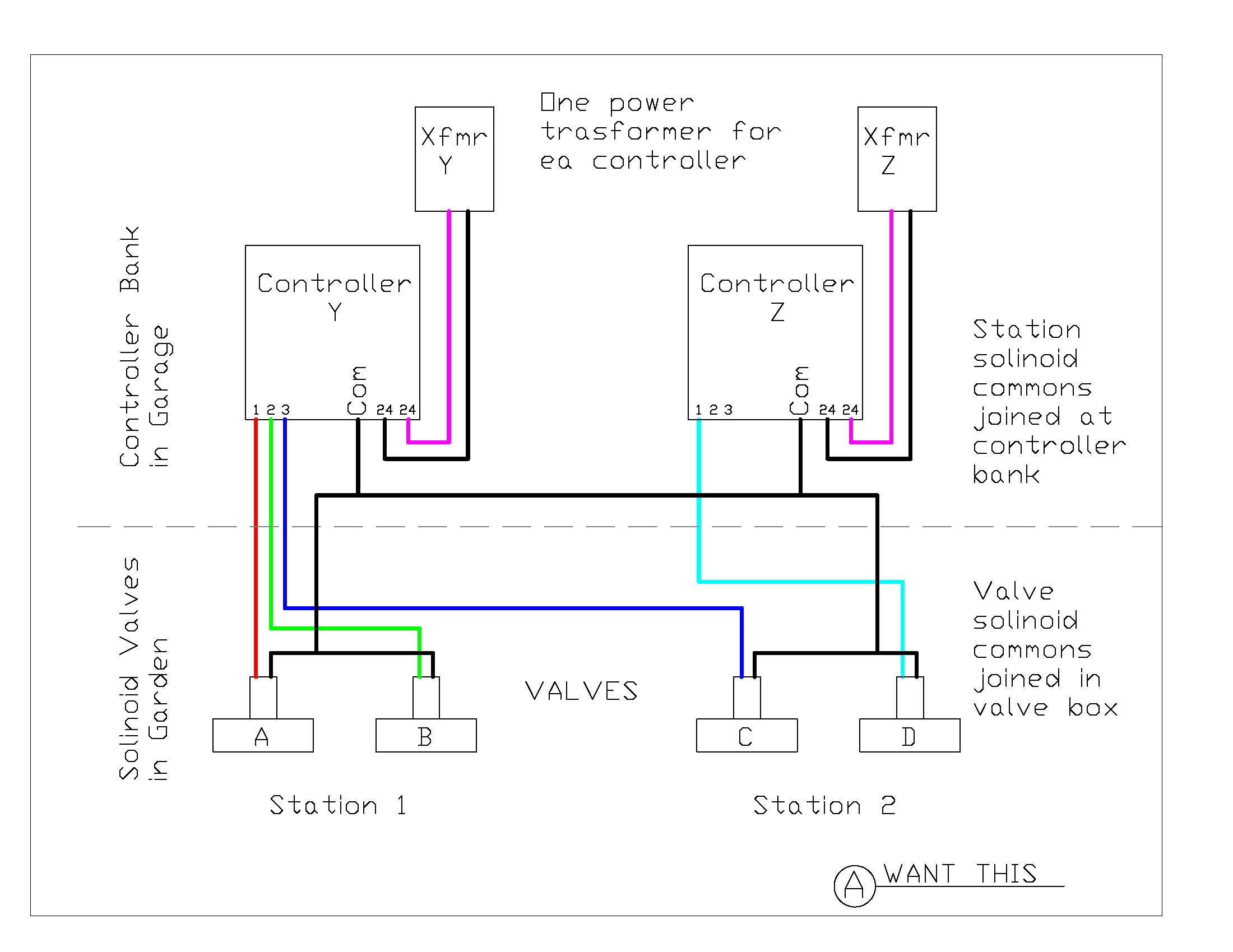

Thanks for all the input. I think I am getting the picture that the power transformer "common" and the solenoid commons are all one and the same. I was treating them as separate and different in my mind. Some sketches helped. To keep things simple consider I have two 3 station controllers and four valves at two different locations. So although I wanted to do this...(pdf is a better looking copy of the same sketch)
A-Want.jpg View attachment A-Want.pdf
(because I have the four transformers that were supplied with the controllers) you seem to be suggesting I do this...
B_Need.jpg View attachment B_Need.pdf
because a ground fault/problem of one of the individual transformers could "infect" the others (or the system).
What I don't want is this...
C_Don't Want.jpg View attachment C_Don't Want.pdf
because then I could not run two valves from one location from two different controllers and some controller spaces would go to waste. IE: If I had two more valves from yet another station, this wiring would have me running it to a separate controller and Y3 and Z3 would be lost.

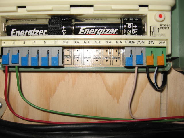

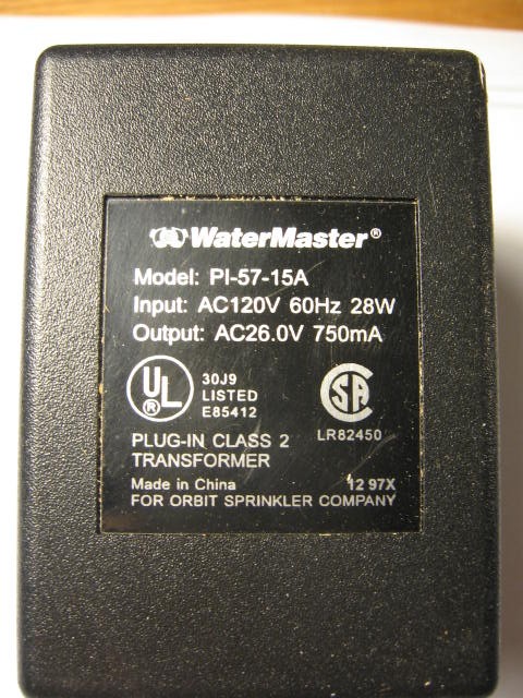

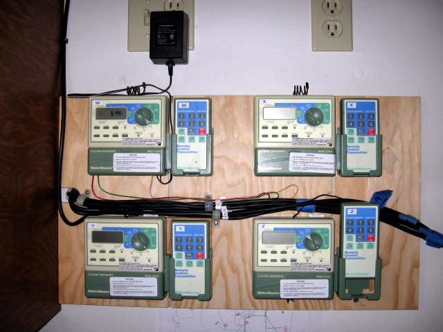

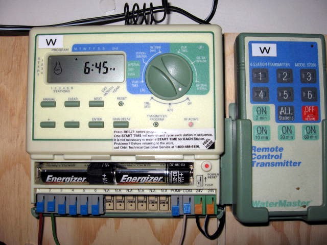

Here are some photos of the actual equipment. I only got two stations on line Sunday. The next three from two locations will also be connected this same controller. Then I have three at another box to connect and that's where the cross pollination would begin. To utilize the remaining 6th location on the first controller I want to join all the commons at the garage central control board.

So in your opinion is drawing 2 "Need This??" acceptable?
Would I use a 26VAC/3000mA transformer to power up all four controllers? Or, if I am careful to not program two controllers to operate at the same time, do I power them all from one of the 26vac/750mA transformers I have?
If the former above,running higher amps to each transformer has me concerned with overload protection. Should each transformer be then individually fused?
Is 3000mA the same as 3Amp?
Grainger has trans formers rated a V/A. What would be the V/A rating I would need to power the four controllers from a single transformer?

RedDirt,
I think someone has convinced you to make this much harder than it is. The common going to the solenoids has nothing to do with the power supply from the transformer. SoundGuy had a reasonable reservation re: tracing faults, but it would be fairly easy to disconnect the various controllers if you had a fault in one. You were on the right track when you started --- stay there.

jeffinsgf,
You keep giving me the answer I want to hear.:) At first I didn't think the power transformer and solenoid commons were directly related but replies got me thinking they must be. The valve solenoid needs its power from somewhere and the where seemed to be the hot and neutral of the incoming transformer wires.
So I'm good to go with the "A-Want" schematic in above post?
