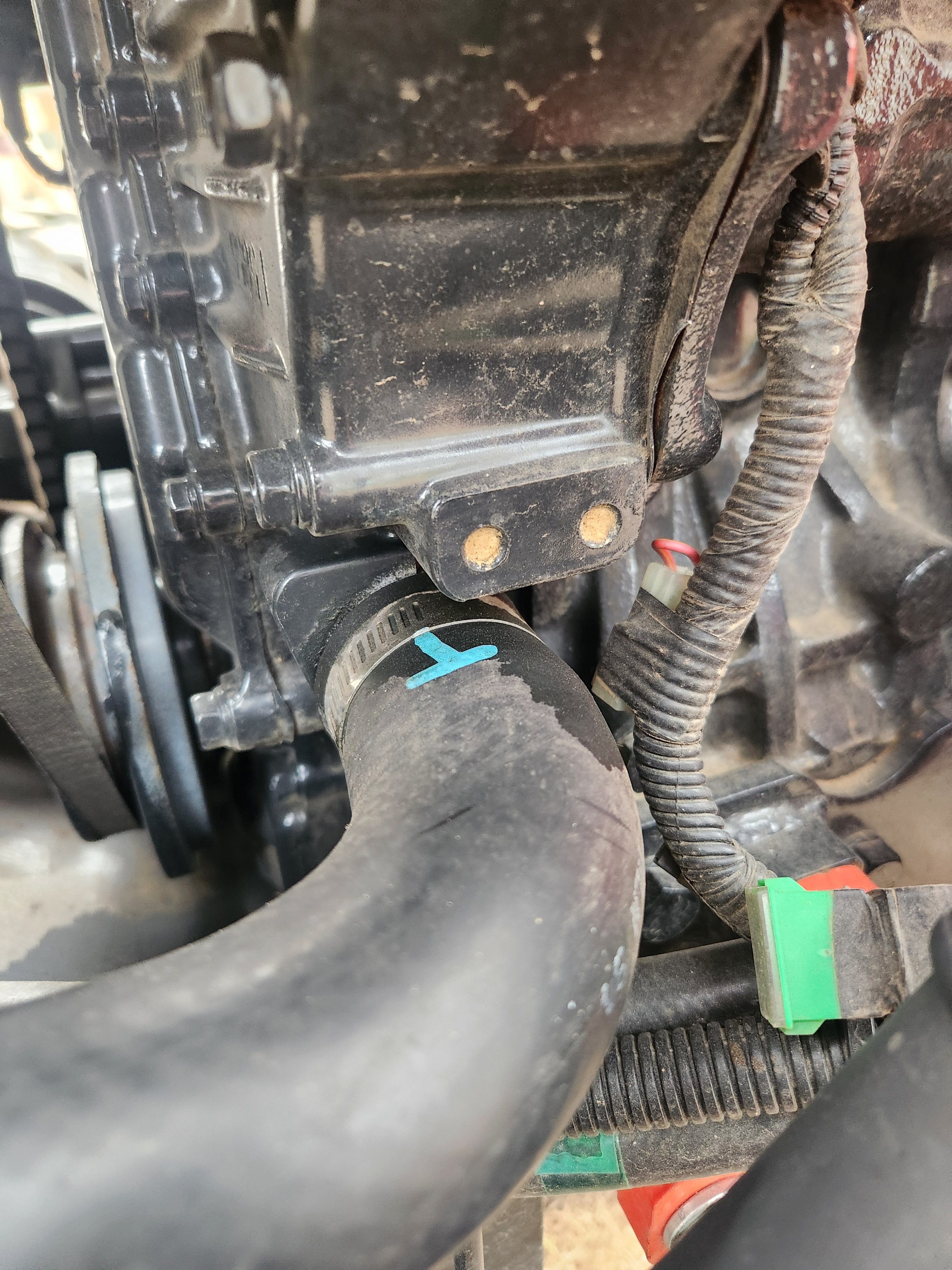

Well, the CK2610 is leaking some coolant, but it's being a bit of a drama queen about it. It's leaking coolant from a bottom hose, but it's not an active leak. Running, the tractor isn't producing a leak I can see, but at some point after parking it's like it dumps a little out.

Why in the world is it doing it so long after the machine is parked?
/ Interesting coolant leak. #4
Probably metal contracting or your clamp loosening after it cools off. Happens all the time. Tighten existing clamp, put on a new clamp, or a second clamp for inexpensive/simple starters.
/ Interesting coolant leak. #5
As HD said but it could also be the pressure rising a bit once you shut it off, heat soaking. Bet you'll find a bit of growth of crystals from the anti freeze between the hose and the fitting also.
I get out early on Wednesday, so I'll have some daylight to tighten everything up. If it does it again I'll try adding another clamp.
Thank you folks. 🍻

you may want to wiggle the fan blade when engine is cool while looking at the shaft of the water pump & the weep hole and see if the leak is coming from there. Im pretty sure if it was the hose it would leak while running and not just when engine is off. theres pressure on the hose after running for a while the leaks can look like they come from a area when their not.
#11
I'll give that a good look as well. Not something I would have considered.

I had the same cold-only leak going with my CK2620.
Did what Hay Dude suggested earlier and added a second clamp. Done.
Picked up another hose clamp on the way home from work. Better to just tighten the old one and add a second, overkill seems like a plan here.
/ Interesting coolant leak. #17
Being the lower hose, it's suction and at negative pressure to atmosphere so it wouldn't leak under power. Chances are it's a small rust or, as mentioned above, crystals from the coolant that allows a small bit of seepage. A second clamp may solve it depending on where it originates from; if not it will have to come off and be cleaned with a wire brush and the inside of the hose cleaned as well. A small bit of white grease will keep it from reoccurring.
If you don't want to take the hose off, you might be able to loosen the clamp and twist the hose a bit back and forth to break up the channel that's allowing the seepage, but that could make it worse as well.
#18
Tightened the existing hose clamp down and added a second. We will see if it's fixed tomorrow when I run the tractor.
#19
So far so good, we will see after it sits! Leaks drive me nuts, absolutely nuts. This was small enough I could have "lived with it;" but eventually that must turn to something worse. Or, worse yet, I neglect topping it off and eventually there isn't enough coolant in there.
