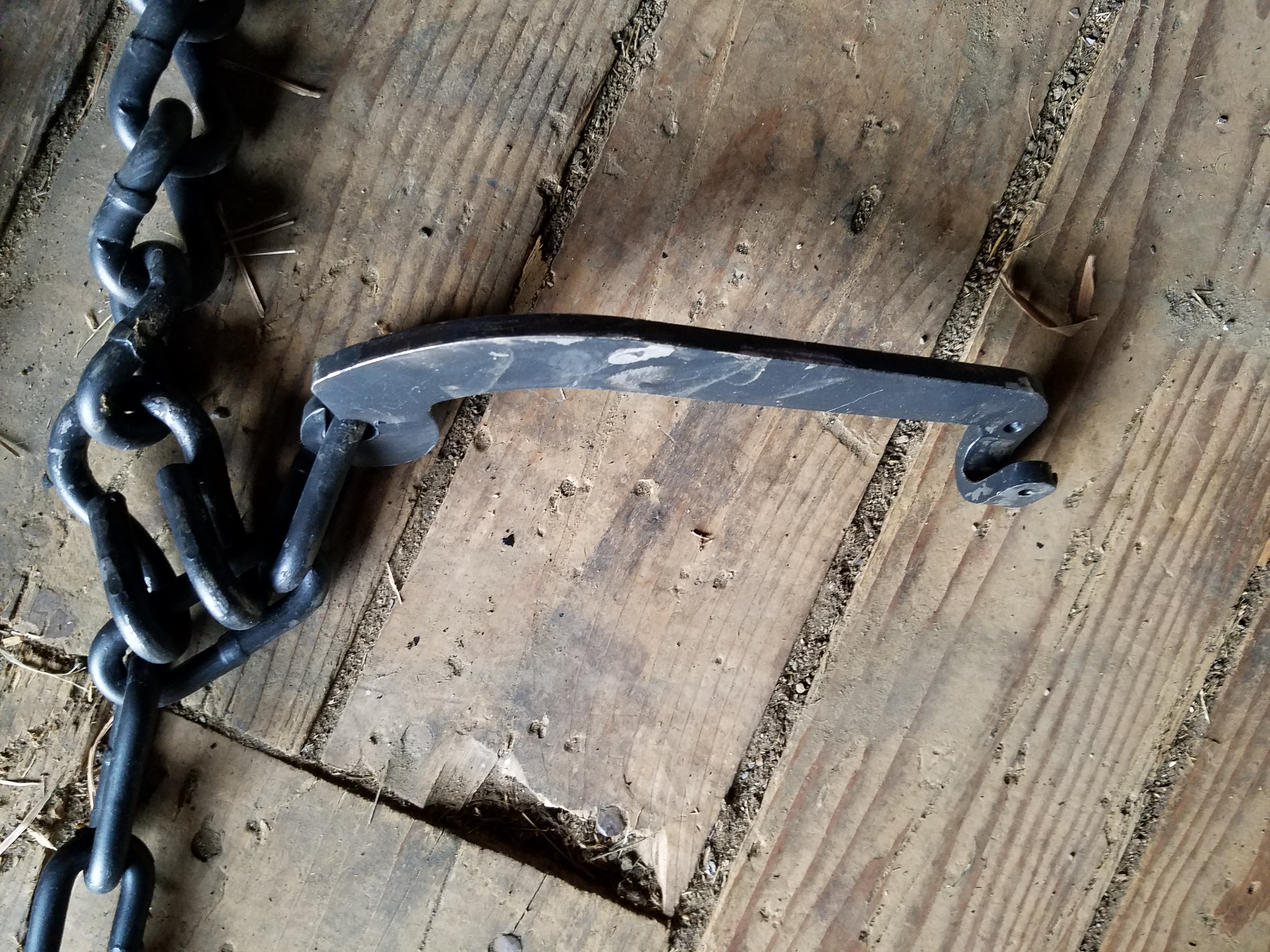

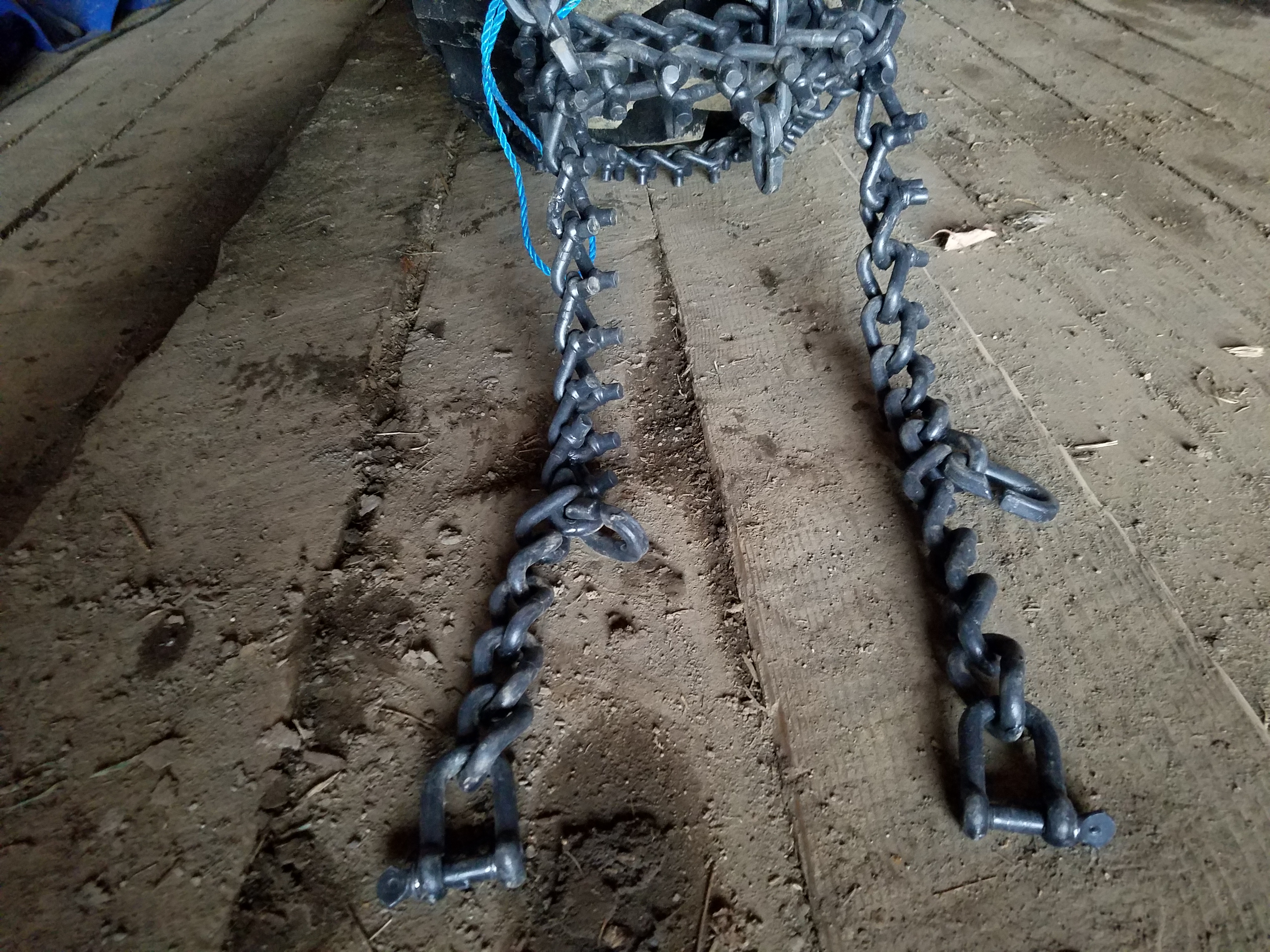

I recently bought my OFA chains for my Kioti RX7320PC farm tractor and am installing them. I am not experienced with installing chains on anything and although I have viewed the instructions and videos, I have the following questions.
What are the two holes on the end of the side easterners for? A cotter pin? ?
Once the two ends meet when installed on the tractor, I have about 22 left on each side. What do I do with the extra length?

I have the same chains. The two holes are for a safety wire which will prevent the hook from coming undone. Stick a short piece of fence wire thru, wrap it back and twist the two ends together. When you have the chains fully mounted the way you want them or are sure about how they will mount and fit cut the excess chain off with an angle grinder and thin cut off disc. On new chains I usually leave some extra links on the side chains for future adjustments if needed. After I run them a while I cut the extra off.
I ran mine w/o safety wires for two years and they stayed on fine but last year I did lose two shackles which also have safety wire holes. Now I safety wire everything.

I never thought to go back to Reed's. I went the hardware store and McMaster-Carr root and couldn't find any long narrow ones like you said. Finally found some on a sail boat rigging supplier site and ordered them. In the mean time I had to use the tractor so bought some standard cross chain hooks. After putting them on I didn't see why I needed shackles any more. It seemed to me that the shackles were just for the initial adjustment in case you had to move the last couple cross chains. I bent over the hooks and made them permanent and they match the rest of the chain. So I have a couple spare expensive stainless steel long skinny shackles.
