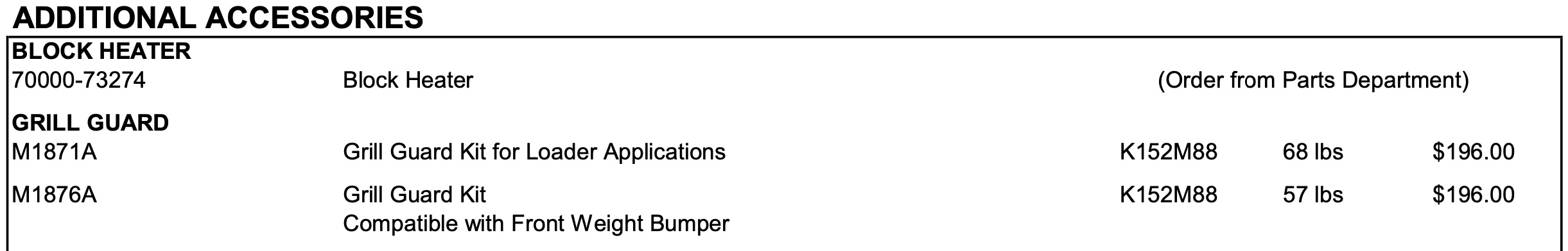

Dave, attached below is a pages from a Kubota M series whole goods from 2018 to give you an idea of cost, but check with dealers sales dept. for current prices. It shows 2018 prices for the LA1154 and what all you need for it. If you want to order it from your Kubota dealer you order wholegoods through the sales dept. not the parts dept.

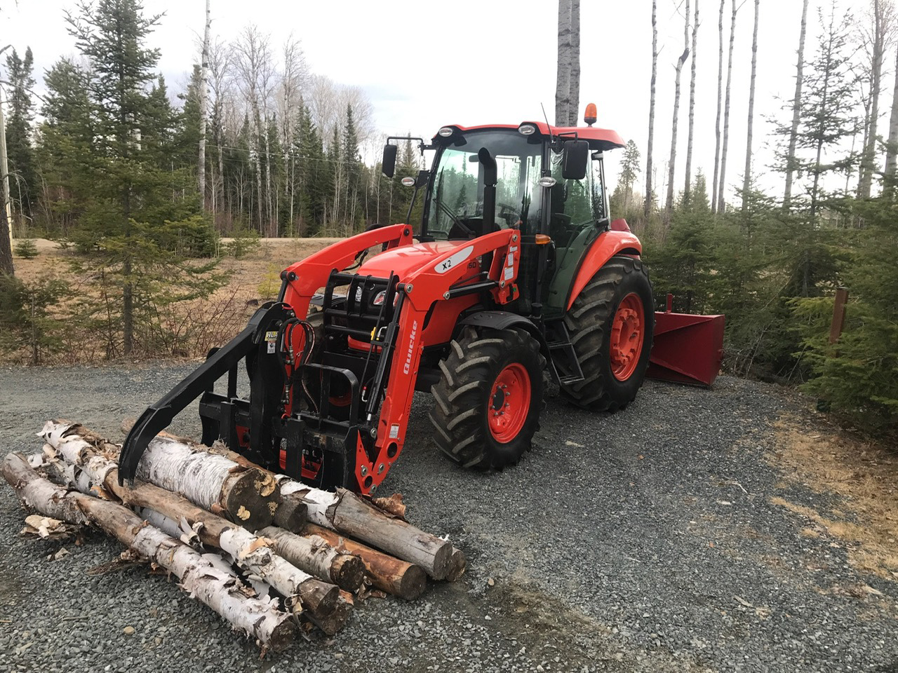

E07DE082-CE85-4B15-BD10-095BAE6C0A0A.jpegWhen I bought my used M7060 it did not have a loader installed. The selling dealer (not a Kubota dealer) installed a Quicke X2 loader. I believe the cost (in talking to the salesman) was around $8000 (cdn). I added a 3rd function and a soft ride (an extra $1500 I think)
They included the loader cost in the selling price so I was never really sure what it would have cost off the street.
I thought I read somewhere that ALO/Quicke built Kubota痴 loaders, maybe it was the Canadian M series of loader (M21, M26 on this size machine).
