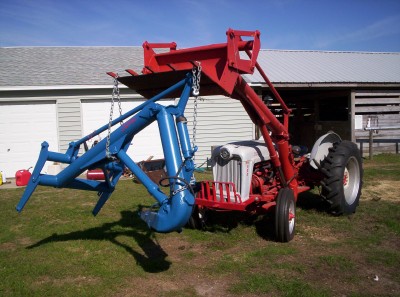

I will say one thing.. having a second loader tractor around to help you makes it a whole lot easier.
Here's a pic of my 55 ford 660 with a ford 722 1-arm loader lifting the loader frame of a ford 711 1-arm loader, that I installed onmy ford 850. ( near identical tractors and laoders...

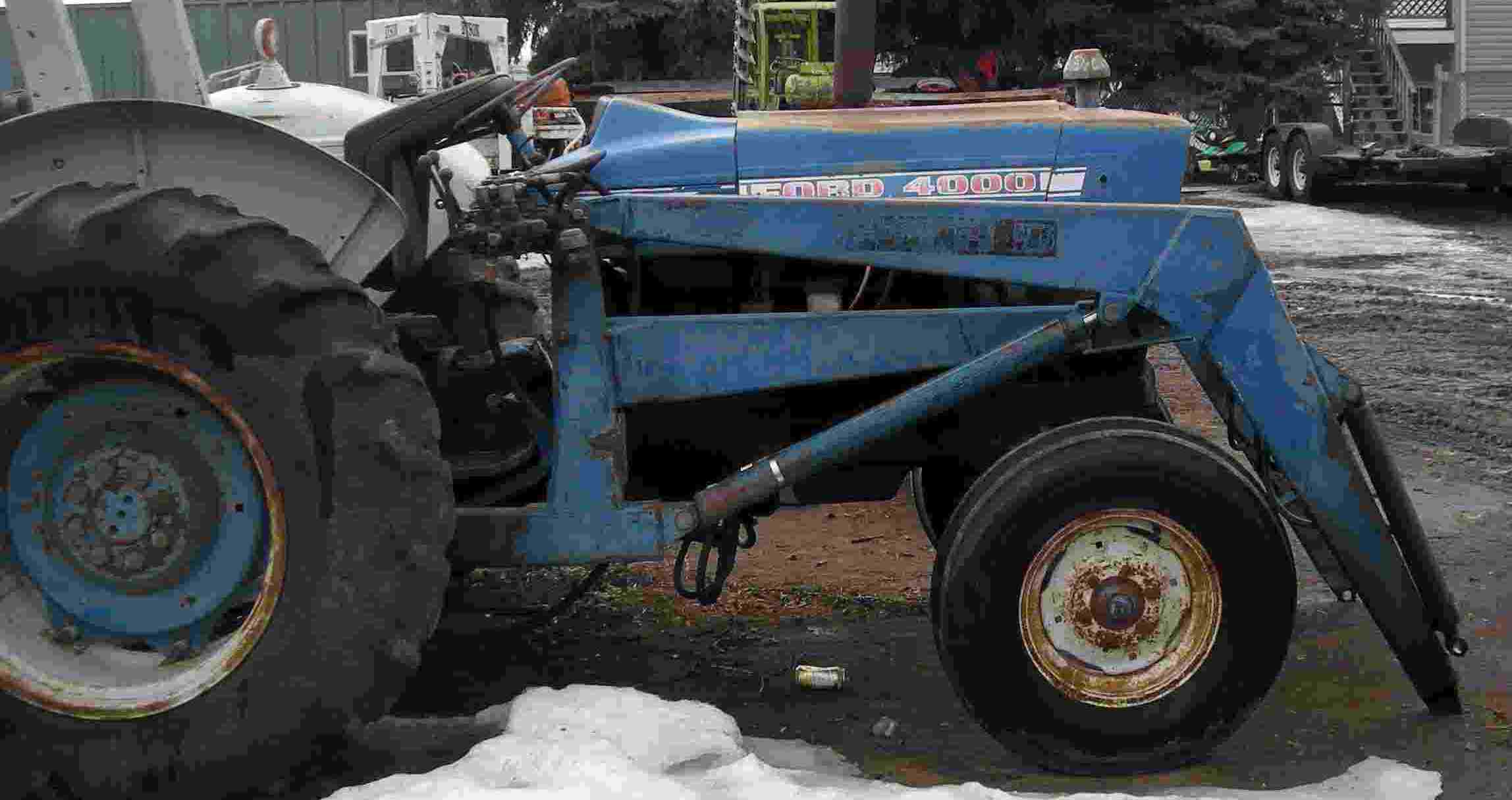

Installing a loader should not be too hard, you will need to be carefull and will need something like a engine hoist.
I just purchased a 772 for my ford 4000. The loader weights 800#.
We dismounted the loader off of the ford desiel 4000(first picture) and I am mounting it on my gas ford 4000.The second picture.
I do have a heavy duty engine hoist to move the loader around which will be a big help.
