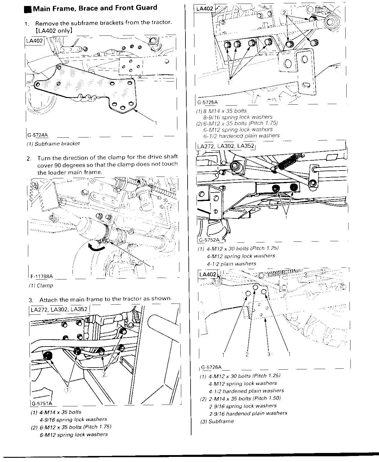

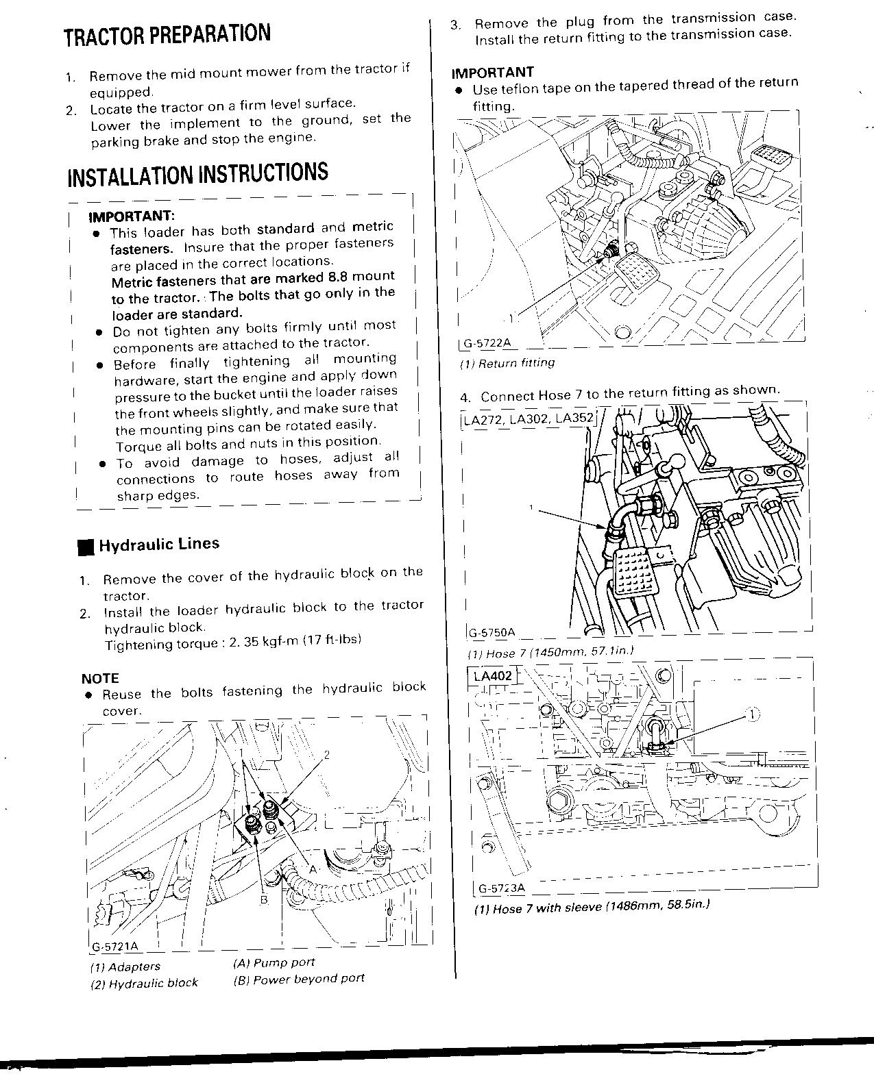

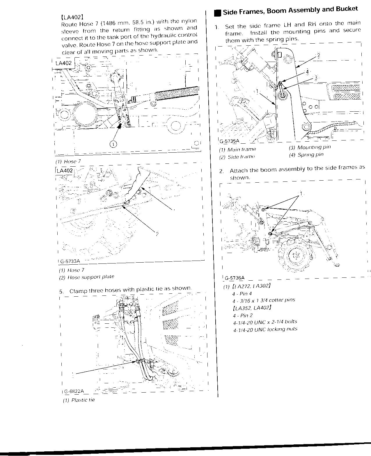

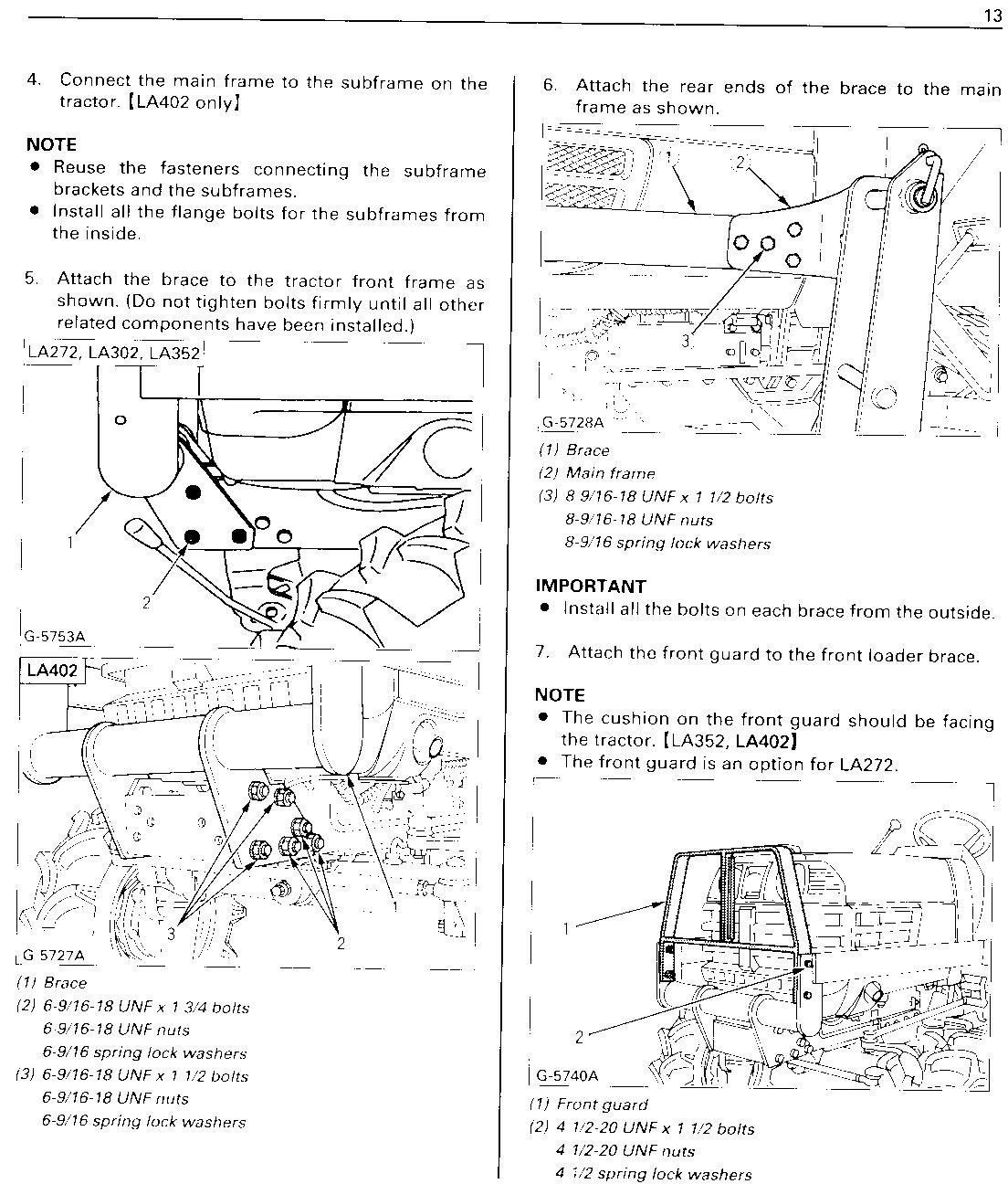

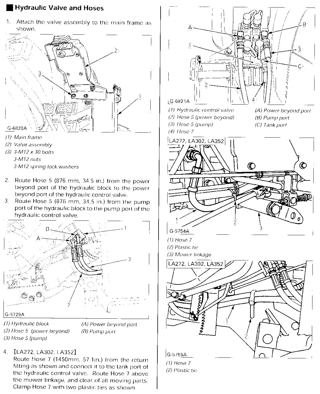

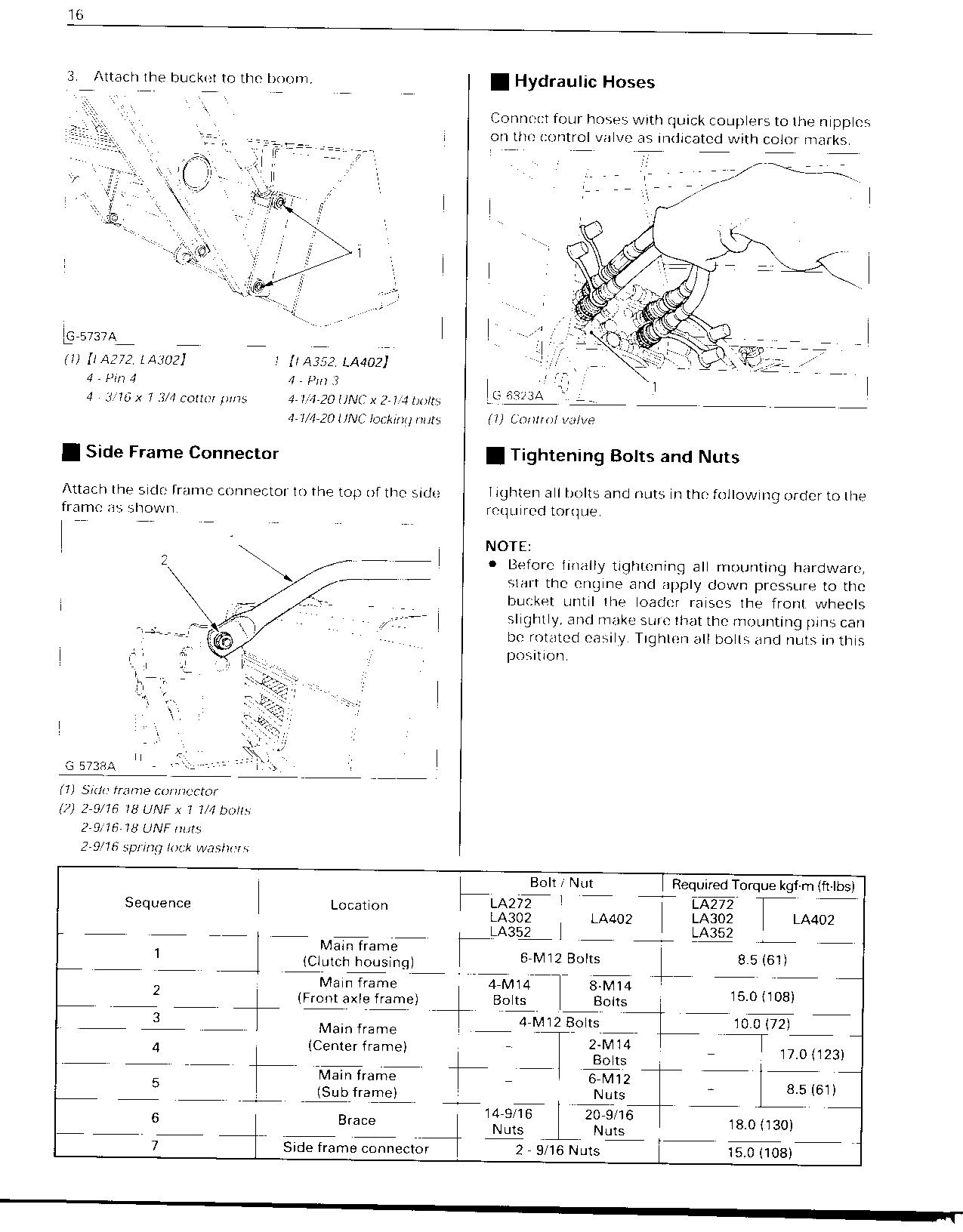

The loader that I purchased from Ohio is on the way and should arrive on Tuesday. I have a couple of pre-installation planning questions just to ensure that I minimize any first time mistakes. Since the owners manual is in the shipment, I don't have anything to go by except for a few pics and gut feel.
If you have a B2800, B2710, B2910, do you think that the hydraulic hoses needed to be connected to the tractor as step 1? Based on the locations for the hyd. prort and the return line, it would appear that I should do this before I install the main support bracket. As you know, space is limited near the hyd. port and the connection point for the return line.
If you happend to have a LA402 Owners manual, I am just wondering if s
it states what should be done first.
Thanks
/ Install a Loader on B2910 #11
allenp....My B7800 came with the LA402 already installed. I just looked at the manual and the very first thing to do is indeed the tractor hydraulic lines. Attached is a scan of the installation section of the manual (6 pages).
Good luck with the install.

Thanks Herringchoker! The pages you sent make it clear, and will save me some time once the shipmnet arrives.
