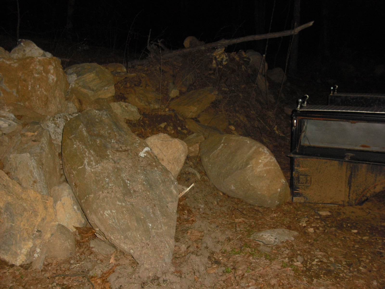

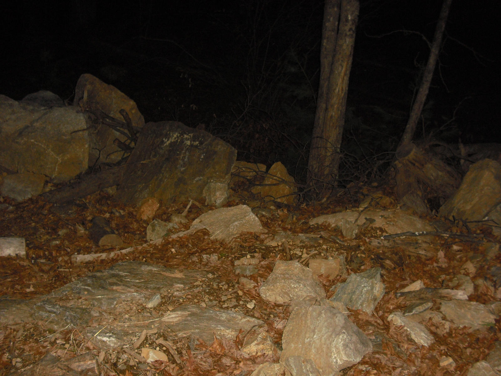

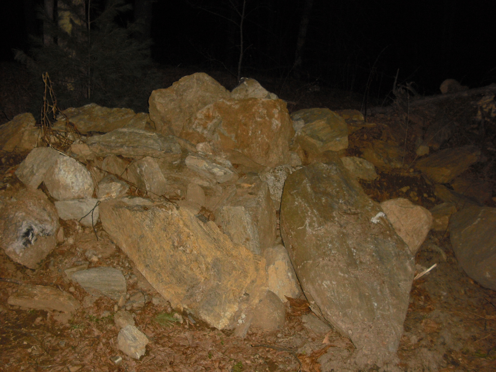

Rocks, Rocky, rough, rocks, ok, here's a small sampling of some rocks I've dug up. I literally can not dig more than 3 feet in any direction without hitting one of these puppies.
Sounds like my New Hampshire yard. Hilly, Rocky, and full of roots... :cool:
No problem tearing into that hill with my little CK20...
