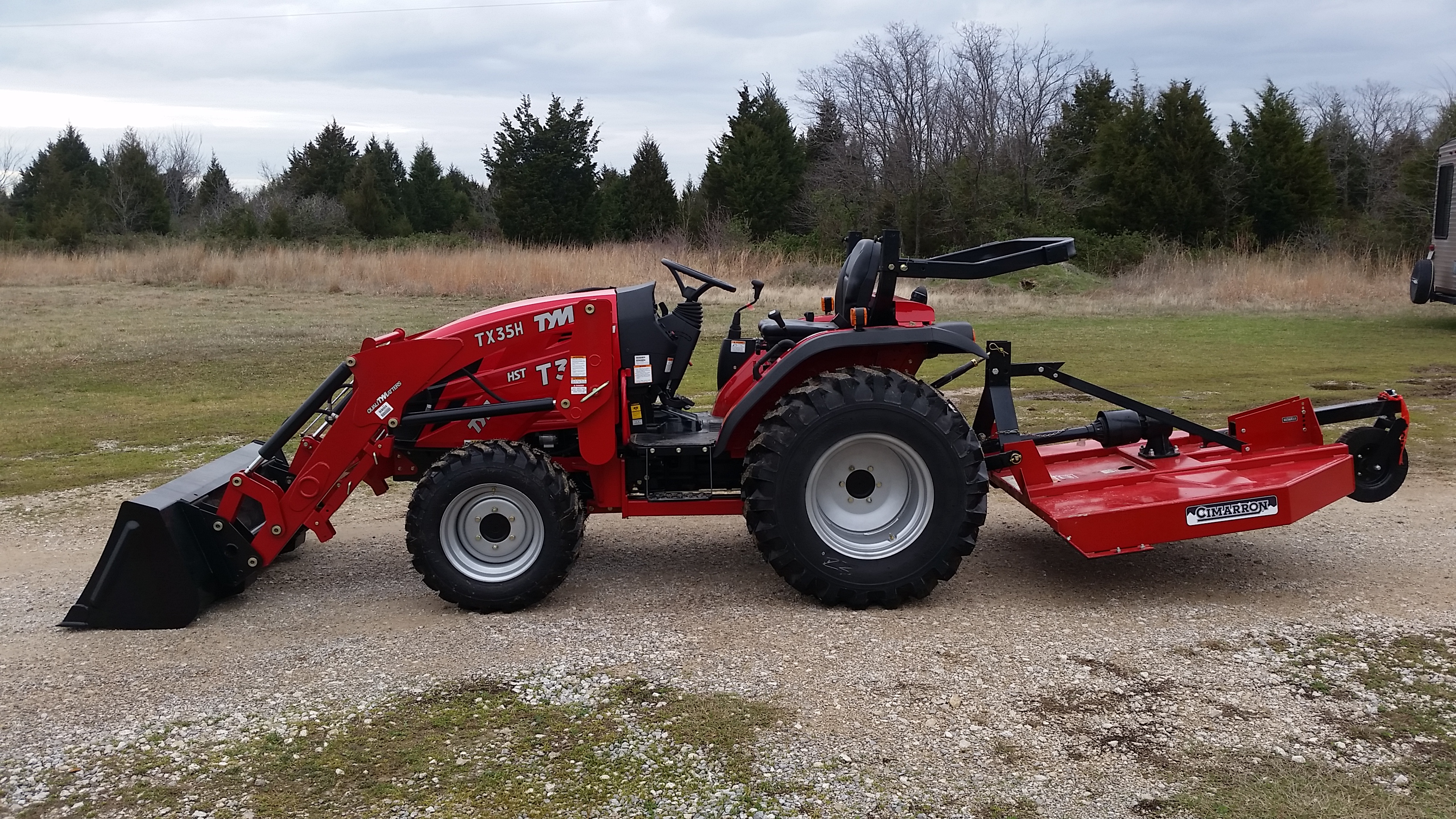

Hi guys, new member here. I recently bought a TYM T354 HST and I think I can backup the claims that this Mahindra tractor is built by TYM. My 354 looks nearly identical to the mahindra. Matter of fact, the only differences I can tell are the trim (fenders and hood) are slightly different and the motors are different. The TYM has a 35hp Yanmar diesel but does come standard with cruise control.
I haven't checked prices on the Mahindra but I paid $19,495 for the TYM tractor and FEL.

Welcome Cranedaddy!:welcome:
I think the pricing sounds similar +/-. I'd be very interested in seeing some pictures of your TYM machine if you wouldn't mind sharing here...? I have only ever seen them on the TYM website and those pictures are not great. I think getting info out on the availability and reliability of this established tractor will be beneficial to a lot of folks. Also might help a few people who are looking at the Cabela's blowout sales right now which are also TYM chassis. Most of the frame and chassis parts are surely interchangeable between the TYM/Mahindra/Cabelas tractors in this series. The foundation seems to be built like a tank and as long as great engines are paired up, and they have strong hydraulic systems, I think you have an unbeatable combination. Thanks for sharing!

Np here's a few pics. It's sitting out in the garage so I can take pictures of specific parts if need be.

And by the way Cranedaddy, you are right, that TYM T354 HST is clearly built off of the same chassis. Some of the small details are different, but all in all they are extremely similar. Yours has adjustable stops on the three point hitch height adjustment! Mine doesn't have that, grrrrrr...I'm going to have to contact a TYM dealer and see if he can order me a set of those. Thanks for the good pics.
Nice machine Cranedaddy. :thumbsup: Thanks for sharing the comparison pictures. I see a whole bunch of the same with only a few differences on the control setups, and of course the loader and engines which Mahindra has sourced internally for the 2538. You also have the standard suspension seat which is nice. Some of us have had it upgraded, and it does come standard on the 2540 which is the shuttle version of the Mahindra machine. Probably some hydraulic system differences as well, but that might be about it.
They are tough tractors with a lot of capability built into a medium CUT frame. The immediate Houston area seems to be in a dead zone for TYM dealers. I was wanting to go look at them in person before jumping into this current unit, but it definitely all worked out. Thanks again for your input!
